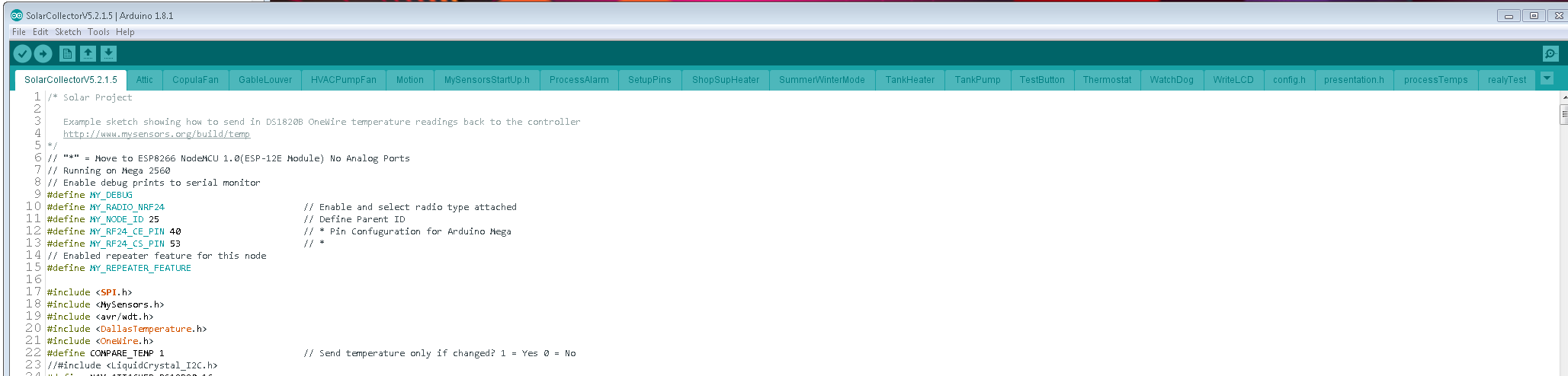

  • Gohan thanks for the link https://www.mysensors.org/download/sensor_api_20. I’ve been on that page many times so not sure how I missed it. That said and the fact I'm not a programmer some working examples for each would be most useful. I wrote tons of 8080 assembly code back in the day but my only official programming class was Fortran (you know the before time). C++ has not been an easy language to learn.
    I’ve been looking for a replacement to the Arduino IDE for the past year. Every time I install one the steep learning curve keeps me from getting work done so I end up back where I started. I had much better tools back in the 70's working in assembly. At well over 1000 line of code and 21 tabs in just my Mega sketch I can use all the help I can get.
    To be honest I’m about to give up on the whole Arduino thing so this project may be my last using this old 8 bit technology. Will Visual Studio Community Edition work with the newer micro controllers and maybe Python? Only my 5th or 6th programing language I'll have to learn.
    Thanks again for the help. I’ll try and figure out why the getInt() isn’t working for me.

    Visual studio can be extended with plug-ins like many others IDE. You need to take your time and find the IDE that suits you the best. I like Visual Studio because I used it for a few years and I'm used to it, but there may be some other solutions that work better with the projects you want to develop. I know the new IDE have tons of functionalities and I still haven't looked at the new ones, mostly because of lack of time.
  • @gohan +1 on vs+vsmicro.
    I'm a be developer from is first version and I could only seriously start programming in Arduino when I found the plug-in.
    Last week, also stumped into other free ide that reuses the vs distributable, while trying to get mysbootloader to compile. It seems a nice stand alone solution. I can't remember is name but I think visual micro comes from it.
  • @mfalkvidd Look in the ide for language inspection errors.
    Sometimes while crawling the sources vs decides you have some invalid code files or dependencies, then it changes the file types to avoid live dependency resolution loop.
    Then you loose auto completion, error detection, navigation, etc.
    Specially if you use resharper plug-in.
    Libraries like mysensors confuses the ide.
