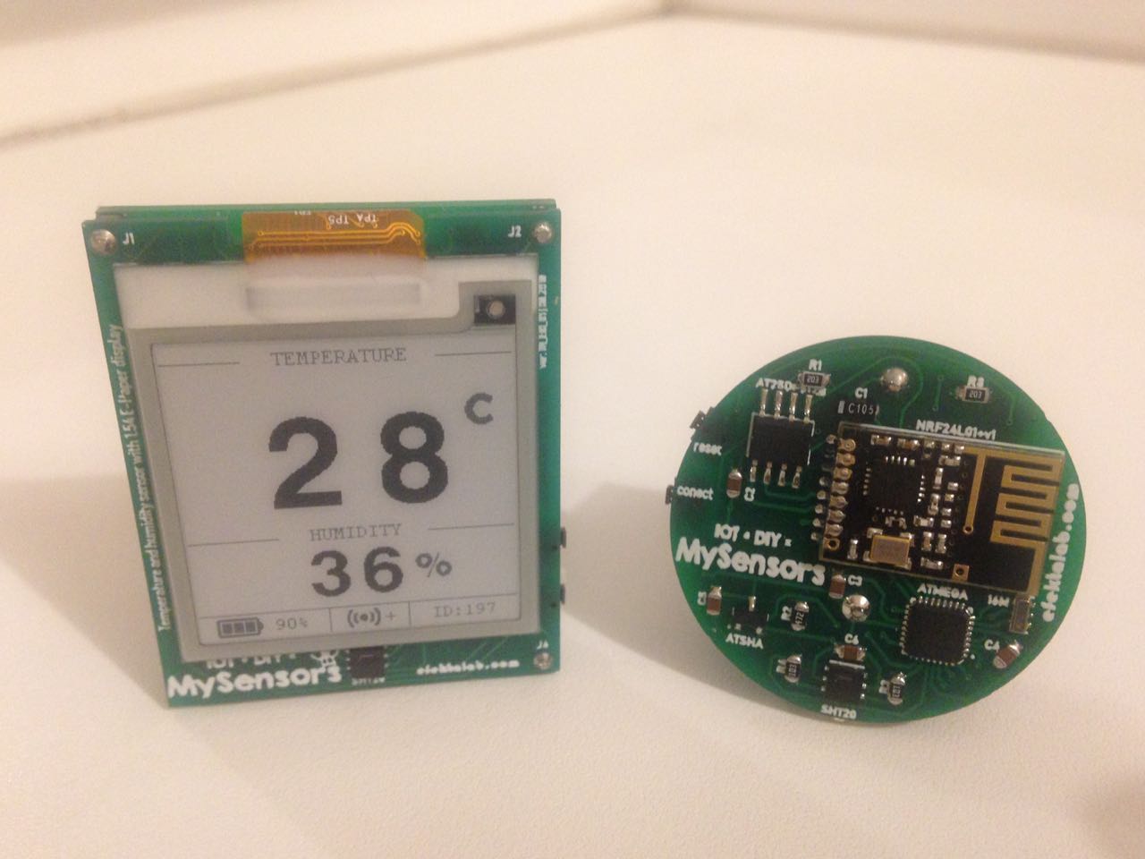

    Here's how the test program works now:
    https://www.youtube.com/watch?v=KnYcGmJcVtU&feature=youtu.be
    That in the most immediate plans:
    Add a screen restart once a day or perhaps after a number of readings updates.
    Add logos at the beginning of the download)).
    To use flash memory.
    ...And I hope that maybe someone will like this project, and he will try to write his own version of the program...

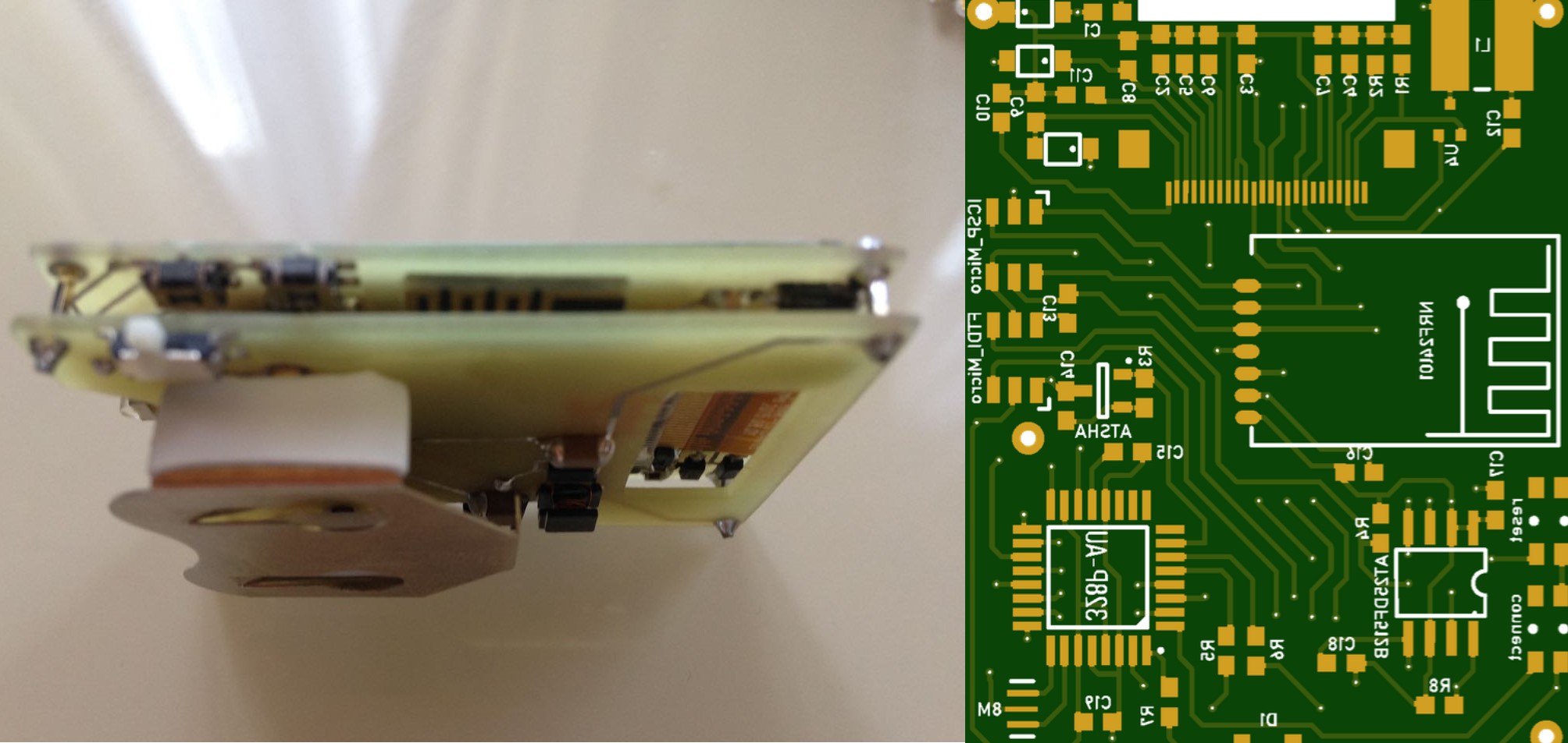

      Just made improvements on the Board:

        ..another photo with temperature sensors :)
