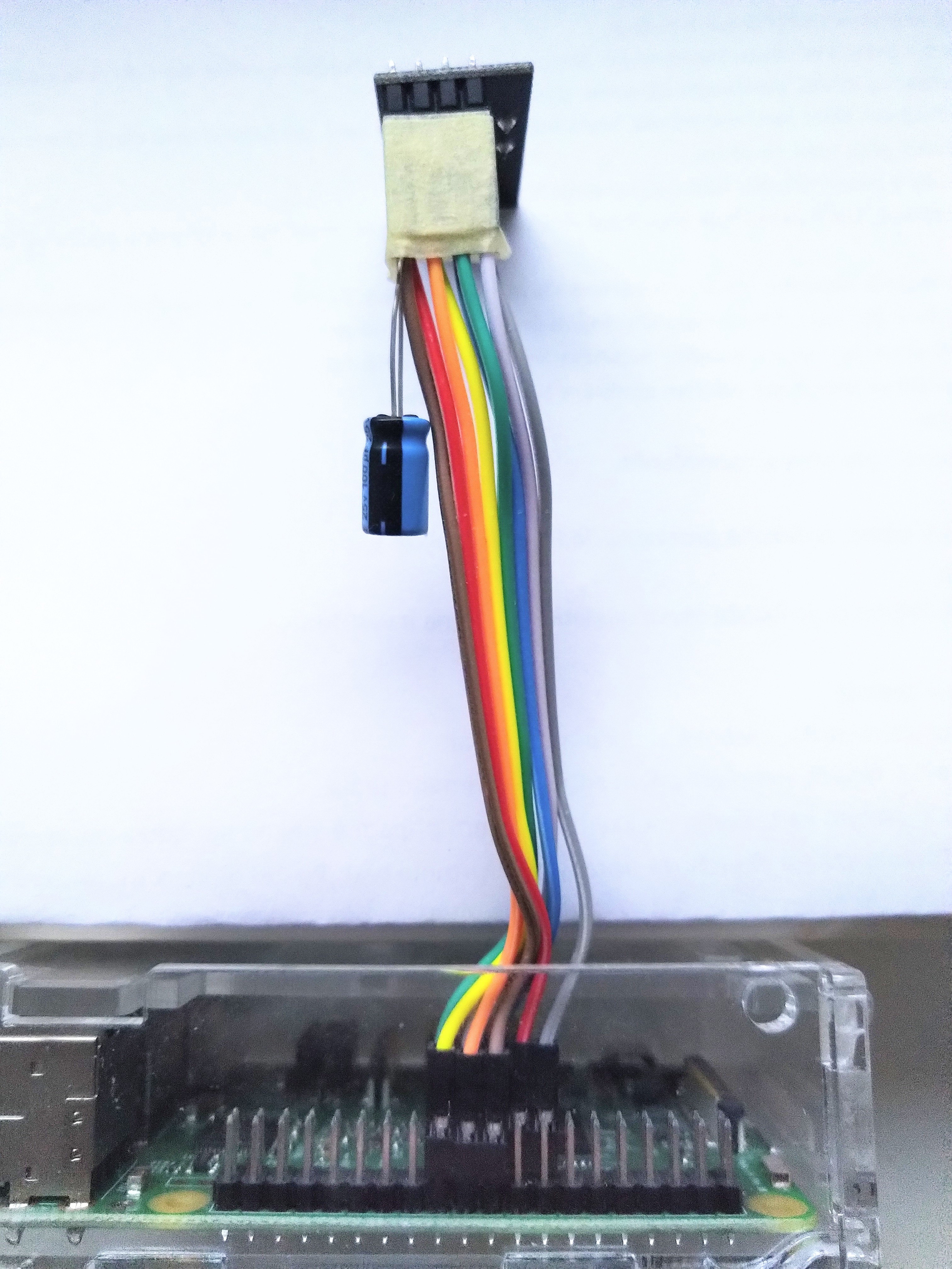

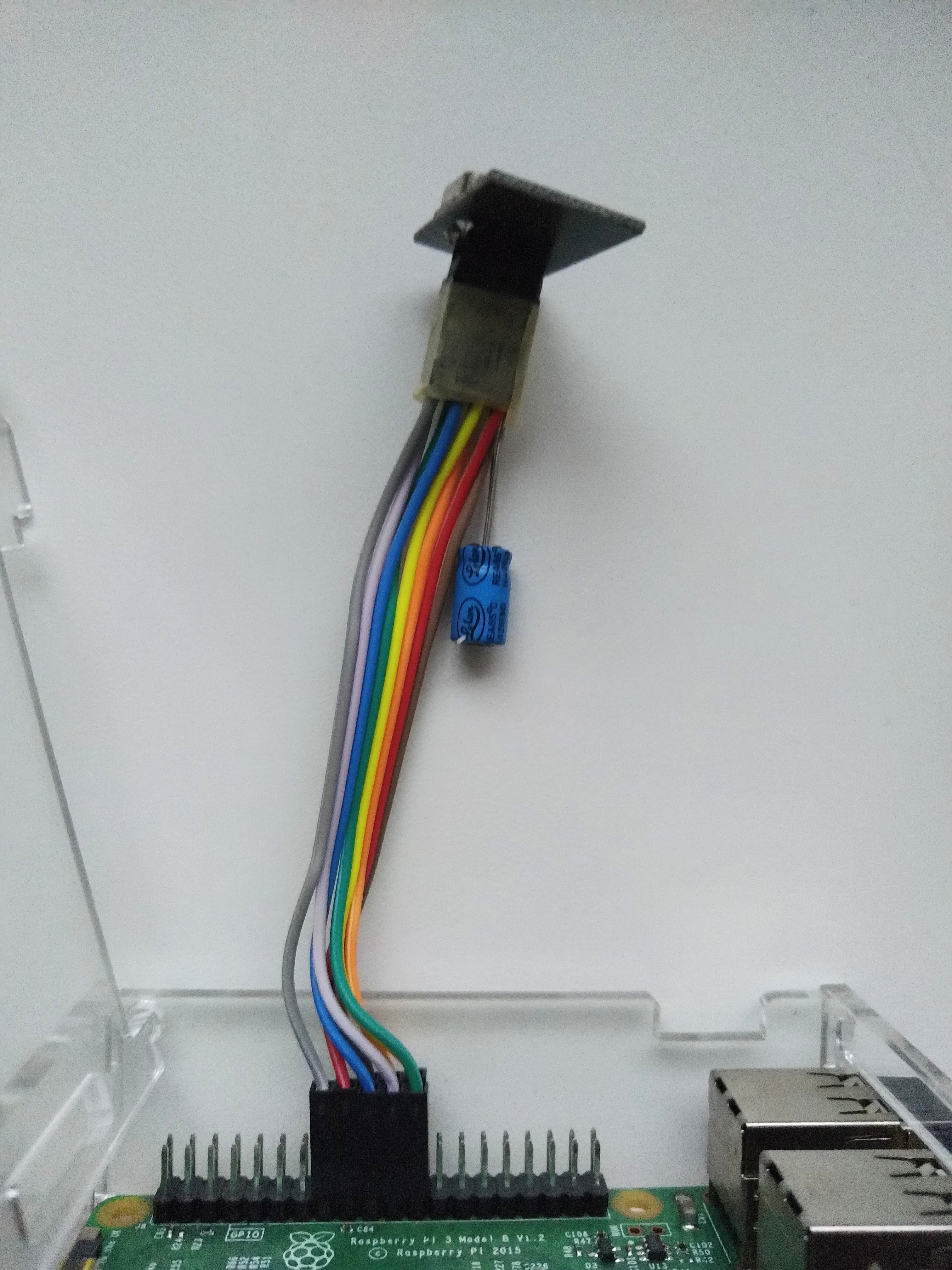

      @xanda could you post photos of the wiring? Maybe we can spot something.

          @mfalkvidd 0_1546330440084_IMG_20190101_084305.jpg 0_1546331110995_IMG_20190101_084343.jpg

                @xanda wiring looks good to me.
