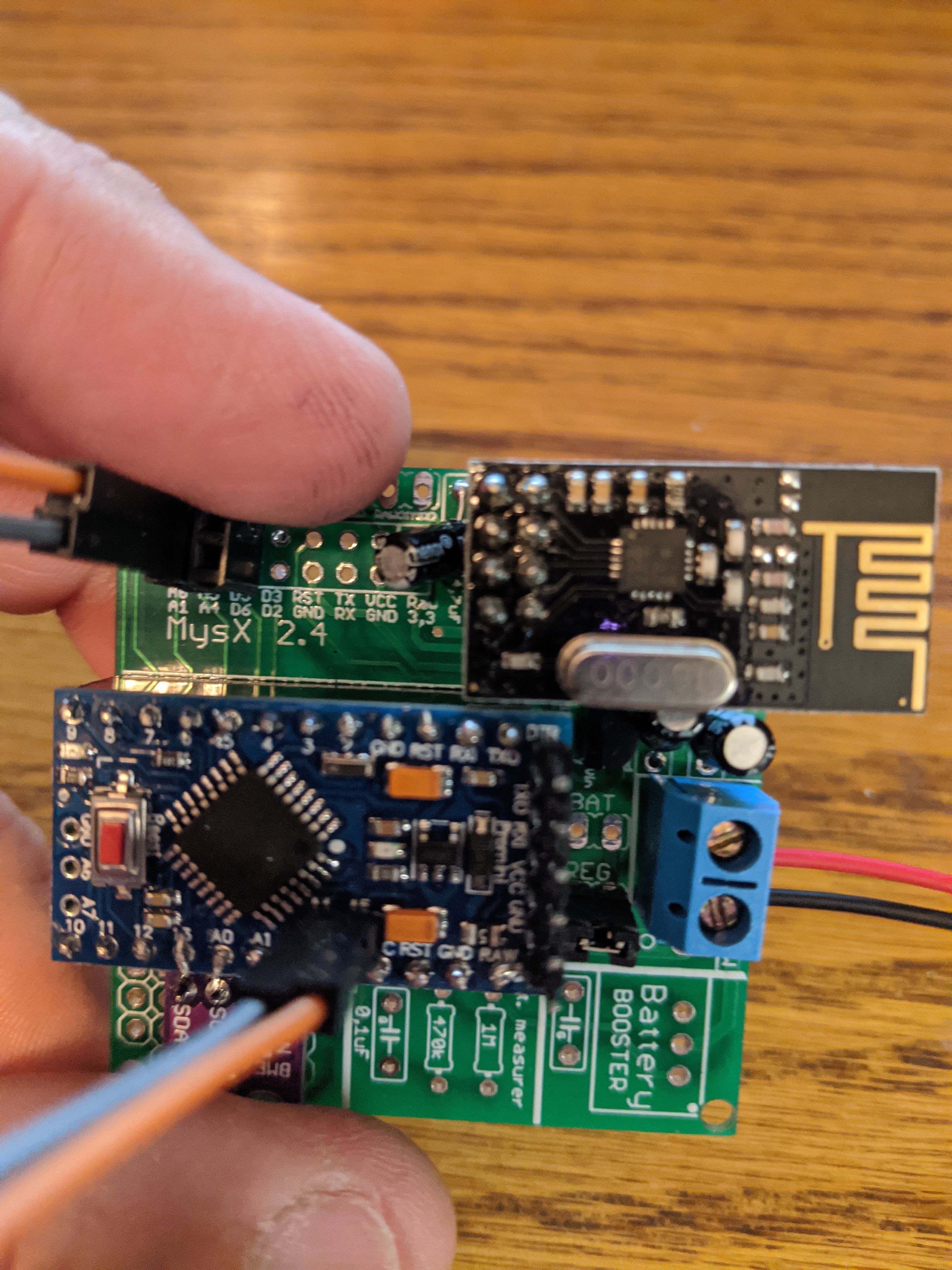

    mhkid
    I have a node that's sending a find parent request to the gw. The gw receives it and sends back a reply. The node never receives the reply and says parent not found. Any suggestions or help on how to fix/troubleshoot would be appreciated.

      @mhkid what radio are you using? How do the radios get their power?
      What capacitors?
      If you haven't seen it already, https://forum.mysensors.org/topic/666/read-this-first-it-could-save-you-a-lot-of-time/ has a troubleshooting guide.

        mhkid
        @mfalkvidd nrf24, 4.7uf, and it's powered at 3.3v, I put a meter on it. I'm using the MySensors board by sunberg.
        I'll take a look at the guide, thanks.

          @mhkid the sundberg board for the gateway as well?

            mhkid
            @mfalkvidd no just the sensor

              @mhkid for the gateway:
              How does the radio get its power?
              What capacitors?
              Are you using a normal nrf24 or the variant with PA?
              M 1 Reply Last reply

                mhkid
                @mfalkvidd Radio is getting 3.3v volts powered from a usb plug in. The capacitor on the radio is a 4.7uf. Here is a picture if this helps.!IMG_20200608_111955.jpg

                  @mhkid that looks like the easypcb by sundberg. Is it? I thought you said you used something else for the gateway?

                    mhkid
                    @mfalkvidd It is. That's not a gw it's a sensor node. My problem isn't with the gw it's with the node. The gw receives the find parent message and responds. The node fails and says there is no response (see my original post)

                      @mhkid the most likely reason that the node doesn't see the gateway's response is that the power supply to the radio on the gateway is insufficient.

                        zboblamontZ
                        zboblamontZ
                        zboblamont
                        @mhkid If the suggestion by @mfalkvidd doesn't resolve the problem you might look at moving both Gateway and Node marginally to see if it it is some effect.
                        Clearly the Gateway can "hear" the Node but not the reverse, and as most transceivers are matched between power out and receive sensitivity, polarisation or influence from nearby objects may be in play. There can be some strange effects at 2.4 GHz, particularly where "shrunk" antennae are used.

                            mhkid
                            @mfalkvidd It's powered from an outlet and it reads 3.3v when I put my meter on it, I don't believe this is the problem.

                              mhkid
                              @zboblamont Moved things around and that didn't work. I soldered up a new newbie pcb thinking maybe it was my solder job and tried that and I get the same result. I've swapped nrf24 radios out and still the same result.

                                mhkid
                                I think I found the problem. I've been using an ESP32 for the gateway and hadn't had problems. For whatever reason I added this new node and I had the problems as described. I decided to try swapping the ESP32 out with an ESP8266 and things started working. I guess I'll stay with ESP8266 on the gateway.
