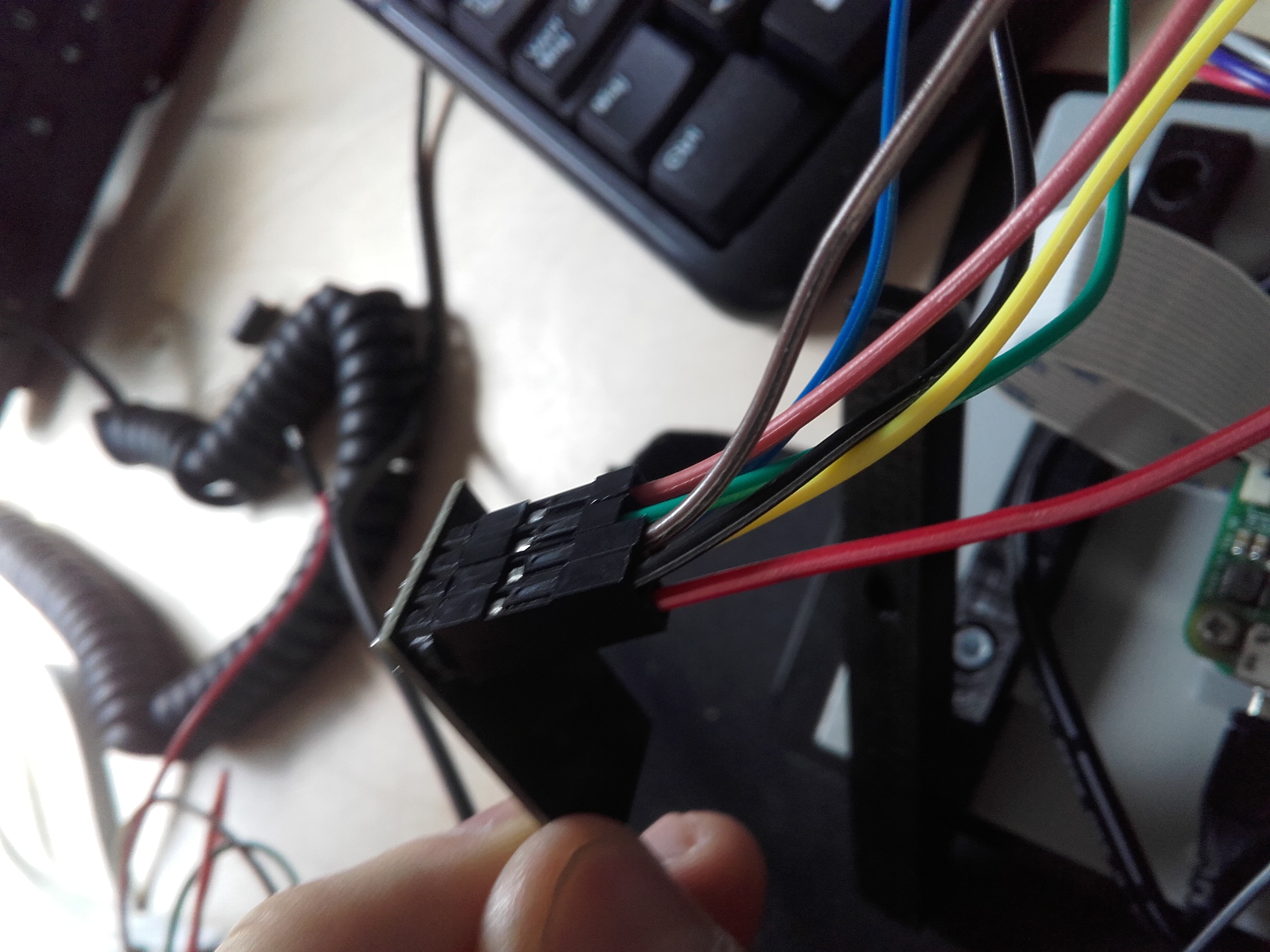

    Hello ! I am new in MySensors project and i follow this guide
    But i get this error message when launch mysgw
    mysgw: Starting gateway...
    mysgw: Protocol version - 2.2.0-beta
    mysgw: MCO:BGN:INIT GW,CP=RNNG----,VER=2.2.0-beta
    mysgw: TSF:LRT:OK
    mysgw: TSM:INIT
    mysgw: TSF:WUR:MS=0
    mysgw: !TSM:INIT:TSP FAIL
    mysgw: TSM:FAIL:CNT=1
    mysgw: TSM:FAIL:DIS
    mysgw: TSF:TDI:TSL
    I double check the wiring, SPI is activated, my NRF24L01 module works on an Arduino and mosquitto works fine on my Rpi.
    Did i miss something ?

      @tchoblond59 the gateway software is unable to communicate with the nrf. Are you using a PA+LNA version? If so, you'll need a separate power source. If you can upload a picture of your wiring that might help us help you.

        I try both PA+NLA and the other. I know about the power issue and i also add a little capacitor betwenn VCC and GND.
        That's hard to take a photo of this but...
        • mfalkviddM Offline
          Where do the red, grey, black and black cables from pin 2, 3, 4 and 7 on the Pi go?
            I strongly suggest try with a voltage regulator and a capacitor

              They go on the official rpi screen 7"
              I try to power the nrf24 from an arduino. Is it enough or should i try with dedicated power supply ?
              My capacitor is 100uF is it enough ?
              • T Offline
                T Offline
                tchoblond59
                Wow you were right... I connect it on another Raspberry without screen and it seems to work.
