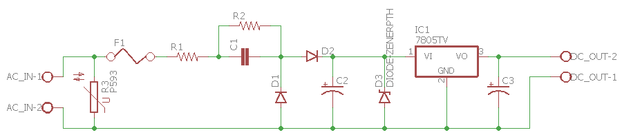

    Can I use a Capacitor-Resistor voltage dropper circuit without isolation to power up my Node like the one in below image.
    I understand the node would not be mains isolated and would be a risk if touched. Apart from this are there any other risks or performance issues that I should be concerned of before I dive into constructing this circuit. I will add a LDO regulator at the output to get a regulated supply.
    Please share your thoughts and views. Thanks

            @Suresh-Mali - if you open up a commercial product there are a lot of these examples with transformerless power-supply. The main difference is that they are tested in a professional environment and certified before use. Its much smaller but since you don't have the isolation from the transformer its harder to do safe.
            Can you? Yes
            Is it safe? Impossible to say before tested professionally.
            Would your insurance cover it if your house burn down? No not likely...

              @gohan Overvoltage and short I guess can be solved if I use an MOV and Fuse.

                      @Suresh-Mali I modified the above schematic, just to add some protection and regulation.

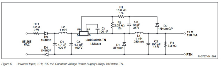

                              @rvendrame My current design uses Hi Link 5V PSU, however I am looking at lowering the cost and this was one of the options.
                              I also reverse engineered some cheap 5v phone chargers, its an SMPS based design using single transistor. Are safe as there is isolation.
                              This might be my next option to look into. The problem is with the transformer. How do I get the transformer to my specification. Do I wind them myself? will have to look into it.

                                      @Tmaster Thanks for bringing this up. I was able to find LNK family ICs where I'll be able to source at cheaper price. I have ordered some LNK306 to test them. Cost me 80Rs/$1 and some cents. Will test once I receive them and post the results.

                                        @Suresh-Mali I recall from discussion back that using a Linear regulator like 7805 at the end of this sort of power supply is almost always a bad idea. Here every design use Zener for a reason. Zener will only dissipate heat when there is extra power available. Linear regulator will always dissipate power leaving less available power for your application.
