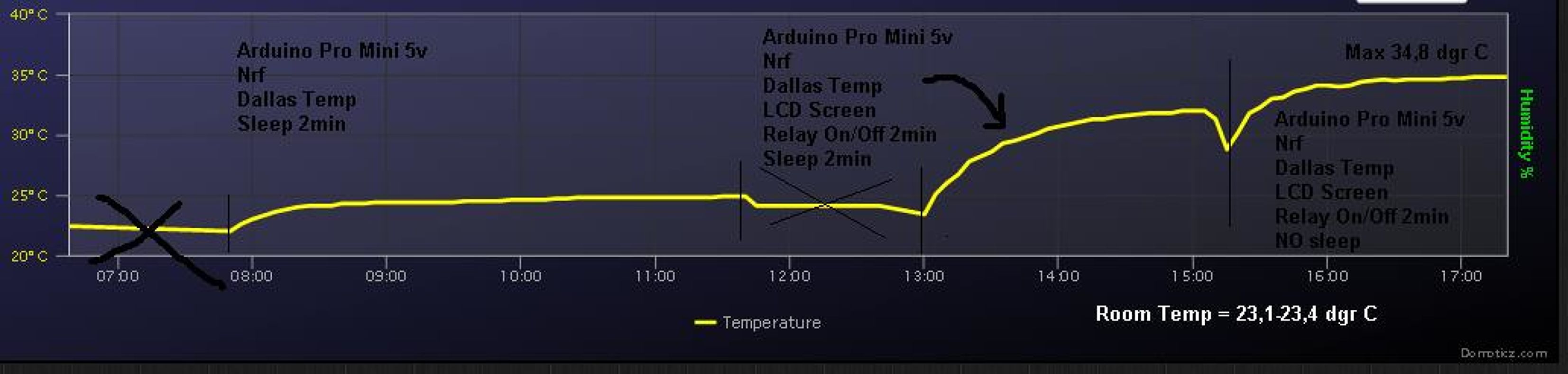

                                one could monitor the temperature
                                @NeverDie - this is the exact approach I have in my In wall AC/DC nodes.
                                https://www.openhardware.io/view/13/In-Wall-ACDC-Pcb-for-MySensors
