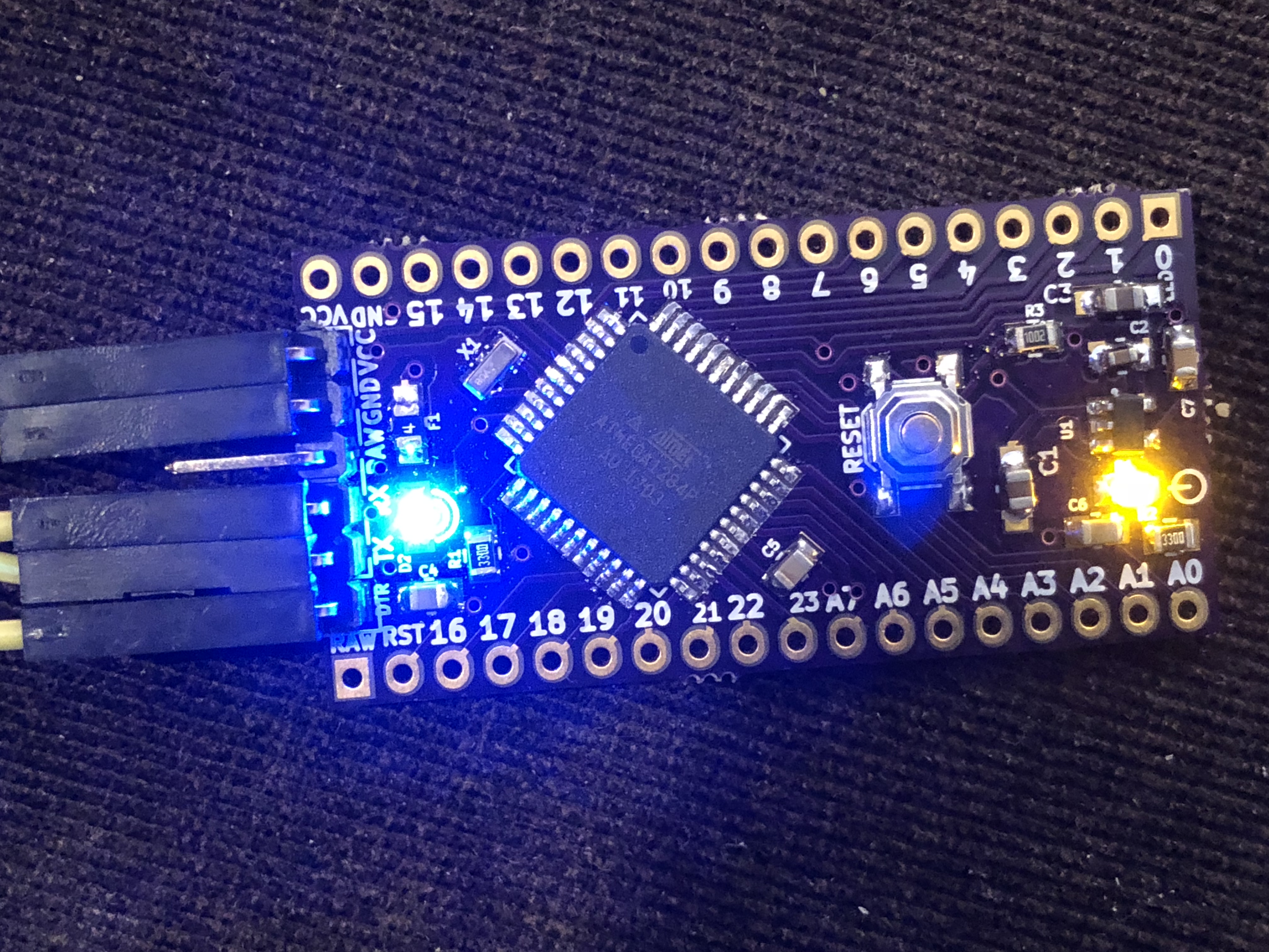

    More and more, I come across that atmega328p loaded with mysensors, signing, encryption and a few sensors and libraries gives me this:
    Sketch uses 31924 bytes (103%) of program storage space. Maximum is 30720 bytes.
    Global variables use 2076 bytes (101%) of dynamic memory, leaving -28 bytes for local variables. Maximum is 2048 bytes.
    Sketch too big; see http://www.arduino.cc/en/Guide/Troubleshooting#size for tips on reducing it.
    Error
    Whereas I do have Moteino Mega, which is an excellent form factor, but a but a bit too large when it comes to a small node. Anyone can recommend a tiny form factor node like Sensebender Micro but with considerably more memory please?
    AnticimexA NeverDieN 2 Replies Last reply

        @alexsh1 said in atmega328p small (SMD) alternative with more memory?:
        Well, the nRF52 series has more memory and is better in almost every way. And you can program it through the familiar Arduino IDE. Time to join the band wagon.

                          Alternatively, this is a good size for a node - https://www.sparkfun.com/products/13664

                                    @anticimex you are absolutely correct. It does not have to be binary identical to atmega328p. However, size wise, it has to be small enough.
                                    For now atmega1284p is a direct replacement for atmega328p as code is almost identical. I do not need much more processing power just memory. However, I did struggle to find a very small footprint.
