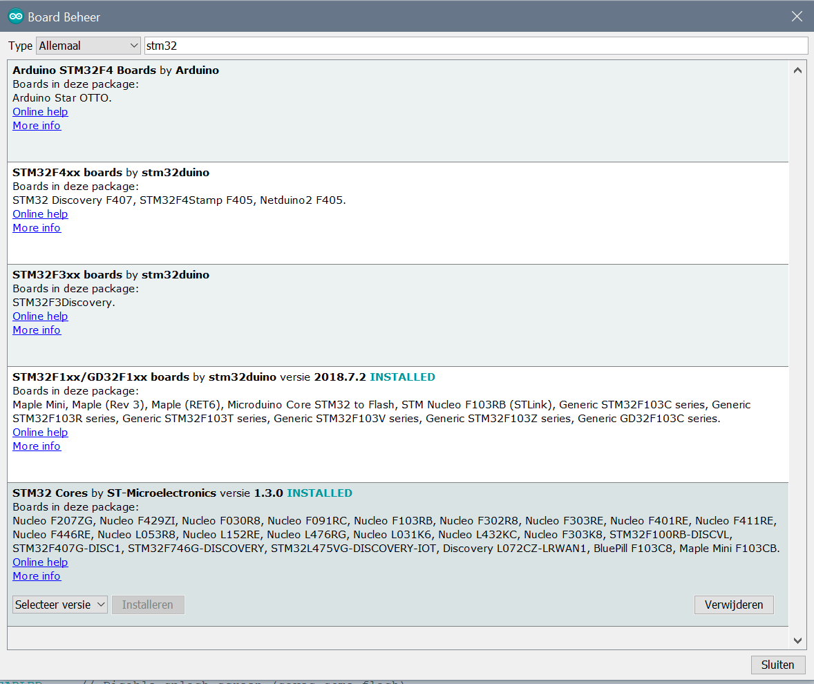

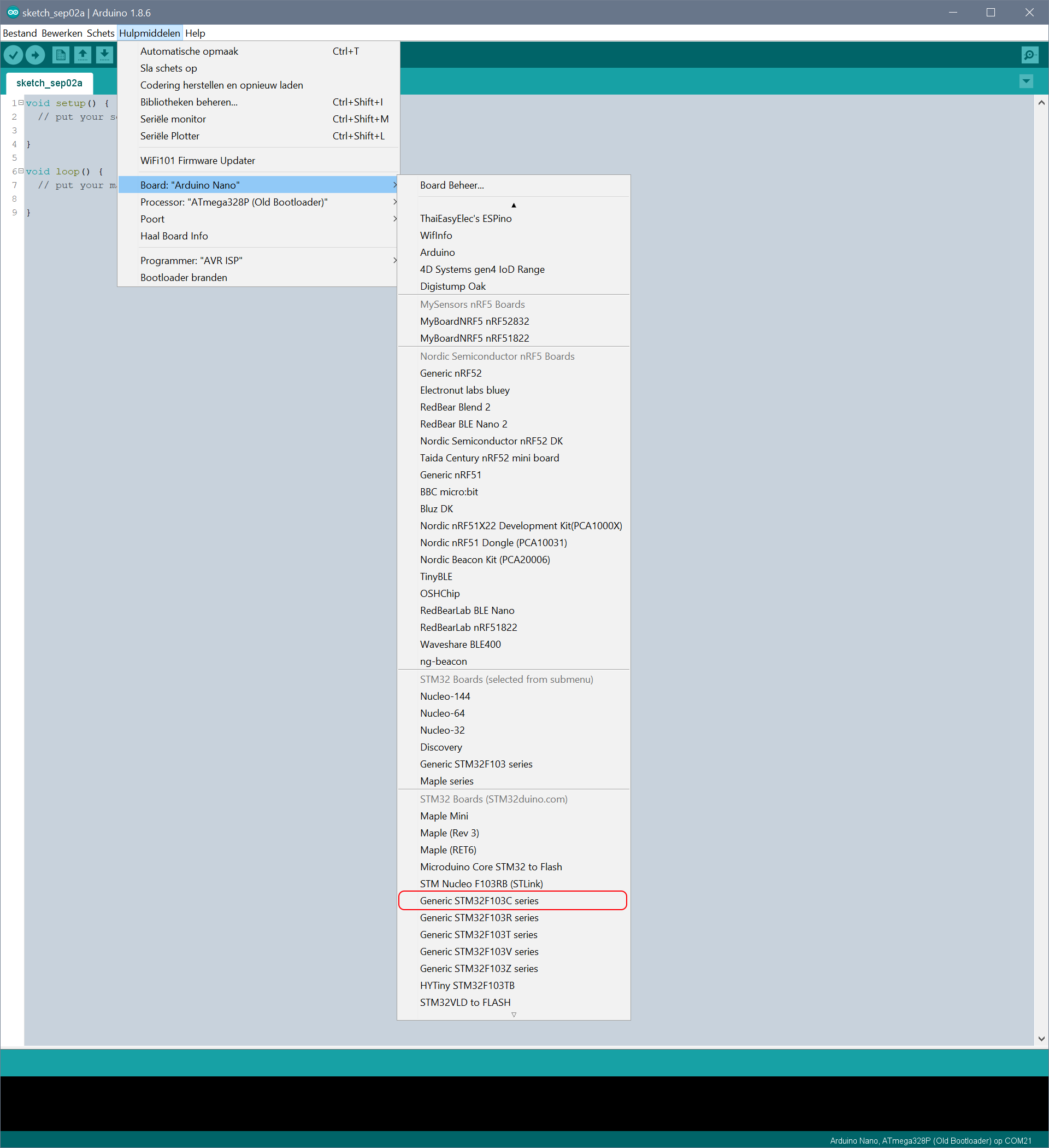

                                YveauxY
                                YveauxY
                                @freynder said in Is the 32-bit ATSAML10 the ATMEGA328P killer that we've been waiting for?:
                                AFAIK, MySensors currently only works with the unofficial one from Roger Clark
                                I'm using Blue Pills with stm32duino (https://github.com/stm32duino/Arduino_Core_STM32) and MySensors without problems.
                                Stm32duino also supports a number of STM32L variants.
                                F 1 Reply Last reply
                                • YveauxY Yveaux
                                  F
                                  F
                                  freynder
                                  @yveaux I stand corrected. I just tried compiling an example sketch and indeed no errors. Last time I tried I had compilation errors, but that may have been due to other factors then.

                                    @freynder Yes. I had a Blue Pill with RFM69 working from stm32duino, but it has been a while.
