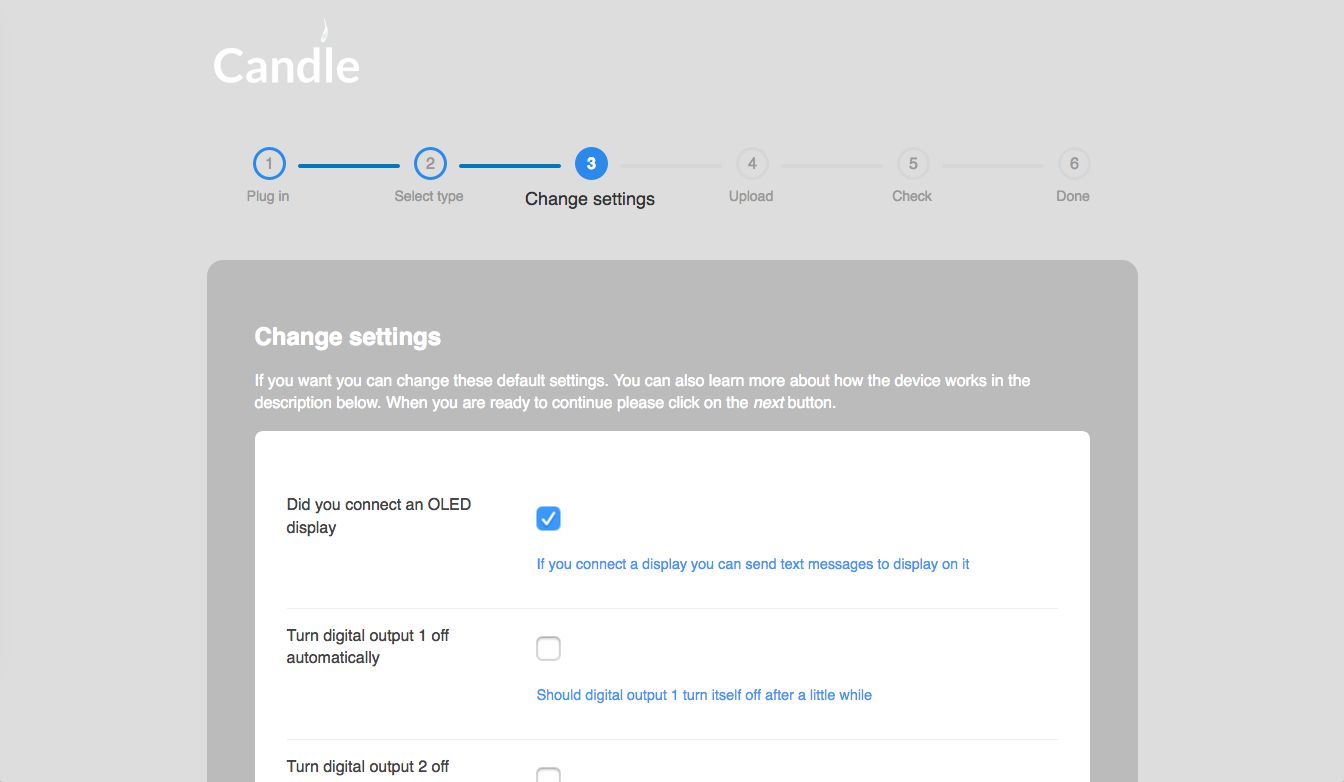

    If you follow the convention in your code, then some of the #define and variable settings in your code will be turned into an interface. For example, this code is turned into:

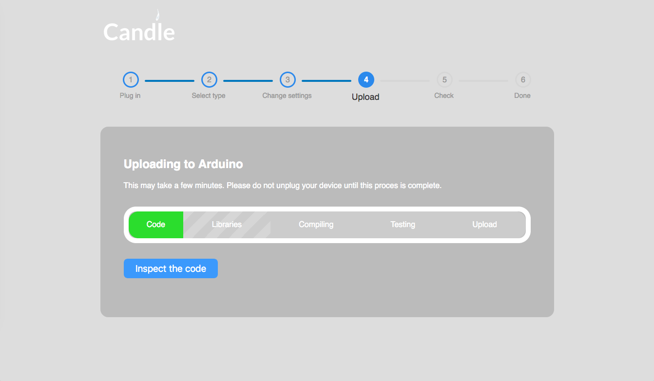

    On you all the settings are to your liking, you can continue to the upload phase. Here, the security password you set in the add-on settings is added into the security defines such asMY_ENCRYPTION_SIMPLE_PASSWD. Next, required libraries are automatically downloaded. It also figures out which bootloader to use by attempting a test upload.

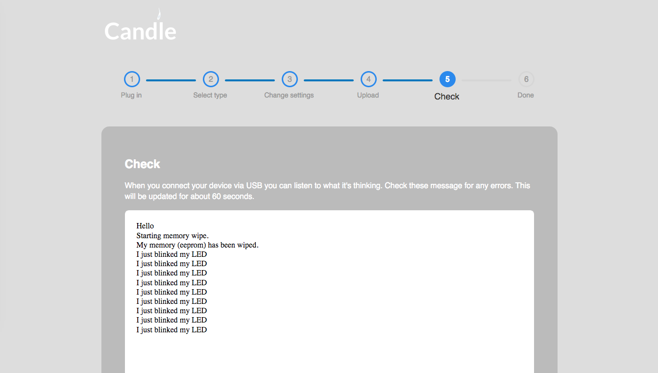

    Once the upload is done you can check the serial output of your new device.
