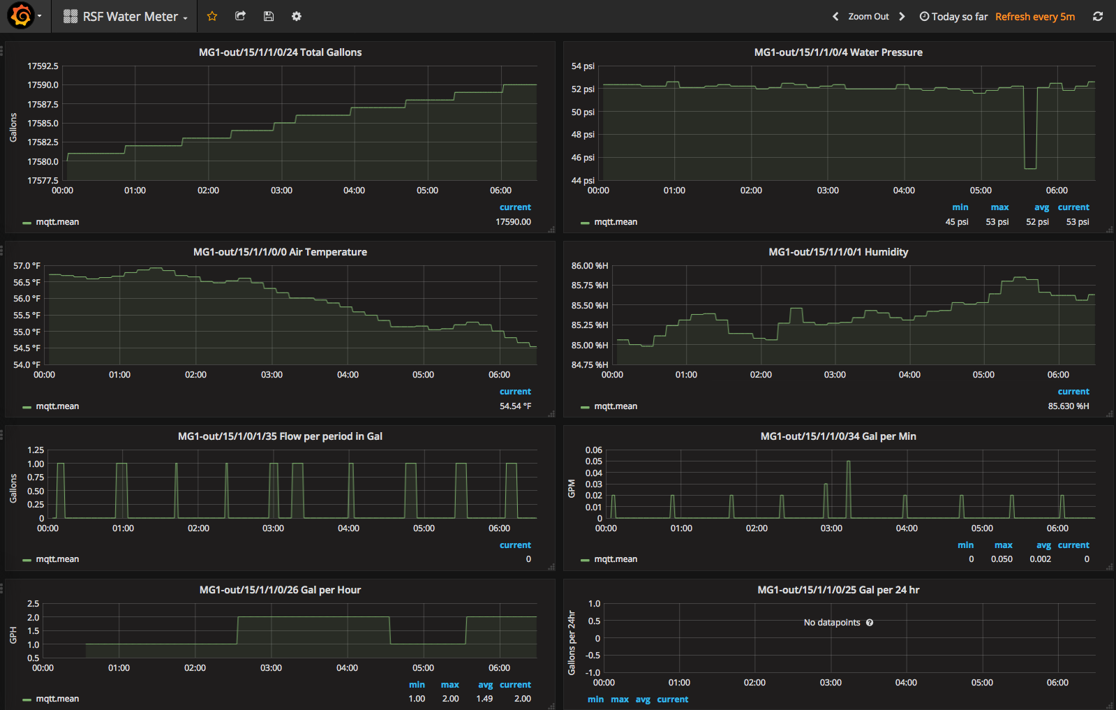

    WaterMeter-MS-3.0i-RFM95
    Data from the MySensor node to MQTT-gateway to MQTT to Telegraf to InFluxdb to Grafana.
    Controller function via NODE.RED connected via MQTT.

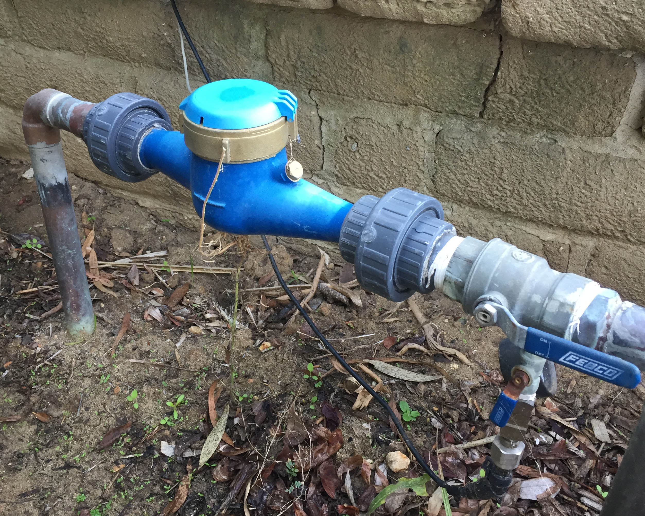

    It measures water flow from a Dwyer WMT2 water meter in pulse per gallon.
    Used a 0 to 100PSI pressure sensor (from ebay), via an analog port.

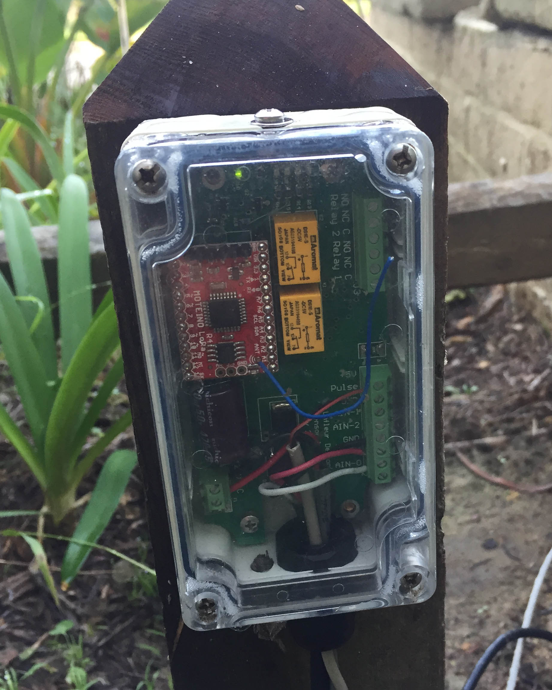

    Support MCP9800 or Si7021 (humidity also) for air temp.
    Two relay outputs
    3 Analog inputs
    MAX6816 or analog filter for contact de-bouncing for water meter
    Powered via an 8 to 28v AC or DC external power source
    (Board is designed to fit in a Hammond 1554 case)
    Processor is a Moteino R4 LoRa with a RFM95

    https://www.dwyer-inst.com/Product/Flow/WaterMeters/SeriesWMT2

    design file are located at:
    https://github.com/trlafleur/WaterMeter-MS-3.0i-RFM95
