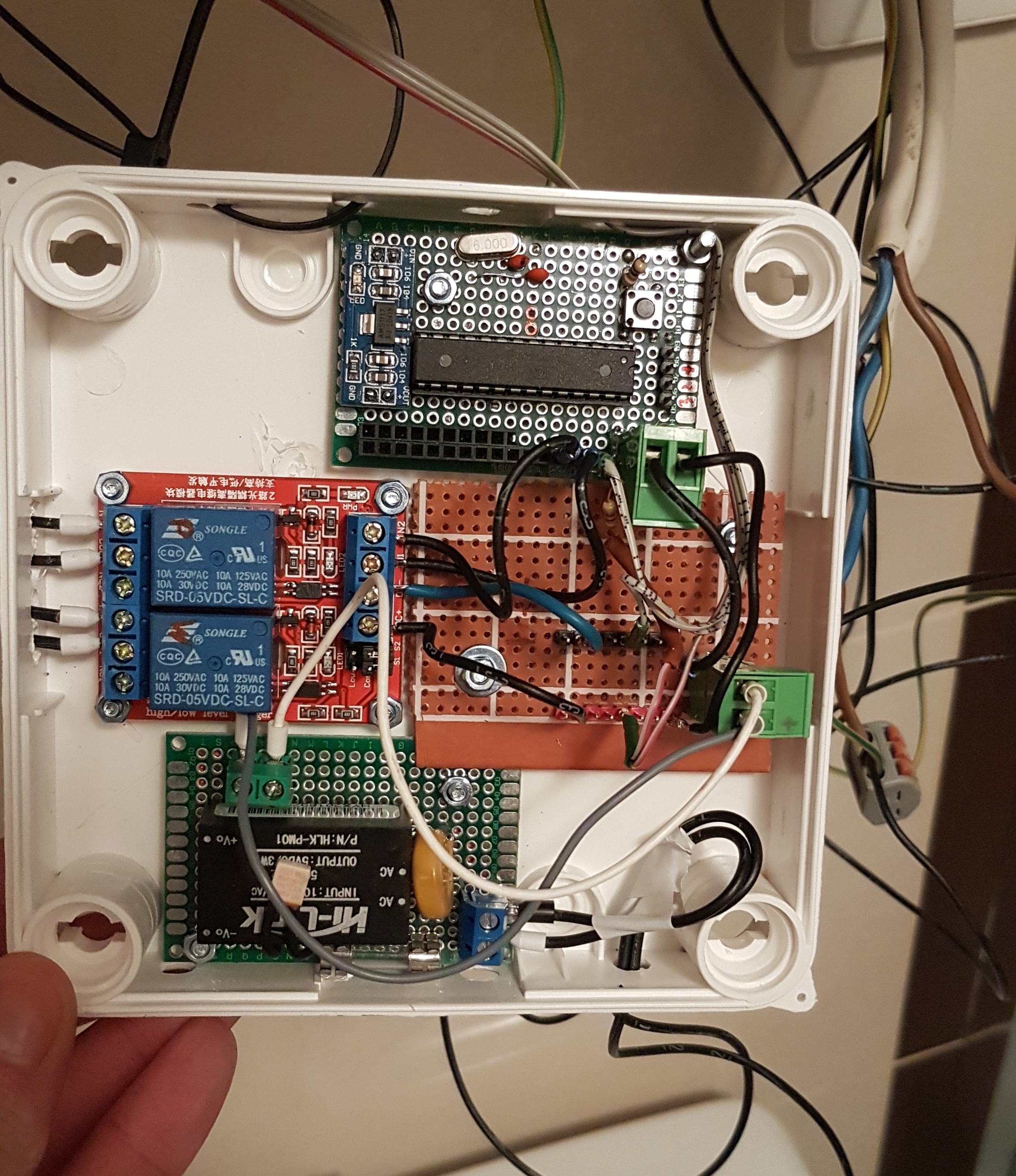

    This is for those who can solder but making own board with SMD is to advanced :) like me...maybe someday...
    Few pictures of whole set with some code for MySensors node.
    This device is to run bathroom ventilator, simply turn on and off my heating system and to measure temp & hum in the bathroom.
    System is based on Atmega 328p chip
    0_1490359079880_211.png,

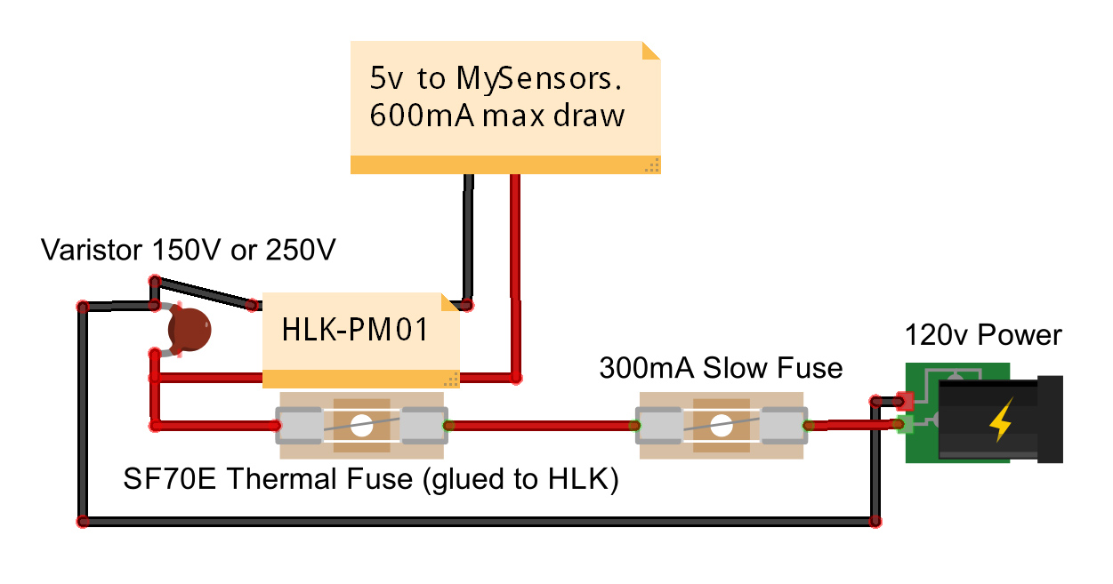

    power supply made according to this:
    https://forum.mysensors.org/topic/1607/safe-in-wall-ac-to-dc-transformers
    with adjustment for 230V mains.
    Used also voltage regulation board for radio and double relay board from ebay:
    now it is running over one month, box is hidden in the dry wall.
