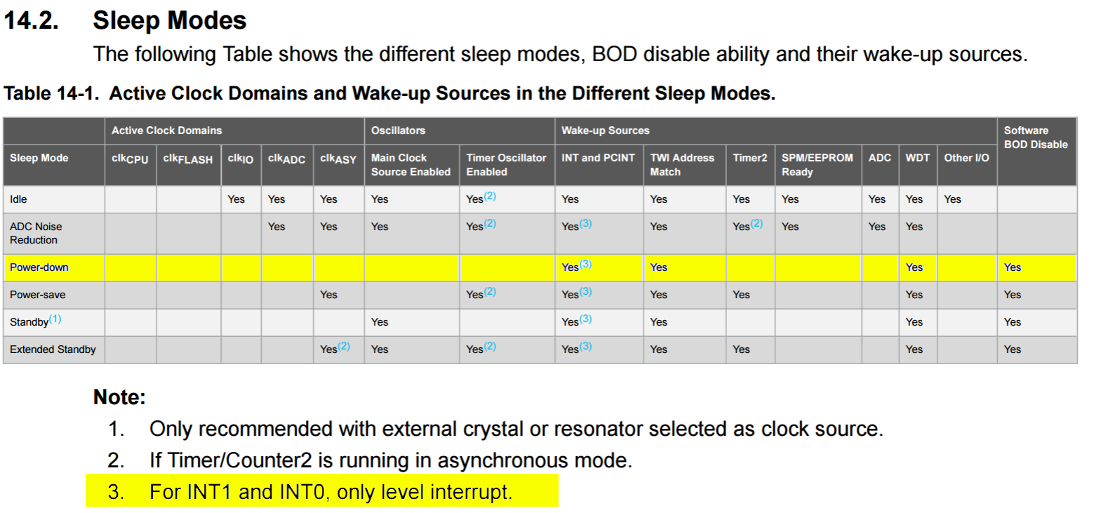

                      @mar.conte I did some testing and I am experiencing a similar thing.
                      The node powers down (8 uA)with sleep( 5000 ); // sleep only
                      but with
                      sleep(INTERRUPT1, CHANGE, INTERRUPT2, CHANGE, 0 ); // sleep and wait for motion
                      or
                      sleep(INTERRUPT1, FALLING, INTERRUPT2, FALLING, 0 ); // sleep and wait for motion
                      it doesn't (2.5 mA)
                      I will do some additional testing ...:confused:

                                  YveauxY
                                  YveauxY
                                  @AWI See @tekka post here
                                  "For indefinite sleeping, only level IRQ triggers are permitted (see AVR datasheet)."
                                  Could you give that a try?
                                  AWIA 1 Reply Last reply

                                          RESOLVED
                                          I HAVE JUST ONE GATEWAY CONFIGURED WITH RFM69 ON BOARD, THEN I HAVE CONNECTED TO NODE ID MCU WITH PIR AND EVERYTHING WORKS, WHEN THE PIR IS HIGH CURRENT CONSUMED is 2.25 MAH, WHEN IN SLEEP MODE ONLY 30 microamps.
                                          THANKS TO ALL THAT I HAVE HELPED

                                          @mar.conte Great to hear you nailed it!
                                          For others to learn: what did you change to make things work?
