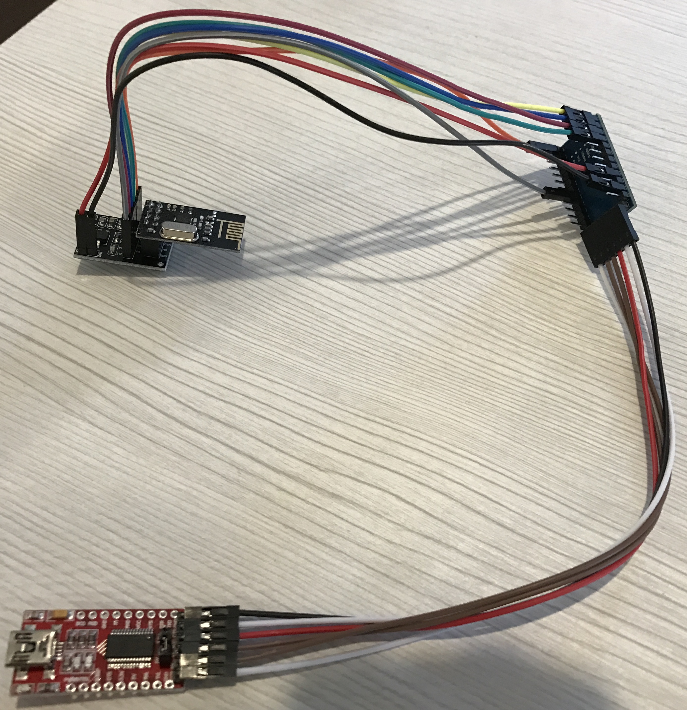

    Thanks to great help from the community I've managed to set up an ethernet gateway using Arduino UNO and a W5100 ethernet shield.
    Now I'm building my first sensor node based on Arduino Pro Mini but I have no idea on how to proceed. I'm using Home Assistant as my controller.
    I've made a sample sensor assembled with dupont cables to test different sensors before building real nodes. I am able to program it with the FTDI adapter but have no idea on how to present it to Home Assistant or even know if its communicating with the gateway.
    I couldn't find a tutorial online on how to integrate MySensors and Home Assistant, please help.
    Here's a picture of my POC sensor node (a cap to the radio module will be soldered today after I visit the local electronics store to resupply my stock).

      @Misna have you seen the "Plugin and install instructions" at https://www.mysensors.org/controller/homeassistant ?

        Yes I have. When I upload the sample scetch from HA site I get this from serial monitor:
        #!⸮⸮⸮0 MCO:BGN:INIT REPEATER,CP=RNNRA--,VER=2.1.1
        3 TSM:INIT
        4 TSF:WUR:MS=0
        11 TSM:INIT:TSP OK
        13 TSM:INIT:STATID=1
        15 TSF:SID:OK,ID=1
        17 TSM:FPAR
        53 TSF:MSG:SEND,1-1-255-255,s=255,c=3,t=7,pt=0,l=0,sg=0,ft=0,st=OK:
        2060 !TSM:FPAR:NO REPLY
        2062 TSM:FPAR
        2098 TSF:MSG:SEND,1-1-255-255,s=255,c=3,t=7,pt=0,l=0,sg=0,ft=0,st=OK:
        4106 !TSM:FPAR:NO REPLY
        4108 TSM:FPAR
        4144 TSF:MSG:SEND,1-1-255-255,s=255,c=3,t=7,pt=0,l=0,sg=0,ft=0,st=OK:
        6152 !TSM:FPAR:NO REPLY
        6154 TSM:FPAR
        6190 TSF:MSG:SEND,1-1-255-255,s=255,c=3,t=7,pt=0,l=0,sg=0,ft=0,st=OK:
        8198 !TSM:FPAR:FAIL
        8199 TSM:FAIL:CNT=1
        8201 TSM:FAIL:PDT
        18204 TSM:FAIL:RE-INIT
        18206 TSM:INIT
        18213 TSM:INIT:TSP OK
        18215 TSM:INIT:STATID=1
        18217 TSF:SID:OK,ID=1
        Now I have no idea where to start debugging this. In the scetch there is some lines that should print status messages to serial line but I can't see any of those.
        What should I check next? I don't know if the node even has radio access to the gateway.
          I don't see any capacitor on the vcc of the nrf24 radio
