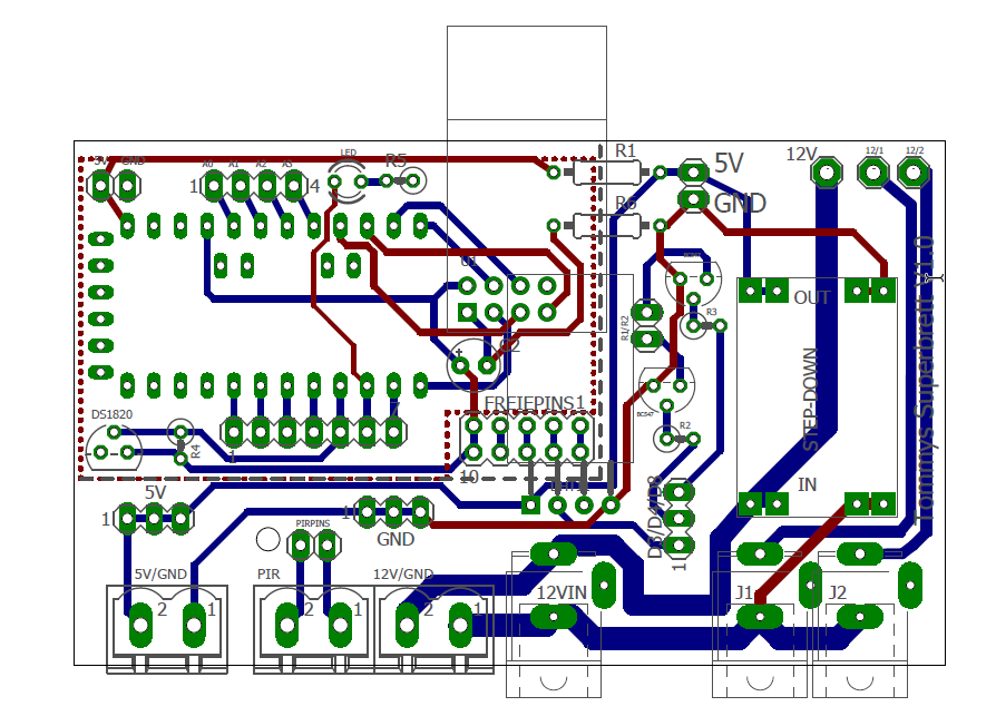

    But I realized that all this soldering with wires takes too much time or is not that nice. So somebody told me make your own PCB.
    So I learned EAGLE and built my first PCB. I sent it to a PCB-Maker and Tataaa. There they are:
    0_1491571947393_upload-052b6355-f591-4e0d-b37c-12b4b4ed6c04
    0_1491571967051_upload-d53388dd-21a3-4ae1-8ccb-176442bfde54
    I built the PCBs in a way, I could divide them for smaller applications. The most important for me was the easy to built Arduino-Radio-Section. It has the most connections. The rest is easy.
