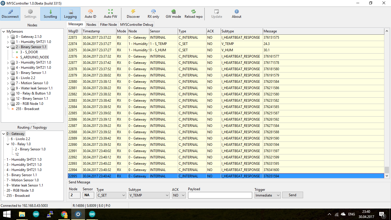

    I've got several nodes around my appartment: three temp/humidity sensors, double relay, door.
    I have built another relay node to hack my ikea floor lamp. It's working fine, and it has a default repeater feature. Now I have built another door sensor. It is a MySensors Stable node with MYS 1.3 bootloader. It's working through the node 10 (floor lamp). When I turn the lamp off to get rid of the repeater node the new door sensor (node 2) stops working. If I reboot it manually it doesn't find parent (I want it to be the gateway). I tried to assign manual parent ID 0 but it doesn't help.
    How do I make it work without the repeater? I want it to work in another room.
    P.S. I tried to clear eeprom, then flash the firmware, assign parent ID manually, rebooting it without repeater turned on, rebooted it near another repeater (double relay). Oh, I forgot to tell, the gateway is closer to the node then the repeater node 10.

                The repeater is fisically off. I can see the routing table through the MYSController. Tried to clear it - doesn't seem to work.

                        The range is not the issue because I tried to move it closer to the gateway, but untill I power on the repeater node it didn't work.
                        I sent C_INTERNAL, I_DEBUG, E to node 10, is has reset it's ID and became no 11, and after that nodes 2 and 12 starter to work through node 11. Damn it. I reset the ID of node 2, it became node 8 and continued to work through node 11. Sh*t!
                        Now I've got two nodes that just want that bloody repeater node 11 and don't want to deal with the filthy gateway :)
                          Did you restarted the gateway so that all nodes presented again? It is actually kind of weird since quite some people had issues about the nodes trying to connect to low signal gateway even if repeater had better signal.

                                Well, what I did is swaped the radio on the gateway, added capacitors (10-200uf), swaped the nrf chip on the nodes (nrf+ and nrf), added 1M resistor to the node for radio back compatibility, moved nodes closer to the gateway and further from it, flashed the repeater node (now it's node 10 again) with repeater function disabled.
                                In the end, I've got three new nodes that talk to controller ONLY through repeater node (the repeater node is further from the gateway then the new nodes). Clearing the routing table on the repeater node doesn't help, erasing eeprom of the repeater node makes it change the node ID and after restarting the other nodes they bind to the repeater again.
                                Strange thing is that the node 10 is with MYSBootloader (which has nrf chanel 76 set) and it talks straight to the gateway. The nodes (8,12,13) have the same bootloader and nrf chanel set to 76 and are not recognised by the gateway as soon as there is no repeater node 10.
                                  I am out of options.... I am calling for @hek help :D
