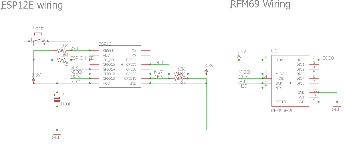

    I got a little question regarding my ESP RFM gateway. I think the PCB should be oke.
    I got the ESP working, i can connect to it though MYSController but Sensors dont report to it.
    So I think, I may messed up my sketch or the connections between the ESP and the RFM.
    Is there someone who can Judge this?
    I cleaned up the Diagram. I should have plenty of caps for the ESP and RFM to work, 100Uf for the chips, some 100nf for and after the regulators.
    The question is, are the connections oke?
    0_1499418297327_upload-82fa2a3e-7435-4db2-9015-f9b32aca7dcd
    The second is my Gateway sketch.

    13-7-2017: GPIO 4 & 5 are switched on the ESP12. changing the IRQ from 5 to 4 did the trick.

      would be easier if you could post your gw logs ;)

          Here it is:
          Last line is when connecting MYScontroller
          when I boot up the sensor (with new uploaded sketches..) it stays silent.
          When I connect my other gateway a couple of minutes later, it start showing up at my other controllers
          0;255;3;0;9;TSF:LRT:OK
          0;255;3;0;9;TSM:INIT
          0;255;3;0;9;TSF:WUR:MS=0
          0;255;3;0;9;TSM:INIT:TSP OK
          0;255;3;0;9;TSM:INIT:GW MODE
          0;255;3;0;9;TSM:READY:ID=0,PAR=0,DIS=0
          0;255;3;0;9;MCO:REG:NOT NEEDED

            Seems like the ESP-12 switches GPIO5 and GPIO4.
            Changing the the GPIO 5 => 4 did the trick:
            #define MY_RF69_IRQ_PIN 4 // GPIO5```
