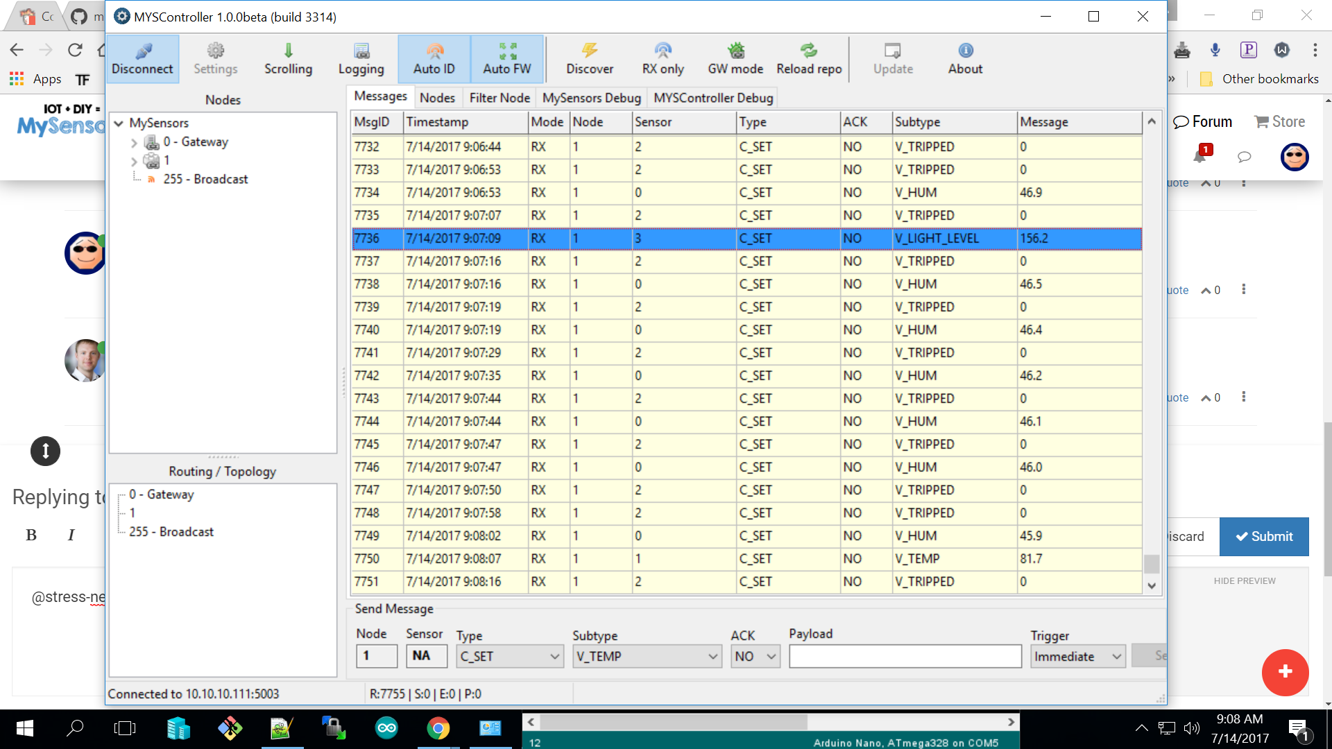

    Hello first time user here, I have been trying to build a 4in1 light, motion, tem/hum using a nano, temt6000, dht22, and sr501 using the examples and already made sketches i can combine everything, but i am not sure if i am entering the info for the temt6000 correctly. Can someone take a look please```

     // Read lux from TEMT6000
      float lightLevel = analogRead(LIGHT_SENSOR_ANALOG_PIN) *  9.;  // 1000/1024
      if (int(lightLevel - lastLightLevel) > 10 || int(lastLightLevel - lightLevel) > 10) {
          send(msg.setSensor(CHILD_ID_LIGHT).set(lightLevel,1));
          lastLightLevel = lightLevel;

  • @mfalkvidd it's a ambient light sensor. I was going to use a esp8266 with these to make a 5in1 node inspired by a video i saw with just header wires , but decided to use arduino nano instead. What i posted seems to work ok but being brand new i figure i would let someone else take a look and see if everything was ok with what i have so far or if i could make it better.

  • @stress-nero the light values was fixed bad jump wire position,
    ![alt text](0_1500037741362_upload-bc52de37-cdbc-47f8-aed4-288746977651 image url)
