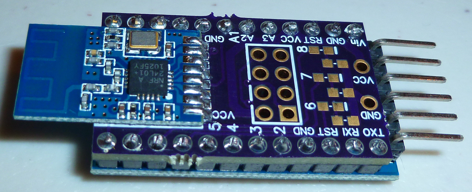

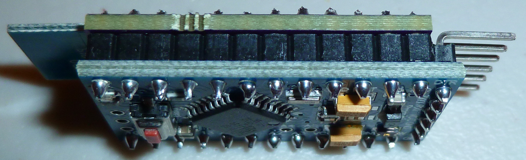

    Here is my Wemos "Serial" wireless gateway that I just today put together and installed. Connects to Domoticz as an ethernet gateay over wi-fi. Uses a static IP address that I configured on the wi-fi router. By the way, it's powered (and physically supported) by an Ikea USB charger, as seen in the photo. :)
