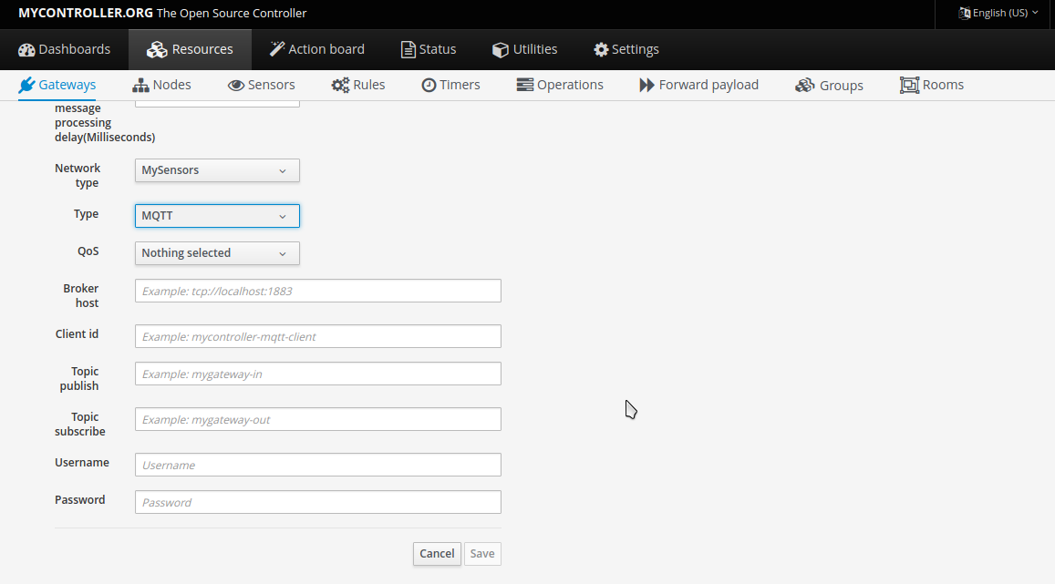

    Hello all, a quick but important question. When we add a new mqtt gateway, I get several fields, please confirm:
    QoS: << Zero? Or should I use 1? >>
    Broker host: << The Broker That The MQTT Gateway is pointing to. MY_CONTROLLER_IP_ADDRESS variable >>
    Client id: <<The Gateway ID? Or A Id to The Controller?>>
    Topic publish: << MY_MQTT_SUBSCRIBE_TOPIC_PREFIX variable from gateway >>
    Topic subscribe: << MY_MQTT_PUBLISH_TOPIC_PREFIX variable from gateway >>
    I've been having some problems with the controller and MQTT, and I was wondering if it's some miss configuration
    Using https://www.mysensors.org/build/mqtt_gateway as reference
    Thank You

  • Hardware Contributor
    I think I dind't explain myself proprely, sorry, probably lost in translation.
    I was talking about MyController gateway configuration:
    The Fields on the screen:
    Broker host: This Is the MQTT Broker Address?
    Client id: Is this a unic name to the MyController client, or the GW Name?
    Topic publish: The topics where the Mysensors GW is submitting?
    Topic subscribe: The topics where the Mysensors GW is Subscribing?
    Thank you

    @soloam said in MQTT Gateway Configuration:
    It's up to you, just Google it to see what different qos levels do, either would probably work just fine
    The ip address of mqtt broker
    Choose whatever you like, just make it unique
    That is where gw is subscribed listening for data
    That is where gw publishes the data
    Keep in mind that mycontroller has a built-in mqtt broker, so you have to disable it if you are using it on the same computer as the other mqtt broker
    Thank you for your replay. My main doubt was the client-id, I didn't understand if it was a unic name or the GW client-id. You answered my question.
    Thank You for your help
