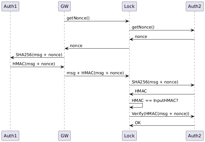

      • D daulagari
        @Zeph said:
        So I see the security question as technically interesting but not pragmatically vital at this time.
        Yes, also I am more "scared" about other things than people accessing the mysensor network but I do not need remote controlled locks :smile: For me, thinking about it is good fun that can be hopefully helpful in the end.
        I think that what makes the most sense is a stream cipher which can encode 1..32 bytes, and which can include or exclude the network header.
        Based on streamciphers the ARCFOUR assembler implementation looks like a nice pick. The problem however for stream ciphers is:
        • The starting state (seed) needs to be different for every packet sent
        • The seed needs to be known by sender and receiver but must be secret for others
        • Authenticity is not guaranteed, the message contents can be change without problems and that while authenticity seems to be more important than confidentiality
        This makes me think that for a "good-enough" streamcipher too much additional components are needed like a hash to get ourselves a seed and additional code/data to improve authenticity.
        I'm thinking of using a 32 bit incrementing counter appended to the end of a payload before encryption.
        A counter is largely predictable and a generic problem with sensor data is already that it is highly predicable making a "known plaintext" attach easier. You need some kind of counter to prevent replay attacks but provided the counter is encrypted, the acceptance range (N+1 to N+m) is not too big how much would we really need?
        Given the problem I see around a streamcipher implementation and a "known" plaintext I think the drawback/overkill of blockciphers that the block size is too big (64/128) byte might become handy so we can fill up thing with random padding.
        Had a look at XTEA and think I like it because of size and performance. But I much better would like that there is some kind of version or cipher field (four bits?) that specifies which cipher is used so things can be mixed and upgraded.
        I'm not sure if you wind up agreeing that an acceptance range of N+1 to N+m (out of 2^32) is sufficiently robust (for our purposes) or not.
        I was suggesting that the 32 bit value be appended to the end of the payload, so it would not make for a predictable start. And "predictable" is relative - an attacker doesn't know where in the 32 bit space you started your counter, so it's a weak sort of initialization vector in addition to the cipher key per se. The more predictable contents of a packet is probably a larger weakness, if known (or almost known) plaintext attacks are the concern. However, I think that cracking a decent stream cipher under these circumstances is non-trivial. Somebody with that level of skill and determination would probably not waste it raising my blinds.
        I started with the idea of a 4 byte random number and a 4 byte counter, but 8 bytes of overhead per packet seems like a poor tradeoff. So I thought of reducing each to 16 bits. Then I thought about allocating a varied number of bits to each. Then I thought - starting with a random 32 bit number and then incrementing it is a fairly reasonable compromise for a modest security system like this. I also considered using a PRN generator for the sequence instead of a counter, but if the encryption is decent, that would not help the security much, and it makes testing for validity much slower.
        The first goal is to authenticate and prefent playback attacks; confidentiality is secondary. And this is not going to be used in banking.
        We can pad, but the packet is only 32 bytes (1..2 or 1..4 blocks). If we wanted to leave the network headers in plaintext, then it gets worse; with AES, that leaves you with exactly one 16 byte payload - no room for two. I'm not liking that as well as a stream cipher, but it's a judgment call rather than a fact.
        I'm not thrilled with needing to implement multiple ciphers in small machines; even one takes up signficant Flash and RAM.
        Of course, you could say that all of a given network would use the same algorithm, in which case the "which cipher" code only confirms they are using the same one. But in that case, you could just silently choose the same algorithm for all your nodes, and that's just one more thing an attacker would need to discover. If they steal one of your nodes and read it - game over anyway.
        Currently, I think just getting one encryption protocol and algorithm implemented is challenge enough.

          @Zeph said:
          The first goal is to authenticate and prevent playback attacks; confidentiality is secondary. And this is not going to be used in banking.
          Yes I agree first is authentication and and preventing playback attacks
          To do that reasonable secure you need either a keyed-hash (HMAC) with sufficient length and a counter with sufficient length or block cipher with a (shorter) counter.
          For the HMAC + counter approach 16 bits each is pretty short I think, remember that apart from passive scanning a "hacker" can also actively scan sending "probe" packets and see what the response is, a well known attach for 802.11 WEP. Need some more time to come up with some numbers.
          Re-reading my story above I noted that it was based on wrong a wrong idea.
          Yes, with a block size of 64 bytes you need already two+ packets, with 128 (like AES) even four+. That sounds not attractive and likely overkill. On AVR-Crypto-Lib I see no block ciphers with a block size of 32 bytes or smaller...
          No that is for sure something that I did not have in mind for nodes but maybe ... for the gateway. If somebody likes to do locks one day, the requirements will be higher than authentication and preventing playback and it would be good to be future proof for that.
              1. If the payload itself is encrypted, why do you need a HMAC?
              2. Why is a longer counter needed to avoid playback with a stream cipher than with a block cipher? (One of the options for a stream cipher is using the AES in one of the block chaining modes that create a stream cipher).
              That's a good thing to keep in mind. But remember, the entire payload is encrypted with a fairly decent cipher, so the bits get pretty well scrambled. WEP had a weakness to probe. Do you know a weakness of AES with which to form the probes? Can you do it with less than billions of probes?
              If it gets down to being close to brute force, then of course the attacker could just send all possible combinations of payload bits and see if anything reacts. But that's gonna take a while!
              Which brings up another thing - perhaps we should have some simple level of intrusion detection. If you see a few thousand packets an hour which pass the nRF's CRC but fail the crypto, maybe you should be notified? Or even 10? What if a crytpo enable actuator node were to have a "crypto_fail_count" variable which it would report periodically, like every 1,2,4,8,16 or whatever failures (or it could be polled)? Not a lot of additional code.
              You have in mind only the hub handling multiple algorithms (dynamically chosen). Each crypto enabled node would have a single algorothm. The core issue to protect is commands from the hub TO certain critical actuator nodes, like blinds or door locks. If the hub can use multiple algorithms, it has to LOOK UP which algorithm to use when sending TO a given actuator node in that scenario, somewhere in its configuration. So it could also look up which algorithm to use when receiving FROM that node. Embedding an algorithm id in the header bytes then becomes neither sufficient (doesn't tell the hub what to use for sending) nor necessary (the hub has that same way to know which to use when receiving). So all that adding the ID does is waste some precious header space and give an attacker some additional clues.

                @Zeph
                The block sizes are not that bad!
                Not sure what I was drinking yesterday evening but I mixed up bit with bytes! ;-)
                No, if the payload itself is encrypted with a block cipher you do not necessarily need an HMAC. (the bits-bytes confusion made me thing we could not use block ciphers without needing more than one packet)
                1. Why is a longer counter needed to avoid playback with a stream cipher than with a block cipher? (One of the options for a stream cipher is using the AES in one of the block chaining modes that create a stream cipher).
                A stream cipher is a cipher where plaintext bits are combined with a cipher bit stream by a xor. That means that if you want to flip a particular bit of the (encrypted) message you just have to invert that bit, see Bit-flipping attack.
                AES in block chaining mode is not a stream cipher as I see it unless you want to use it as random bit stream generator and use that for a stream cipher. Not a good idea.
                Yes, to counter act probe attacks, you probably should add some kind of rate limit, but still for a somewhat larger network you can still probe the nodes one by one and have a decent probe rate.
                But, let's first calculate what is needed to make a system such that it would say take on three years before "the key is found" and only then think about preventing that even further.
                Indeed.
                Yes, you are right, maybe not needed in the header but I still would like to have a node communicate to the hub what kind (if any) crypto is wants to use. A better place for that might be the presentation.
                I think for "less" secure things XXTEA/XTEA is a good idea. Anybody knows which is better?
                For more secure things I think AES is the way to go.
                Z 1 Reply Last reply

                                          I'm going for this approach. I will use this as authentication chip. I see noo benefit of encrypting the payload. Verifying it to originate from a trusted source on the other hand is essential (for locks etc.). The major problem I see at the moment is the limitation of the payload size due to RF24. The messages are going to have to be split up, thus in some respect reducing the efficiency of the authentication mechanism, but an attacker really need to be stubborn to exploit that.
                                          Do you feel secure today? No? Start requiring some signatures and feel better tomorrow ;)
