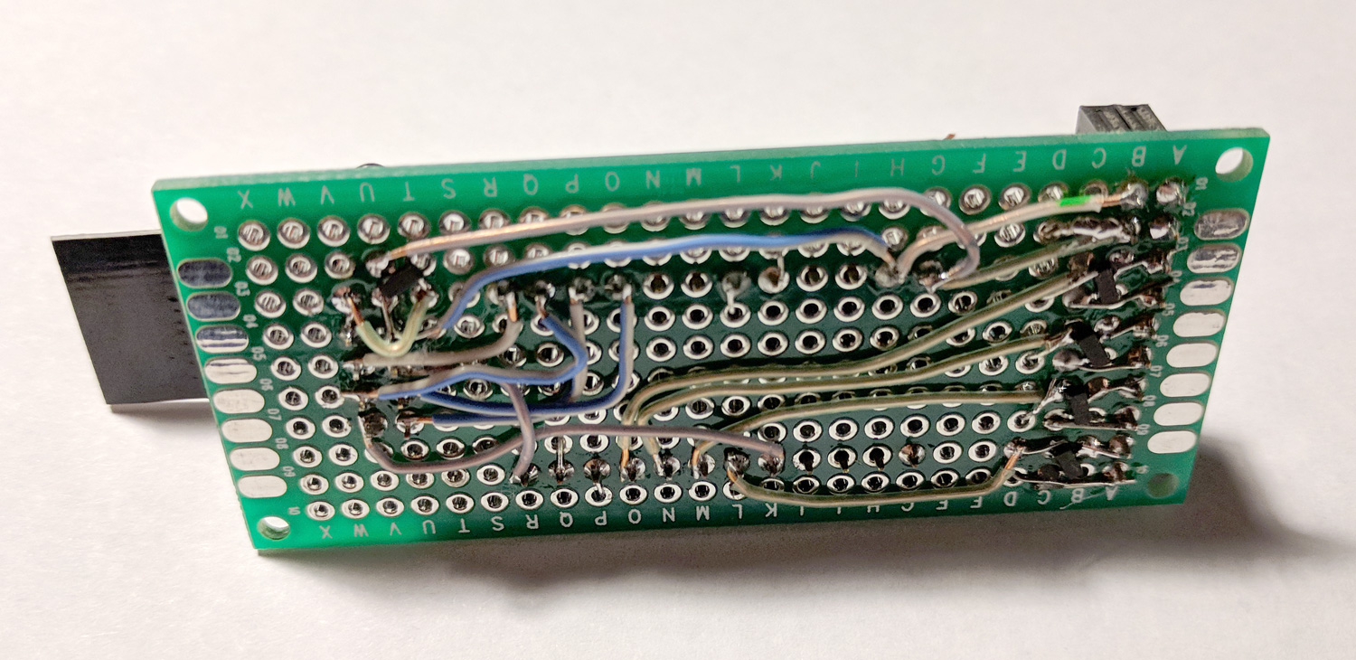

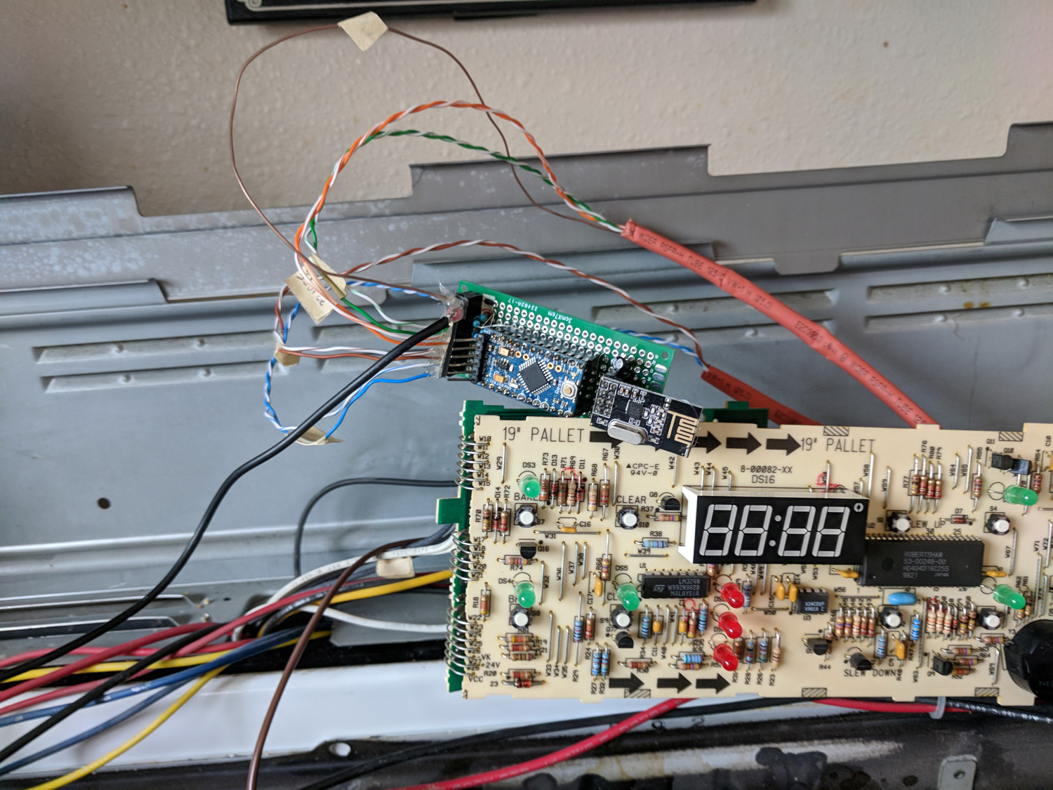

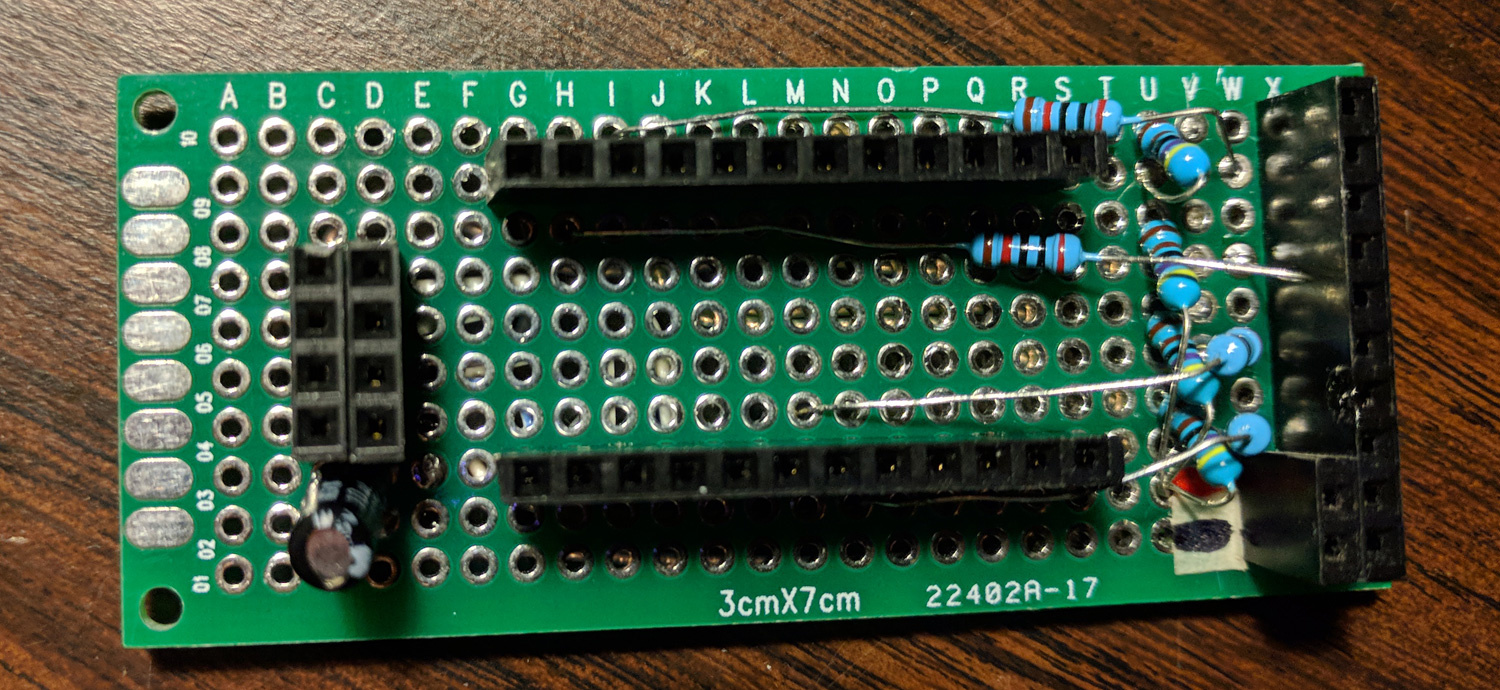

    In case you're interested, here is the code for my oven project as well as some pictures.
    Oven Code
       This will control physical buttons on a device.  In my case, an oven.  It will also read
       button presses and send the status back to the controller.  I used 4.7k resistors on the
       P-Channel MOSFET gate pins to hold them high (off) in case there are issues with the
       Arduino.  These can be omitted if you don't care if your switch floats (which you probably
       do).  I used larger resistors (somewhere around 20-30k) to detect a button press.
       These are connected to the drain side of the button/MOSFET
       Uses the bounce2 library to debounce the buttons
