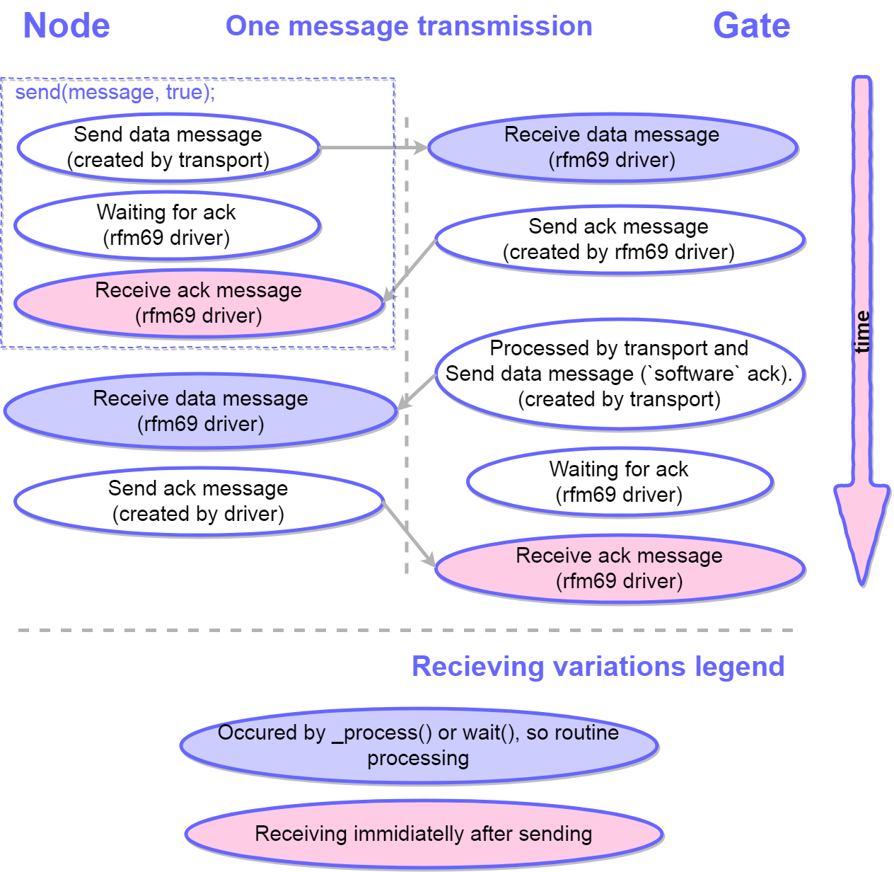

    There is only one exception to this rule. Just when you send any message with ACK request, the rfm69 driver is waiting for the ACK message. So at this moment your application can get a message too. If it is an expected ack it will be processed, otherwise – just received and not processed.
    Now we know a little more about how mysensors processes incoming messages and I will try to describe how a very simple usecase works. Let’s imagine that the node sends one message to the gateway
    send(message1, true);
    In the following diagram I tried to explain in detail the behavior of the application from both sides – gateway and the node.
    As you can see this case works properly.

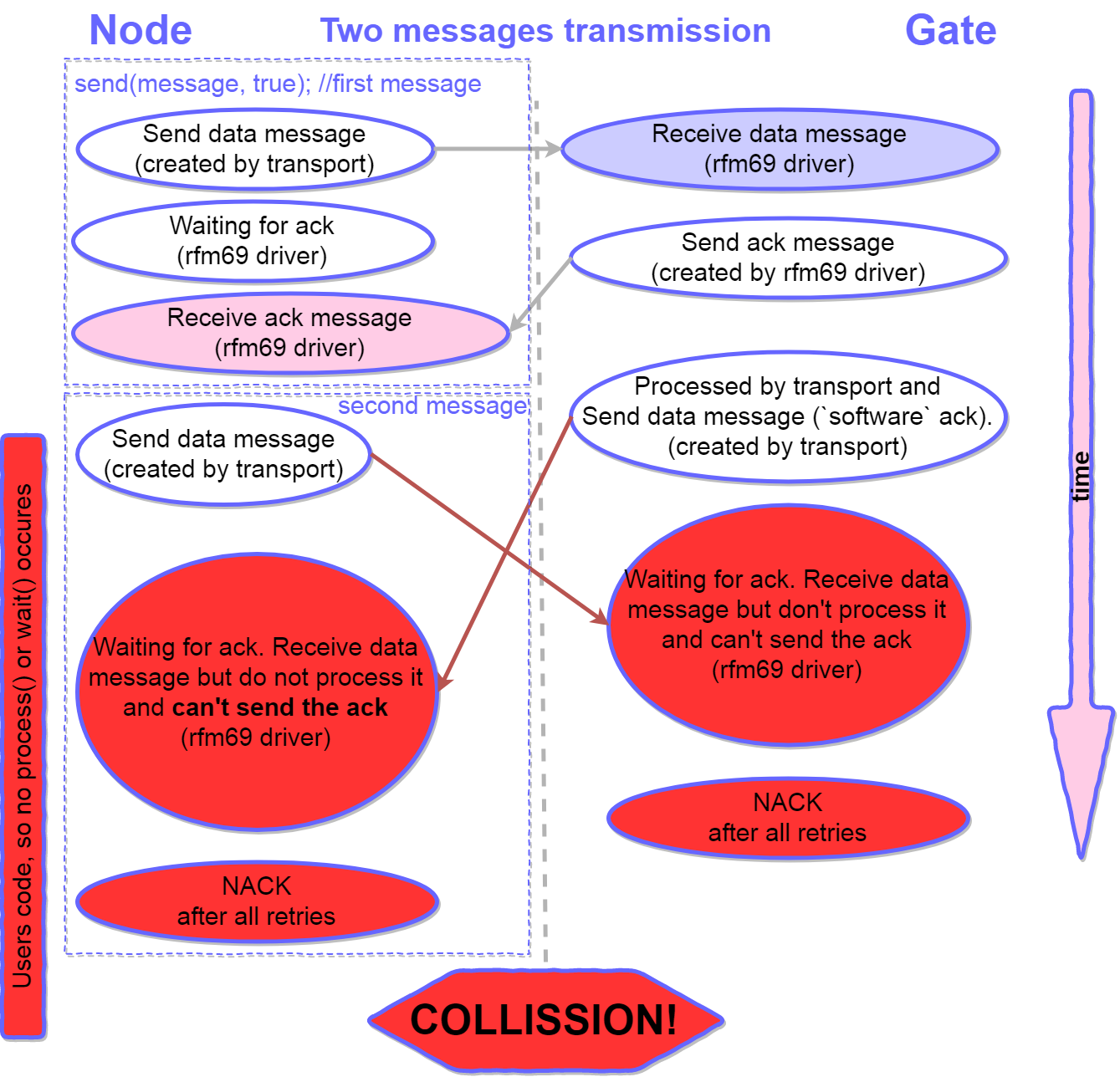

    Now we can imagine a more complex case. The node sends two messages to the gateway one by one.
    send(message2, true);
    Yes this is the same code which I wrote at the start of this topic. So the next diagram describes how it works.
    Oops… The second ACK will break the communication in this case? Yes – 99% it causes the problems. But why is this second ACK needed at all? I am not entirely sure, but I will try to explain my understanding of this second ack (how it should work).
    So this second ACK theoretically can help you know if your message was delivered to the node which is behind the gate. But in real life it brakes the communication.
    How can we fix it? How can we send two messages one by one without collision? I will describe some solutions.
