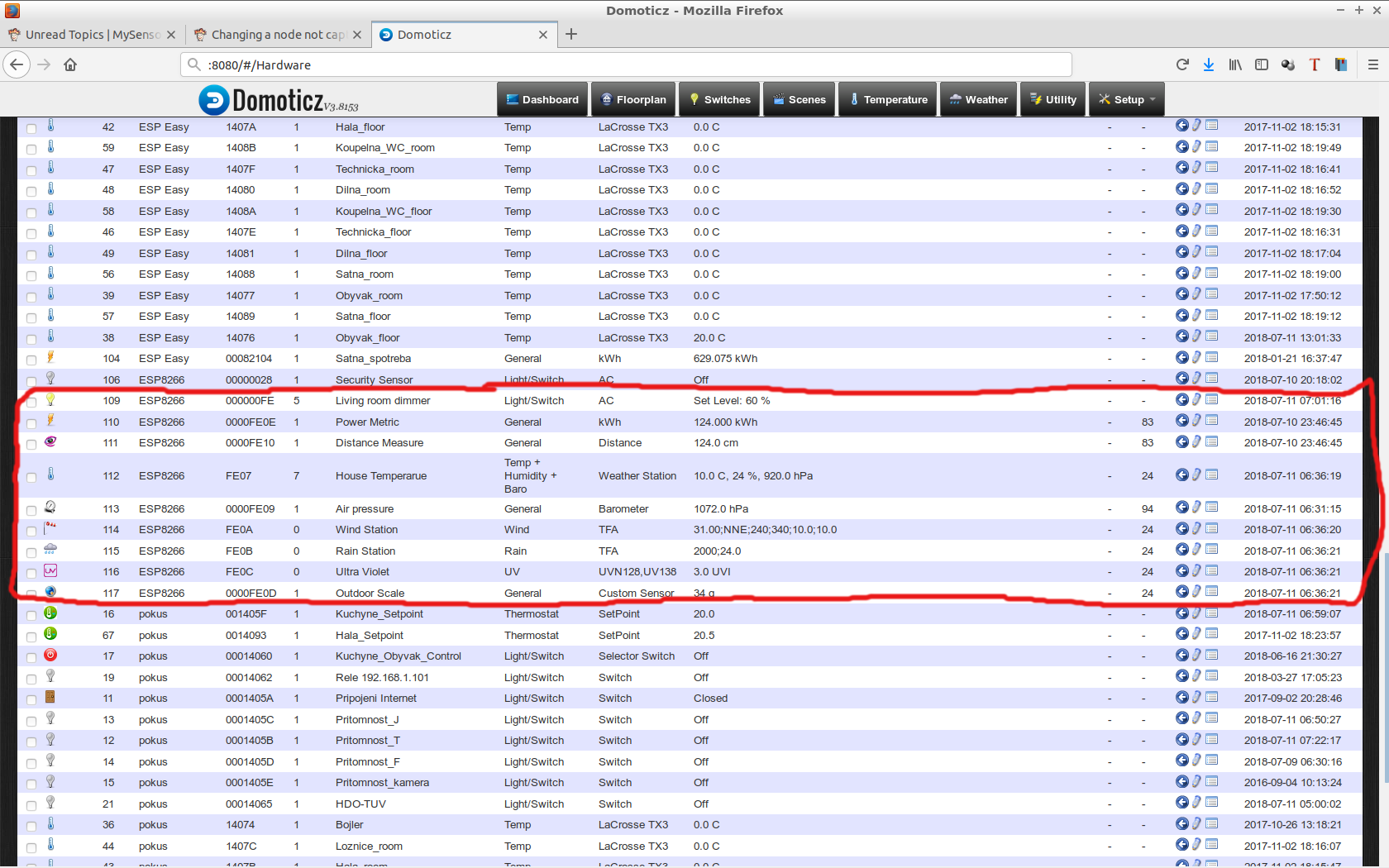

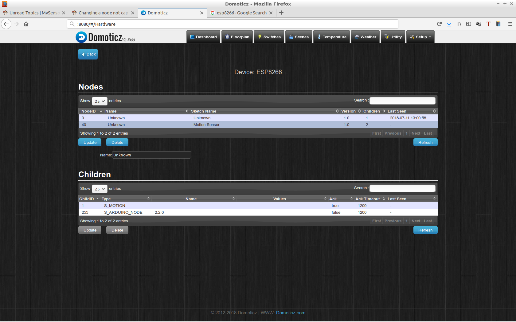

        kimot
        @hakha4
        What mean "don't shows the added relay" .
        Sometimes you do not see your node in "Hardware",
        but in "Devices" child sensors from that node are normally presented.
        No node 254 in list:
        But its sensors are in devices:
