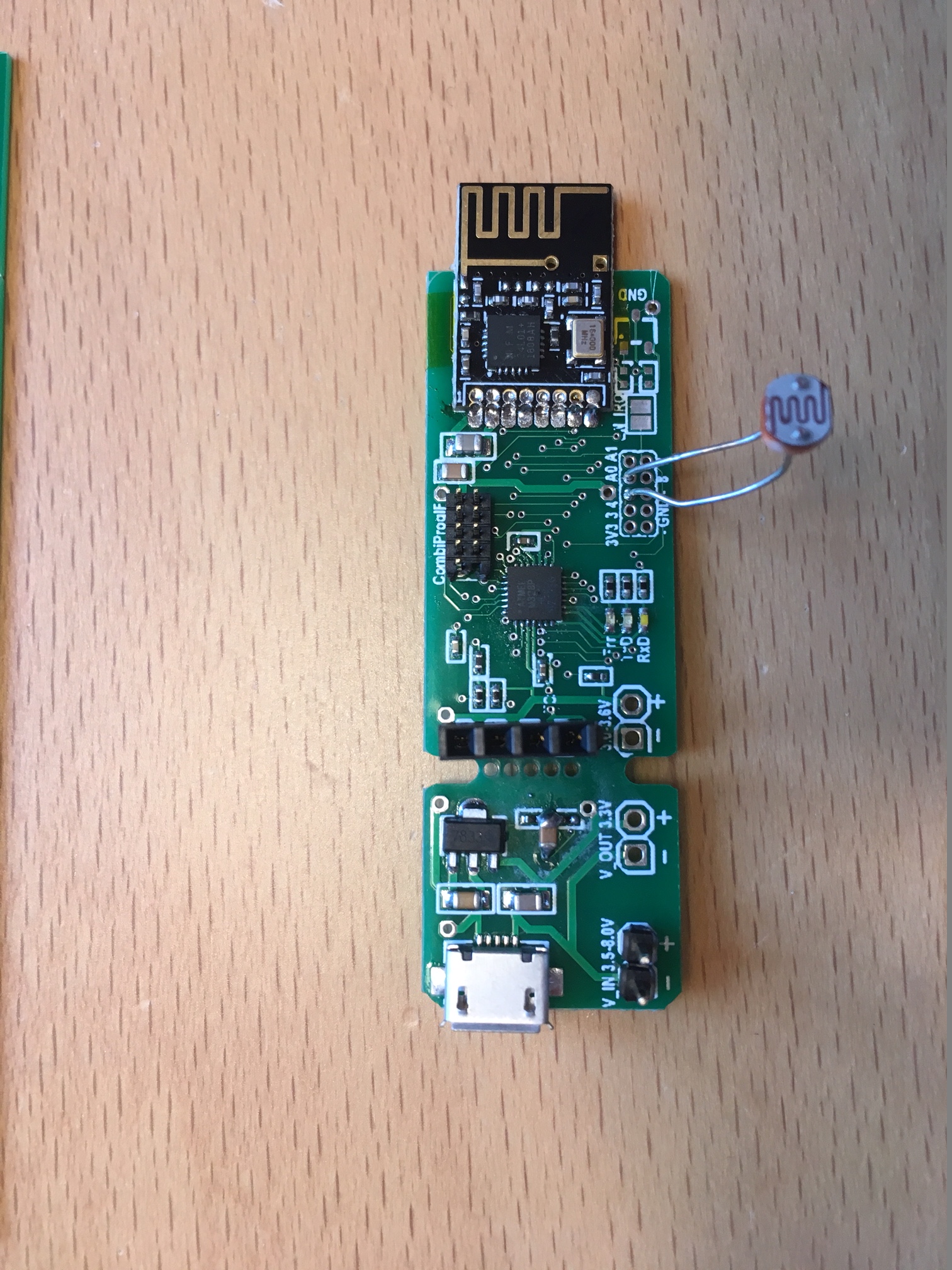

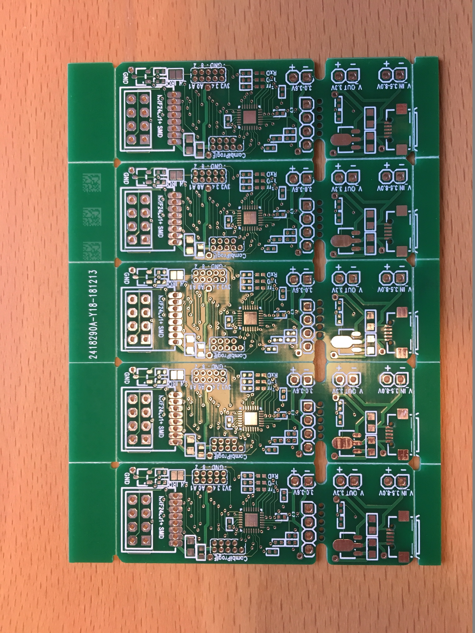

    I have a simple question regarding the MY_SOFTSPI functionality. I designed my own pcb for a Sensebender Micro derviate that is utilizing a ATMEGA328-MMH chip (the 4x4mm SMD version) and mainly 0402 SMD parts.
    Here some impressions:

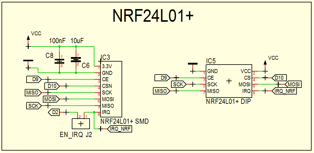

    The PCBs are equipped with both footprints for the DIP and the SMD version of the NRF24 modules. However, I made a stupic mistake when wiring the SMD footprint and swapped the MISO and SCK connections.
    Here the thing (grrrrrr):
    The Issue
    I hoped to resolve this stupid mistake with these lines of code to swap the connections again:
    #define   MY_SOFTSPI
    #define   MY_SOFT_SPI_SCK_PIN    12
    #define   MY_SOFT_SPI_MISO_PIN   13
    #define   MY_SOFT_SPI_MOSI_PIN   11
    ... but it doesn't work out.

    If I unsolder the NRF24-SMD version, plug the DIP version in (edit: and modify the code so that the hardware-SPI is used again), it is working instantly.
    So my guess is that it is not possible to use the native SPI pins as softSPI pins. Is this correct?
    Regards from cold Germany,
    Marco
    • S Offline
      scalz
      wrote on last edited by scalz
      never tried this way, but I don't see why it wouldn't work. it's software spi..
      Maybe show us your sketch, and add this define, so you can check in logs which pins are really used by the radio driver
      #define MY_DEBUG_VERBOSE_RF24
      imho, hardware spi is always preferable, so I would have fixed it the other way, like cutting traces and soldering thin wires to get it working again

        Moreover, I tried to re-programm an otherwise well-performing node (one with a DIP NRF24) by adding these lines to the program:
        #define   MY_SOFTSPI
        #define   MY_SOFT_SPI_SCK_PIN     13
        #define   MY_SOFT_SPI_MISO_PIN    12
        ... and i got identical errors. So it really might be a limit of the softSPI to not use the hardware SPI pins.
        And considering the hint with the manual rewiring: Well, yes, I would consider this for one board but I want to deploy between 15 and 20 of those boards in our flat for varios types of sensors. I guess if software can't fix it I would bite the bullet an order a new PCB pile.
