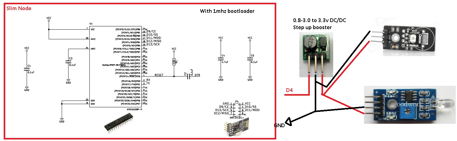

    I just started with arduino and mysensors and I would like to share my first steps (re)building my broken uv-sensor.
    I bought the orignal TS704 UV sensor about two years ago. A few weeks ago it stopped sending acurate UV readings. On lots of placesa on the internet there are complaints abouts this sensor and the relative short lifetime. Main reason I think is water leakage in the sensor. I didn't want to buy a new one because the problem would be back within 2 years and they are realy expensive at the moment (about €70).
    Then I found the mysensors site in my quest to fix my broken device and my first sensor project was born!
    I ordered the pieces I needed and started to build.
    First the gateway, connected to domoticz which was easy as I connected it directly to the raspberry pi using the pigatewayserial software. Antenna directly connected to the Pi so no Arduino board needed!.
    Changed tty TTY_NAME := /dev/ttyMySensorsGateway to tty
    TTY_NAME := /dev/ttyUSB30 in the makefile because Domoticz cannot use ttyMySensorsGateway.
    After that It was easy to add the serialgateway to Domoticz!
    upload-e224b990-a645-4097-a509-02e4a7273ae3
    my list:
    Arduino pro mini 8mb 3v
    UVM-30a UV sensor
    NRF24L01+ 2.4GHz Wireless Transceiver
    TS704 UV sensor housing including 2xAA batery compartment
    Used the default sketch with pin A0 instead of pin 3 (http://www.mysensors.org/build/uv)
    On my breadboard I had things up and running quite easy but the readings were strange. Even at night there was UV light measured. The problem was a mismatch between the intructions on this website about the out pin to use and the one mentioned in the sketch. Sketch showed pin A0 as OUT but website showed pin 3 as OUT.
    @hek has confirmed that A0 is the correct pin. Website will be updated. (is updated now)
    I was mislead because with nothing connected to pin A0 it still gives you output data.
    It's also possible to use 3V for the UVM-30A instead of only 5volt I found this in the spec sheet.
    So the stepup from 3 to 5v is not needed I think?
    To get things in the housing I had to desolder the main piece from the UV sensor. Things have gone wrong from here because after that the sensor did not work anymore. Probably fried the sensor?! New one is on its way.
    So I must think of another way to get the sensor in place at the top of the housing. There not enough place so I must be creative and not destroying another sensor!
    I also would like to share a short piece of code I found to test the uv sensors output. This way you don't need to attach all the radio wires to see if the sensor is working.

    At first everything looked fine but it seems that the measurements from my sensor are to low.
    I removed the sensor and did some testing with the above sketch to measure the output voltage on 3.3v and 5v but the results were the samen and to low.
    Does anyone know what can cause this low measurement ? checked the wires. checked the sketch. replaced the arduino board.
    Another broken sensor?

            • GizMoCuzG
              GizMoCuzG
              GizMoCuz
              I dont think it's a Sensor issue, rather a sketch issue....
              I bought 4 UV sensors, and also experiencing this.
              It could be that we need to multiply the value we send by 10 ? Or we need to do some magic after the analogRead call
              From what i understand the analogRead returns a value between 0-1023
              1023 stands for the maximum voltage that can be read on this pin, and equals VREF
              [Source](5 volts (on 5V Arduino boards) or 3.3 volts (on 3.3V Arduino boards))
              So if we use 3.3V on the arduino, then 1023 stands for 3.3V
              We go back from the digital value (0-1023) to voltage with:
              Source
              int sensorValue = analogRead(A0);
              float voltage= sensorValue * (3.3 / 1023.0);
              The above sketch is using mV, so we need to multiple the voltage by 1000
              float voltage= sensorValue * (3.3 / 1023.0) * 1000.0;

                        My UV sensors is complete!
                        (I have not recieved any case yet - so using a electronic box and a plastic bag :+1: )
                        Its a dual UV and light sensor (LM393 Light Sensor), running om my EasyPCB and 2xAA batteries.
                        First I had some problems with power consumption about 1500uA. This was caused by the light sensor and i removed all leds and what I could with the digital part. My sollution was to power the light sensor from D3 and put it high and then low before sleep. Now im down to 60uA. Also had some interferance with my booster and that worked out great by adding a 0.1cap between out and gnd.
                        Having some issues with measuring batteries and analogread. There is a correct reading on the input on the atmega328 pin (about 0.9v) but still get -80% when using analogread. Must be a faulty atmega chip.
                        My code: (Combined of @GizMoCuz and MySensors)

                            @sundberg84 You mention that you have an ATmega328.
                            In your sketch setup() function you set the reference voltage value:
                            analogReference(INTERNAL);
                            According to the Arduino Language Reference pages, [https://www.arduino.cc/en/Reference/AnalogReference](link url)
                            , on an ATmega328 that will set the analog reference value to 1.1V.
                            Any 10-bit sample taken by that ATmega328 will spread 1.1V out over 1024 values. In your code, you do the calculation using 3.3V as the AREF. That will produce 3 times smaller samplevalues as intended.
                            I see quite some people using code derived from the UV-example-sketch.
                            The code is a bit tricky, and in my opinion: not correct.
                            *) In your own code, you convert samplevalues to mV values: Very good. That should be done. The example does not do that.
                            *) The piece of code that returns the UV-index does this:
                            for (i=0; i<12; i++)
                              if (voltage <= uvIndexValue[i]) {
                                UV=float(i); break;
                            It returns a value that is 1 index too high. (try it: 317 mV will return UV=2).
                            But later a fractional part of the UV-index is calculated, which corrects the initial (too high) value:
                            //calculate 1 decimal if possible
                            if (i > 0) {
                              float vRange = float(uvIndexValue[i] - uvIndexValue[i - 1]);
                              float vCalc = voltage - uvIndexValue[i - 1];
                              UV += (1.0f / vRange) * vCalc - 1.0f;
                            At first glance it looks like the value UV will even get bigger (UV+=something), but it turns out that always a negative number is added to UV.
                            (1.0f / vRange) * vCalc - 1.0f is always negative. So something is subtracted from the initial value UV.
                            It's a bit counter intuitive...
                            I've seen other people's projects where they removed the fractional/decimal part from their code (unlike your code). Their sensors will therefore always be interpreted with a full 1 UV-index value too high.
                            *) Correct me if i'm wrong, but the example code calculates a UV-index with a one-decimal precision. But the value sent to the gateway, is sent in 2 decimals. Wouldn't it be enough to do:
                            send(msgUV.set(UVindex, 1));
                            Here are bits of my own code. I use the Arduino map() function to calculate the decimal for me.
                            Perhaps others find it easier to read too.:
                            const int UV_threshold[12] = {50, 227, 318, 408, 503, 606, 696, 795, 881, 976, 1079, 1170}; // in units of mV
                            const float SAMPLE_TO_MV = (1.1*1000)/1024;  // mV per sample-resolution
                            uint16_t UV_index;        // the UV index
                            uint16_t UV_index_f;      // the fractional part of the UV index
                            // determine the UV index
                            if (UV_value < UV_threshold[0]) {
                              // too low value  or
                              // invalid value (sensor is wrongly connected? => always 0)
                              UV_index = 0;
                              UV_index_f = 0;
                            } else {
                              for (UV_index=11; UV_index>0; UV_index--)
                                if (UV_value >= UV_threshold[UV_index]) break;
                              // calculate fractional part of the UV-index
                              if (UV_index == 11) {
                                // already at the maximum level;
                                // Displaying a fraction is meaningless
                                UV_index_f = 0;
                              } else {
                                UV_index_f = map(UV_value, UV_threshold[UV_index],UV_threshold[UV_index+1], 0,9);
                                // one decimal, so a number ranging 0 to 9
                            float UV_index_float = UV_index + (UV_index_f/10.0);
                            sundberg84S M 2 Replies Last reply

                              @core_c - looks good! Thank you. Coding isnt my strong side so appreciated you looked at it!

                                      • core_cC
                                        core_cC
                                        core_c
                                        The Arduino language reference says about "analogReference()": Configures the reference voltage used for analog input (i.e. the value used as the top of the input range).
                                        To me that means: Any reading you make, after setting the analogReference once, will use the same reference.
                                        So, if you are unsure, or if you want to be sure,.. Just set the analogReference before taking any new sample (for another sensor).
                                        If you have ANY other sample to make, from -some- device, and you know what maximum voltage it will return (that is: the voltage that is to be sampled),.. set the analogReference to the best fit, and then make the sample. Just be sure that the analogReference value can at least hold the maximum voltage to be sampled. In other words: If you have some device that outputs (say) 2 Volts, it will be incorrect to set the analogReference to 1.1V, because the input voltage could be higher than the reference voltage (and you can never sample values that exceed 1.1V).
                                        Once the sample has been taken (and you have your 10-bit sample), you just have to know what that sample represents.
                                        If, in your code, you never set the analogReference at all, the default input signal can be up to 5V. With a 10-bit sample resolution (1024 possible values), that means: 5 Volts / 1024 steps = 0.0048828125 Volt per sample-step. You can still sample voltages of 1 Volt,.. no problem.. but over an analogReference set to 5V, the maximum samplevalue is just a fifth of what could fit in 10 bits. In other words: The precision you measure will go down by a factor of 5.
                                        Because i know from the datasheet that the UVM30A will always produce a maximum voltage of 1 Volt, i set the analogReference to a value that fits best. It turns out that analogReference(INTERNAL) is quite good for sampling voltages that never exceed 1 Volt.
                                        In your case: If your battery reports greater voltages than 1.1V, simply set the analogReference to DEFAULT (5V) before taking a sample from the battery.
                                        I just checked the Arduino Reference: It seems not possible to put a voltage greater than 5V on the AREF pin. I have no experience with measuring battery voltages (yet). But i know the Arduino can be powered with more than 5V.
                                        What i want to say is: If you would have a sensor that outputs 2.3 Volts maximum, you could put 2.3V on the AREF pin of the Arduino, set analogReference(EXTERNAL), and make samples that are prefectly suited for that sensor.
                                        • core_cC core_c
                                          sundberg84S
                                          sundberg84S
                                          @core_c - Woaw! Thank you! I really appreciate your help, effort and great explanation here!
                                          This made me understand how it works and now I understand what I made wrong. I will take my UV sensor down this week and upgrade it.
