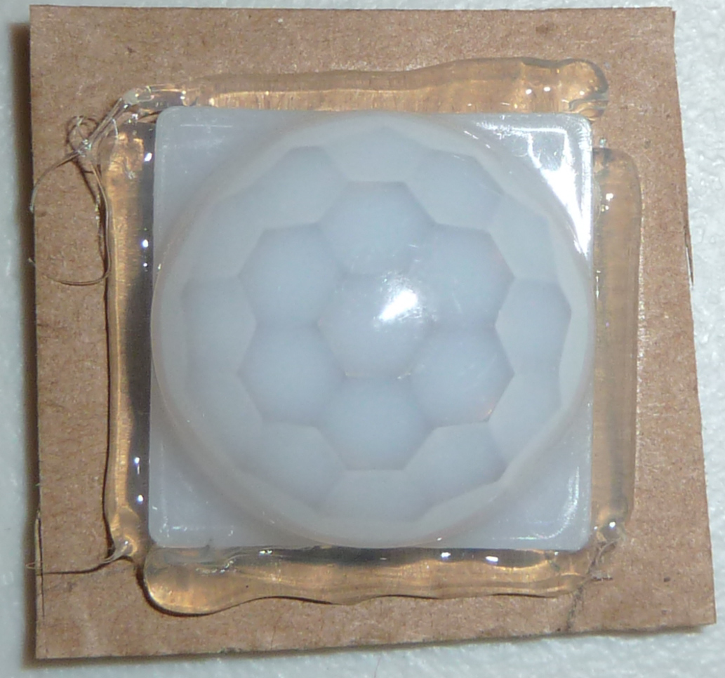

            I just received my samples of the AM312 and ( @gohan as promised) my observations/ measurements. (which are not in line with @acp observations above)
            1. Rock stable. Even if I use the on-board regulator to also power a MySensors node it does not get into trouble (fires only when supposed to)
            2. The hold-time is as specified in the datasheet 2.3 seconds
            3. Power consumption: 14.2 µA! when idle 15.4 µA when active.
            4. These boards can handle anywhere between 3.3 and 12 V power (ldo on-board).
            5. I won't be using any of the small or modified HC-SR501 or similar BISS0001 based sensors anymore. These typically have 4 times higher power consumption/ very sensitive to all kinds of power and environment noise/ large/ but adjustable (can live with that and handle in software).
            0_1493902794635_upload-93dc9758-648f-4ba2-a14c-5c2f95666b5d

              @AWI
              Thanks for your post! What type of detection range are you getting out of it? i.e. within what range can you reliably detect motion?

                @AWI - Could you see what happened below 3.3v? Ie, using 2xAA ?

                      @NeverDie It looks like its in specification. My "lab" is not that big... I could easily detect around 5 meters through the open door ;-)

                        @sundberg84 I turned the voltage down to 2.6V and it was still fully functional. Did not test noise sensitivity (disassembled the test set-up) The sensor is specified to 2.7V, the LDO (HT-7530) has a typical voltage drop of 100mV in normal operation.
                        Seems to be very small (< 5mV) when Vin is below 3V.
                        Conclusion: looks good for 2AA alkaline.:ribbon:
