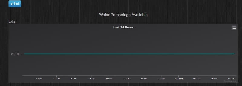

              @CrankyCoder Averaging the readings may not give very good results when using ultrasonic sensors. You will be better to try newpings built in median filter. I have used it in this water tank level and have found it to be ok for my tank.

                There was a project that used a waterproof sensor in a round water tank and it seemed quite accurate in the measurements

                        @CrankyCoder said in Rain Barrel Sensor:
                        Looks like one of the versions of your code you are polling every 15 seconds. That still your interval?
                        Yes I poll every 15 seconds and update only if there is a change, then every 15min i poll and post the results regardless of he result. This keeps the node showing as live in domoticz. I also only use the percentage as the trigger for a level change, this allows for a bit of variation before a change is recorded.
                        You can see in the graph for the last 24hrs that it remains static.
