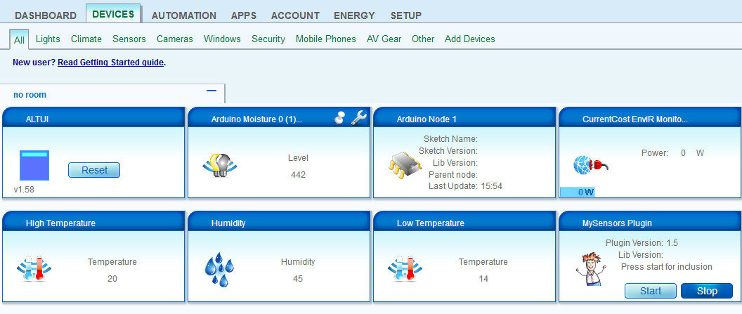

    I have built my first sensor (moisture sensor) and gateway.
    With a simple sketch the value displays correctly in the Vera device.

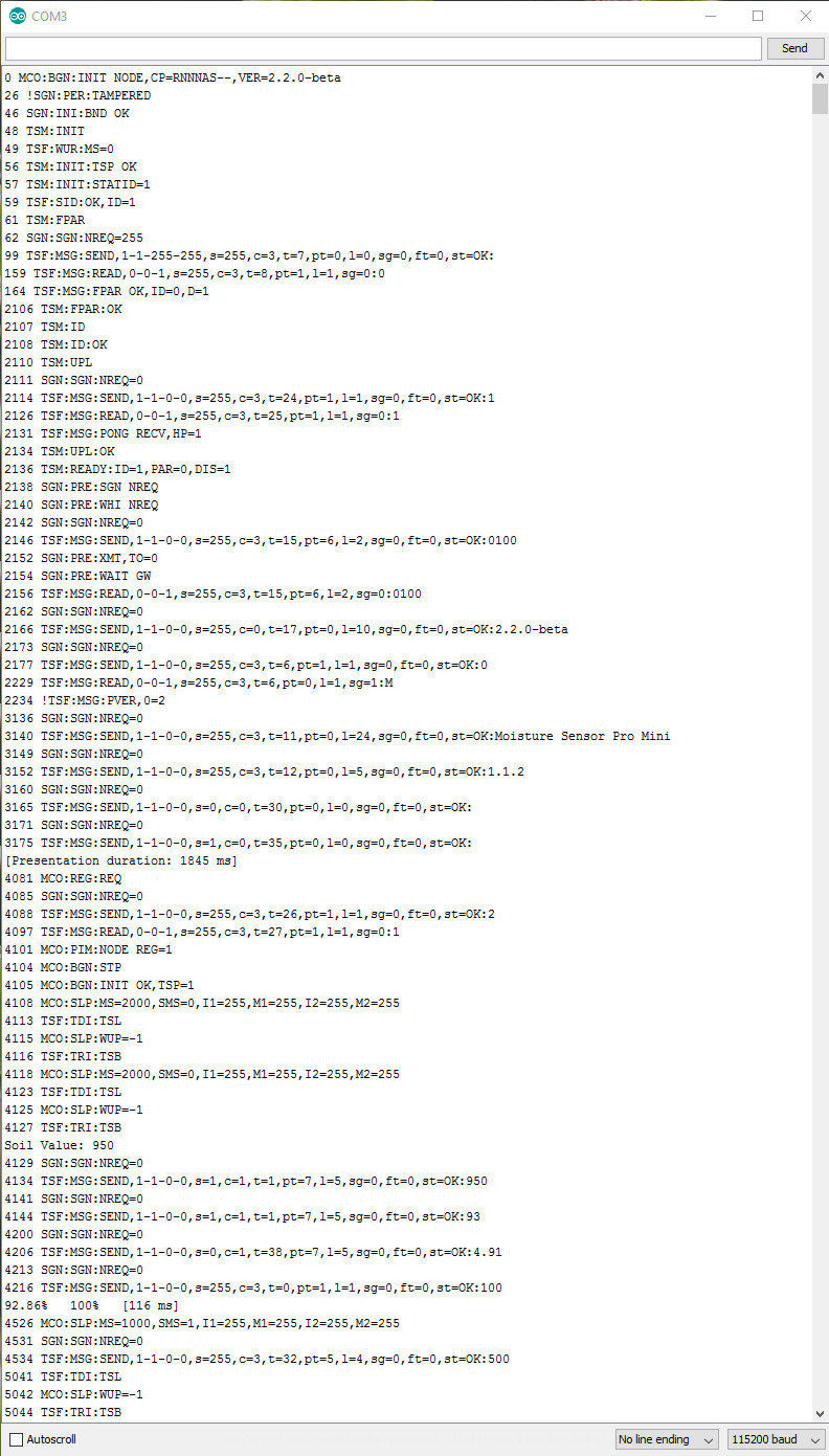

    Debug output

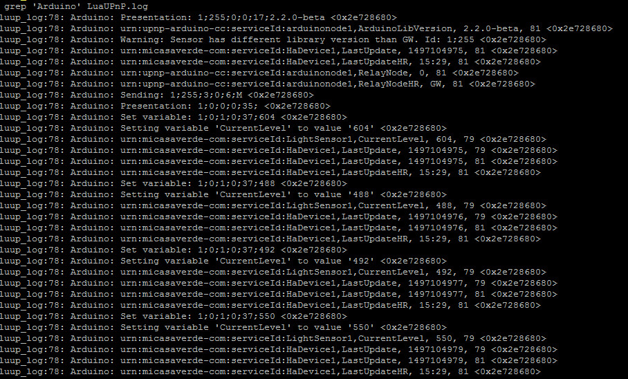

    Vera grep log output

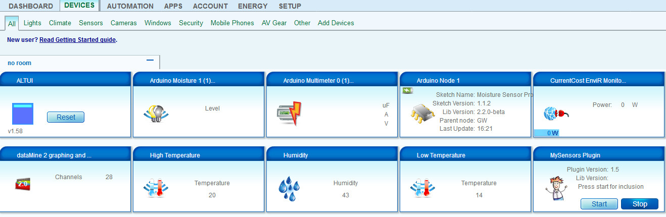

    However, when I move onto the sketch I want to use everything works except the moisture value does not display in the Vera device.
    Debug output

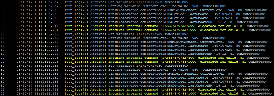

    The variable value is getting to the Vera device as it shows in the device advanced tab
    Vera 3 UI15
    IDE 1.8.2
    MySensor library 2.2.0 - beta
    I have removed the sensors and gateway multiple times, reloaded Vera multiple times. To no avail.
    Any suggestions welcome.
    • W Offline
      W Offline
      Woodside
      Solved:
      Vera does not have a dedicated moisture device, S_MOISTURE is implemented as a Light Sensor (Ref)
      MyMessage msgMoisture(CHILD_ID_MOISTURE, V_HUM);
      is therefore incorrect and results in no value being shown in the device.
      For Vera this has to be
      MyMessage msgMoisture(CHILD_ID_MOISTURE, V_LEVEL);
      The level is now showing in the device
