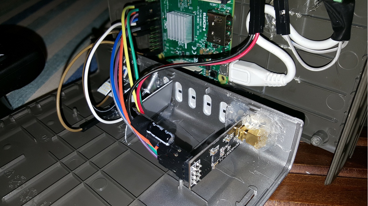

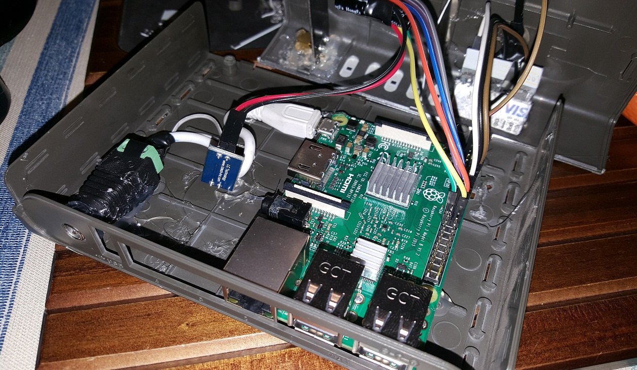

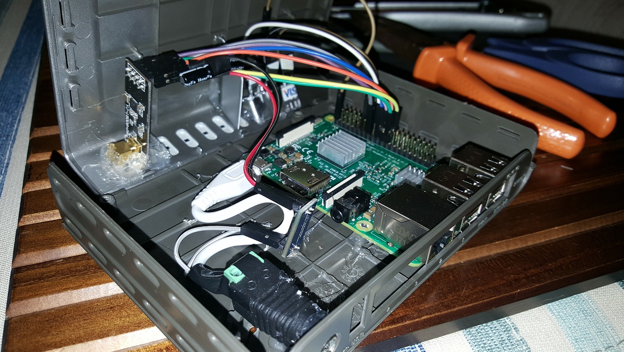

RPi3 GPIO MySensors Gateway + LEDs + LNA Radio + DLink enclosure

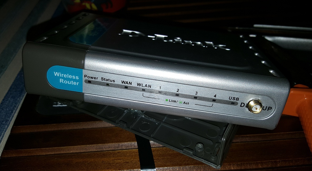

 Project built based on an old D-Link router enclosure. It is a Raspberry Pi 3 running Home Assistant with a RPi GPIO Gateway. Dedicated power supply for the radio, wired through a 5v to 3.3v regulator from the 3A 5V power supply.

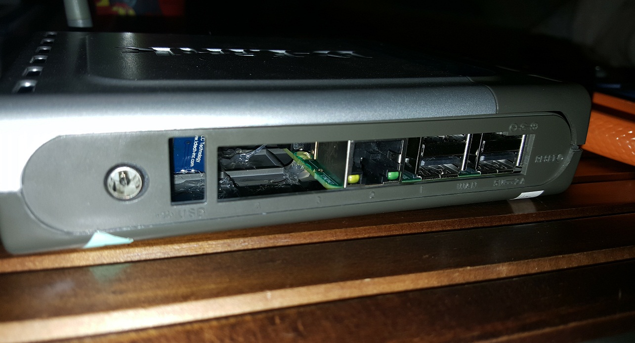

 Ethernet and 2 USB ports available for connections.No soldering.
 Easy to build with some Hot Glue... took me 3 hours.
