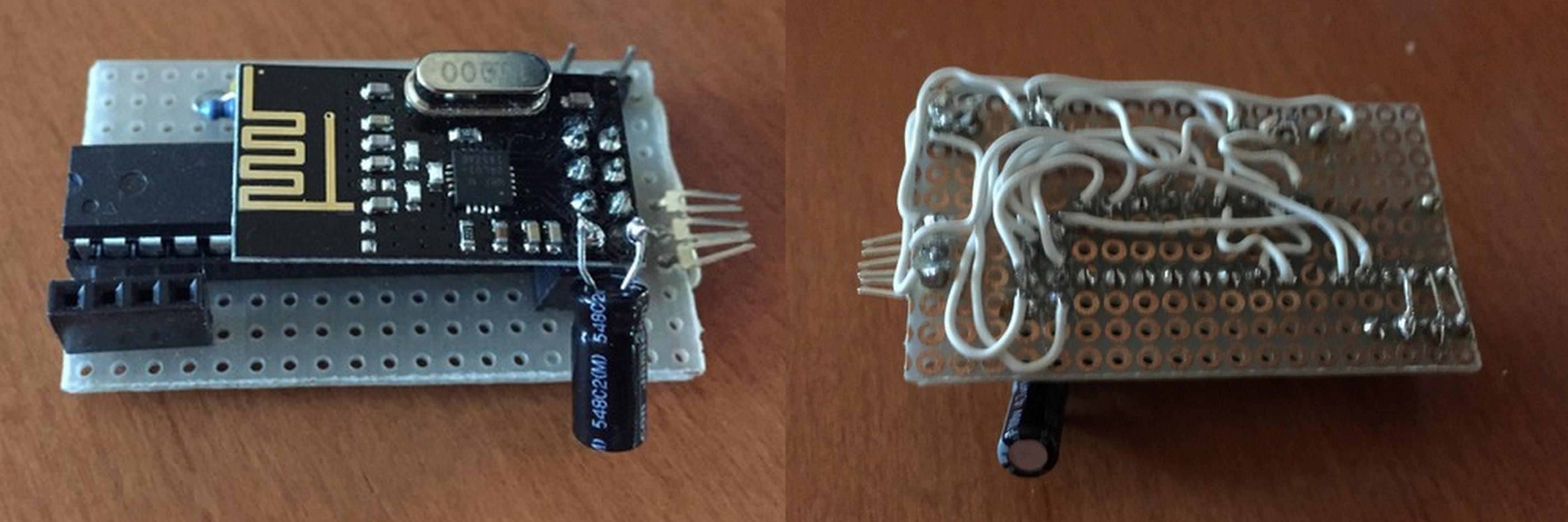

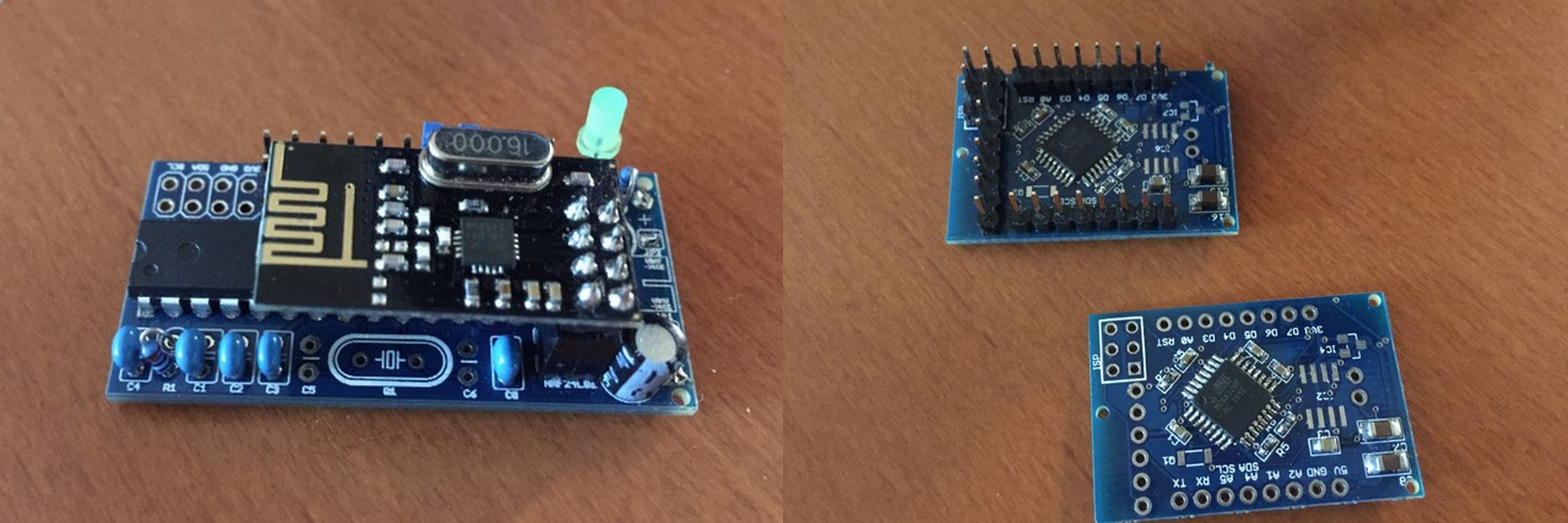

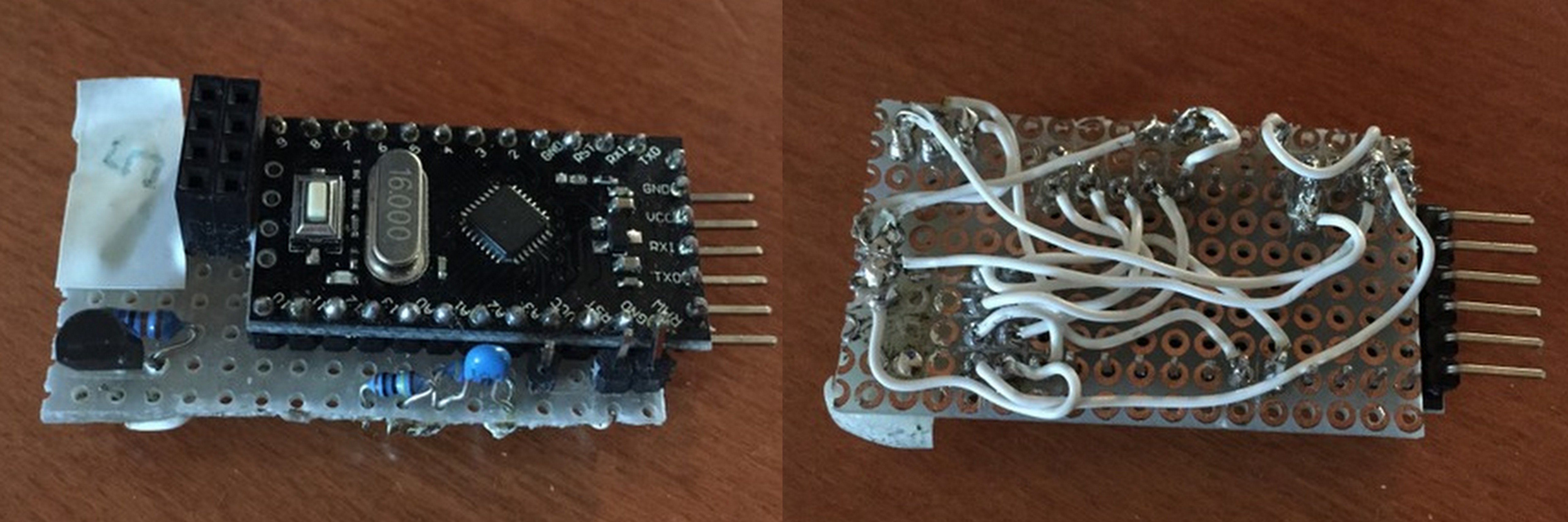

    I have found MySensors some 8 months ago when looking for some informations how to make my old wired termostat wireless. I was really happy when I found this project and understood it. Since Im hobbyist and DIY guy but had no big experience with electronics, it was (and still is) lot of learning and reading. But that's fun.
    With a great help of informations from MySensors sites and forum I was able to move myself from these:
    to these:
    and to these:
    Last ones are own boards inspired by:
    • Gert Sanders - Battery based atmega328p sensor,
    • Stanley - MySensors D1 mini, and
    • tbowmo - Sensebender Micro.

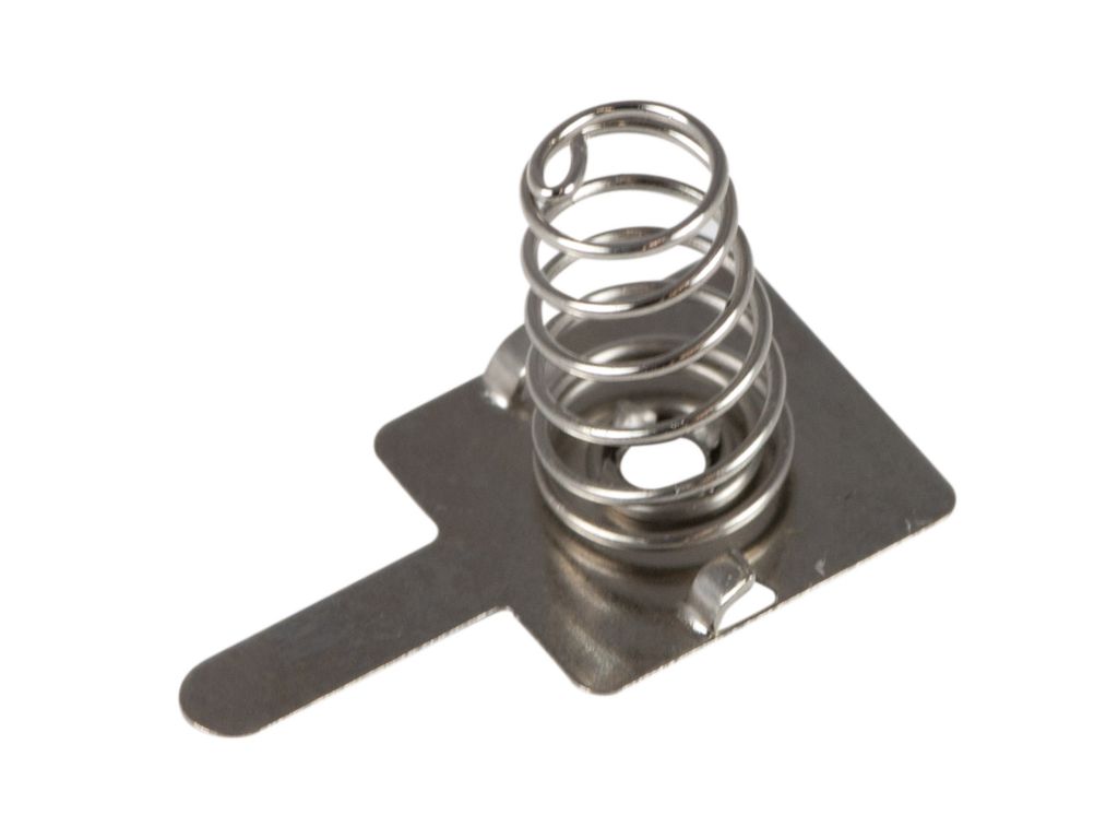

                    My PCBs are 50x25mm, inner dimensions of the box are 59x32mm,
                    Yes battery holder is 3D printed too, used with this
                    0_1508680640965_pctdetail.819-131.1.jpg.
                    I will look for STLs and upload it here soon.
