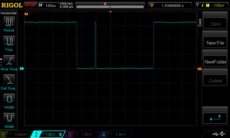

          @NeverDie Maybe the CE pin is stuck high?
          N 1 Reply Last reply

                @Yveaux said in trick to using CDEBYTE E01-ML01DP4 (nRF24L01+ PA module)?:
                Is CE active low or active high? Using the mysensor's transport, I did these scope shots on the CE pin:
                So, as you can see, CE is spending most of its time HIGH, except when it's supposed to be transmitting (or so it would seem). Isn't this the opposite of what's desired? Should CE be generally LOW, but during the transmission phase, have it go HIGH?
                • N Offline
                  N Offline
                  Sorry for the false alarm. Apparently the pins on these Ebyte modules are thinner than others, and the electrical connection was weak. So, using soldered connections appears to fix the problem.
