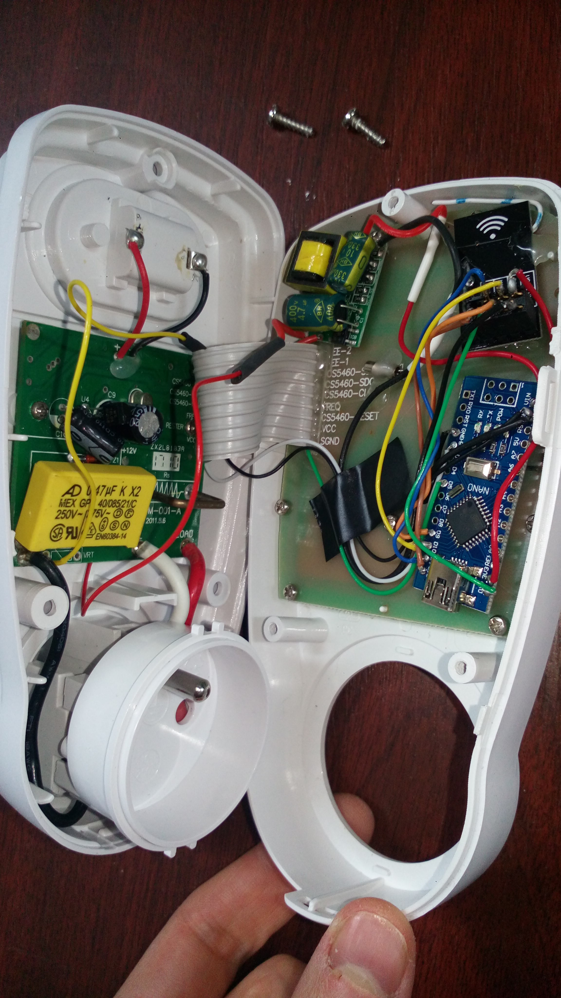

    I would like to use Karl's work on the hack of an energy power meter socket:
    http://gizmosnack.blogspot.fr/2014/10/power-plug-energy-meter-hack.html
    and add a mysensors node to retrieve the values in Domoticz.
    I bought this one: https://www.amazon.fr/GreenBlue-GB202-consommation-dénergie-wattmètre/dp/B00E5BONDU/ref=sr_1_2?ie=UTF8&qid=1510248821&sr=8-2&keywords=wattmetre
    It's the same model based on IC CS5460A (datasheet).
    I uploaded the sketch of Karl in a Arduino Nano, and i can read the values correctly by displaying them on 16x2 LCD screen.
    Good news !
    I modified my sketch, and it's OK: the values are read correctly.
    My sketch:

    Schema:
    Note:
    On PCB of energy power meter, there is a regulator L7805, with +12V in input.
    But the step-down power supply (combo condo+resistor with protect diode zener) for PCB is calculated for a fixed and known current.
    Add Arduino and NRF24L01 increase this current and so the values with C+R are wrong for to have +12V (It's more than +12V and diode zener turn on for protect electronics IC).
    So we have to add a small step-down power supply for arduino+nrf24L01.
    /!\ Warning:
    Don't connect the USB port of arduino on PC with the energy power meter socket connected on wall socket: The DC ground is not isolated from the electrical neutral and this causes a leakage current.
    Your differential circuit breaker turns on.
    The solution is to use a serial connection with optocoupler for isolate the 2 parts (arduino and PC).
