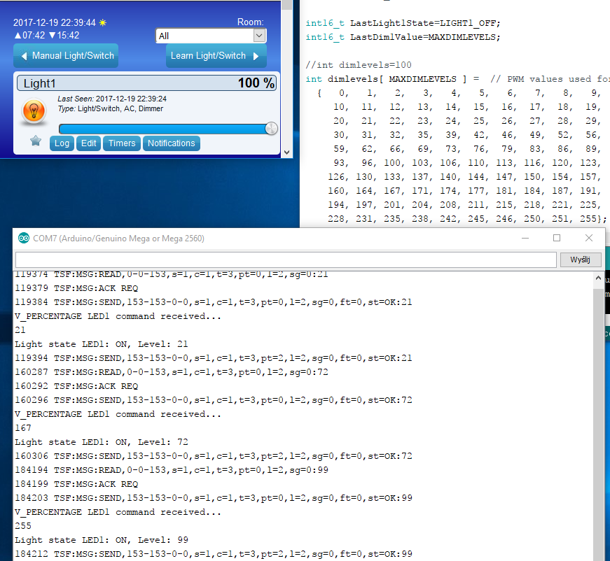

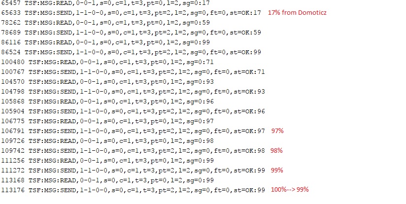

  • Hello Everyone
    Recently I'm fighting with LED dimmer (rookie in programming)
    I got to the point where (with help of @Boots33 - Thank You) I have two different sketches both work OK with saving the last dim status but..... only for 1 LED stripe
    Tried to implement an array as declaration of additional LED pins (there is a topic on the forum https://forum.mysensors.org/topic/4808/dimmable-led-actuator/6 ) but using this method... I finished with..
    1st sketch switching on/off crazy (one button in Domoticz switching a group of lights , some of them not working at all etc.. - >in summarry a mess !)
    2nd I didnt even get to the point of few leds - because there is already an array which is a little confusing for me
    Q1: Could somebody please have a look on both and advice which one is potentially (better written , less giving problems with multiple pins, I should focus on ?) and help me with declaration of extra pins ?? ( basically I'm trying to use all the PWM pins from Arduino Mega)
    Q2: There is already an array in 2nd sketch for the dimmer but I am not sure how it works and why somebody went this way (definition of maxdimlevels and dimlevels array) ??? is it possible to get rid of it ?
    Configuration - RPi, Domoticz, Uno Gateway + nrF24, Sensor node nrf24 connected to Mega , mosfets in breadboard (not soldered at all - so no damage) , external 12V for Mosfet Ledstripes -->7,5V Arduino , for testing purpose 6 led stripes connected to PWM pins
    (at present disconnected from GND all except 1st one - stripes are very bright and going crazy when not declared in Arduino)
    1st sketch

    2nd sketch based on MySensors generic dimmablelight (modified by me a little using gesture sensor sketch)

    int dimlevels[ MAXDIMLEVELS ] =  // PWM values used for translating home automation dimmer levels. This gives smoother transations
      {   0,   1,   2,   3,   4,   5,   6,   7,   8,   9,
         10,  11,  12,  13,  14,  15,  16,  17,  18,  19,
         20,  21,  22,  23,  24,  25,  26,  27,  28,  29,
         30,  31,  32,  35,  39,  42,  46,  49,  52,  56,
         59,  62,  66,  69,  73,  76,  79,  83,  86,  89,
         93,  96, 100, 103, 106, 110, 113, 116, 120, 123,
        126, 130, 133, 137, 140, 144, 147, 150, 154, 157,
        160, 164, 167, 171, 174, 177, 181, 184, 187, 191,
        194, 197, 201, 204, 208, 211, 215, 218, 221, 225,
        228, 231, 235, 238, 242, 245, 246, 250, 251, 255 };

    Question to anybody who can help with the last annoying thing
    When I move the dimmer bar in Domoticz to a % value - arduino responds with the same % (for example 21% on the screen from serial monitor attached below)
    BUT
    When I move the dimmer bar to 100% - arduino responds with value of 99 - then it is forcing (sending back an info) to Domoticz and the value on the bar is chaning from 100% (set by me) to 99% forced by Arduino.
    Question WHY ????????? 100% in Domoticz = 99% for Arduino ??????
    Even changing this line
    analogWrite( LED_PIN1, dimlevels[LastDim1Value - 1] );
    and removing the (minus) still the same behavior (but I can see on the monitor I am pulling different values from array which is good)
    PS. I tried to make the array bigger (like 101 cells and additional 255 value - still showing 99)

    I am not sure what do You mean by numbers to percentage.
    I've checked few different led dimmer sketches and all of them behave the same : You move the dimmer bar in Domoticz to 100% but the node receives a value of 99...
    I've put the serial print to see the value (array) which is "delivered" to node.
    I am writing to a LED pin value LastDimValue-1 but printing LastDim1Value which is then displayed next to the text ON,Level: ...
    So again Domoticz bar 100% is displaying here a Level 99 ...
    analogWrite( LED_PIN1, dimlevels[LastDim1Value-1] );
        Serial.println( dimlevels[LastDim1Value] );

  • @plantex What I mean is, you have the numbers 0 to 255, and your percentage value is 0 to 100%. That would indicate to me that the number 255 would equal 100%. Where do you make that conversion? Or do you?

  • @plantex Maybe my brain isn't functioning properly just yet, but wouldn't it be:
    analogWrite(LED_Pin[ledid1-1], (int)(currentLevel1 * 100 / 255) )  ;
    That is what I was talking about as far as a conversion to a percentage.

  • So I'm back
    1st sketch from this topic (with conversion) uploaded to Arduino...and still the same.
    Have a look on my debug: 0_1513801735803_test.jpg
    The last value was a 100% for like 2 seconds - then forced to be 99% and staying like this.
    I don't know , maybe I am trying to get something impossible ?!?

  • Did someone got the idea why 100% in Domoticz is 99% in MySensors? Is MySensors limiting dimmer to 99% or is this caused by Domoticz?
