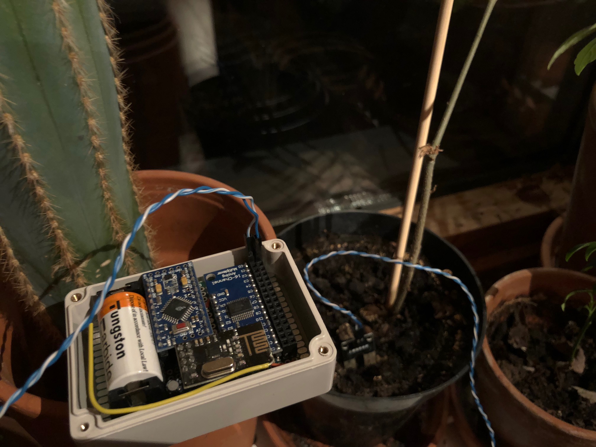

    Back to present day; last week I visited Oskar. He had built a node on a breadboard and it worked great, but when he soldered everything on a protoboard it started acting up so we decided to troubleshoot together.
    This is what the node looked like, neatly tucked into a box.

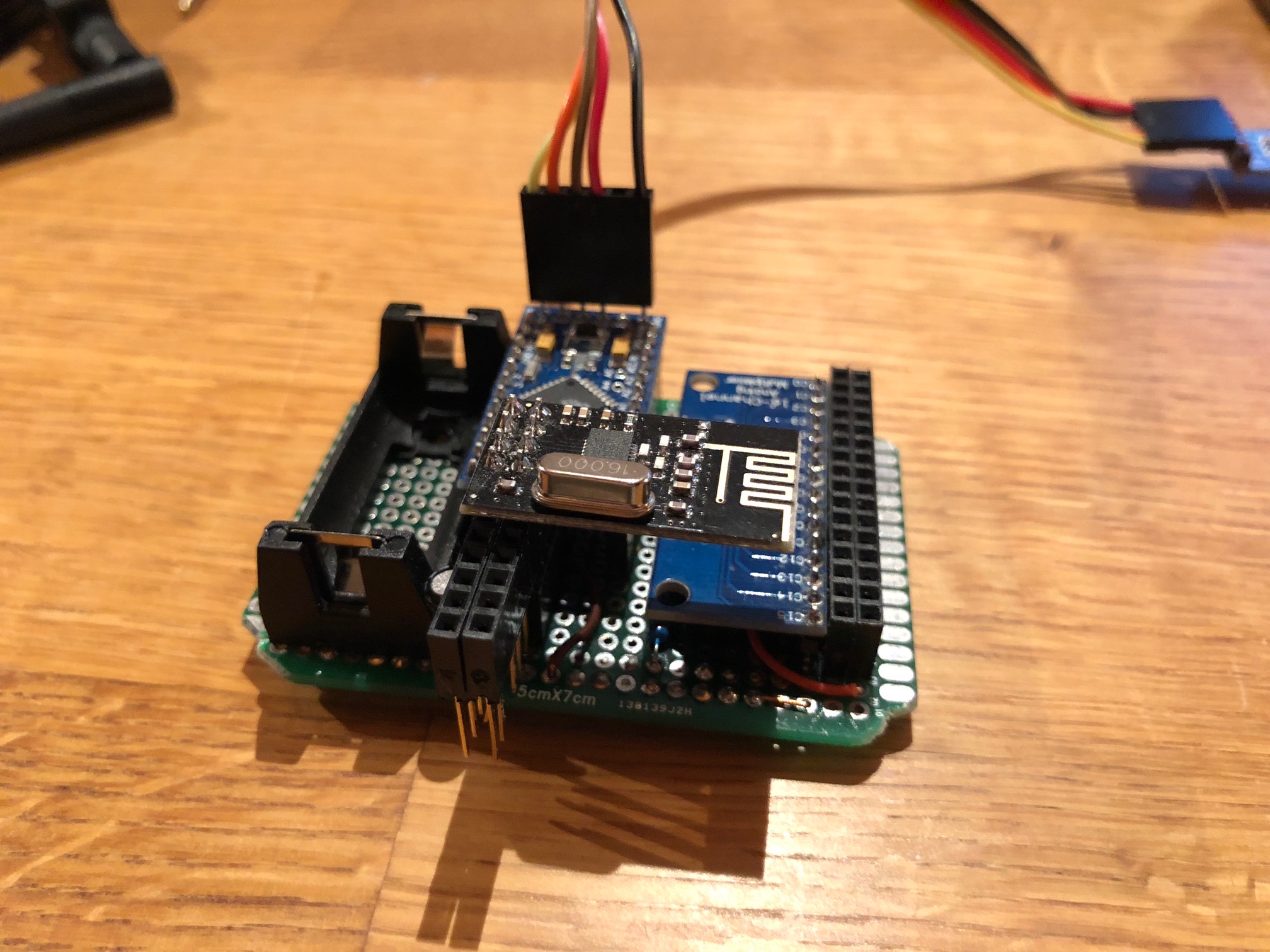

    When I first saw the node, I had noticed that the space below the nrf antenna was a bit tight. Could this be causing the problem?
    We decided to get some extra clearance by temporarily stacking an extra header:
    The node performed flawlessly! Not a single NACK. And this node is designed to monitor moisture of 16 house plants, so it sends 16 messages in quick concession (no delay) every time it reports data.

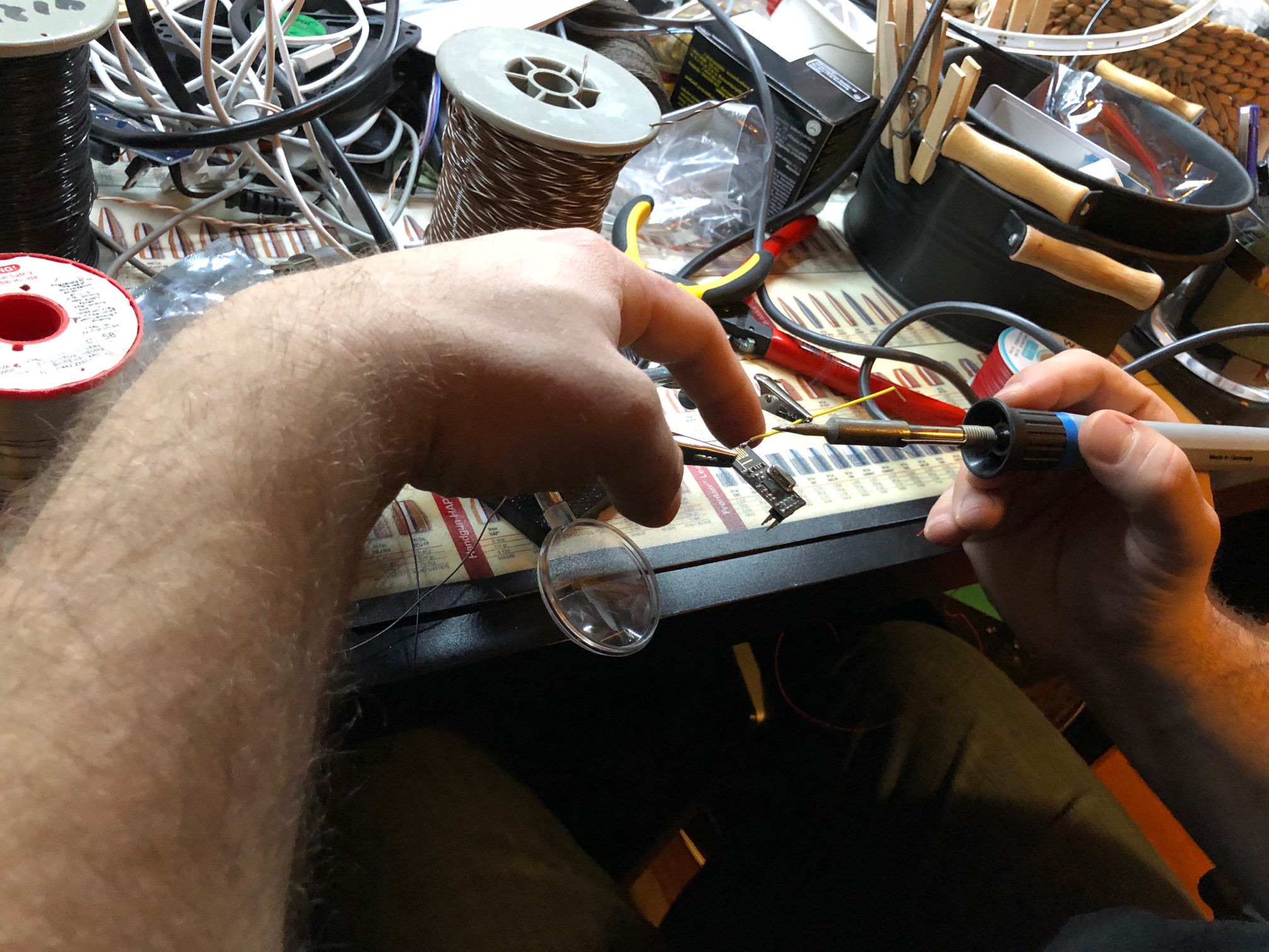

    BUT: With the extra height, the node would no longer fit into the nice little box. Since Oskar likes to keep things nice and tidy, we checked out @petewill's great video on soldering an external antenna to the nrf24.
    But would this be sufficient? The antenna will still pass close to a lot of metal, including the battery.
    We powered up the node and it turned out to work without any problems.
    This is the final result (with one of 16 forks connected):
