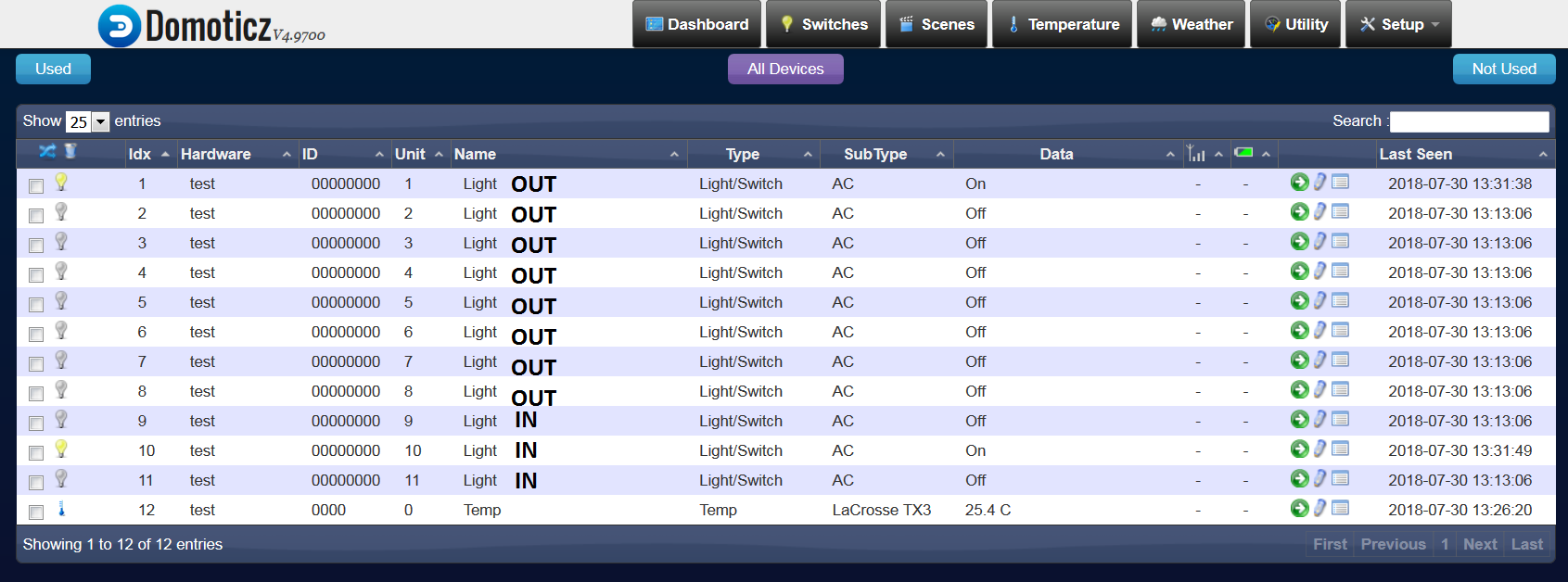

                • P Offline
                  P Offline
                  PDP8
                  Thanks for the comment, I will look at it.
                  Another question, the inputs look exactly like an output in domoticz.
                  I can even switch on the lamp with the mouse. Of course there is nothing happening
                  because it is an input. But it is a bit confusing. Is this a Domoticz setting? Or can I change
                  something in the MySensors code for this? Thanks!

                    rejoe2R Offline
                    rejoe2R Offline
                    rejoe2
                    @pdp8 Despite not beeing familiar with domoticz, this behaviour seems to be logic to me: You presentet a light device, so this typiclly is switchable from controller side.
                    You might either change the handling within domiticz or present a different Child Type (my code uses motion).

                    • P Offline
                      P Offline
                      PDP8
                      Hmm, I've changed it to S_DOOR now. But I still can turn it on and off in Domoticz.
                      I guess this is a Domoticz thing and has nothing to do with MySensors... Weird...

                          T Offline
                          T Offline
                          tsjoender
                          @pdp8 By default Domoticz will add a S_BINARY, S_DOOR, S_MOTION and S_DIMMER (and likely a few others) device in the form of a switchable lamp. You can add it to the active devices and then change the type to be a different device.
                          For example when you create a S_MOTION device, it initially gets added as a lamp in Domoticz, but then you can later change the switch type to be a motion sensor. This changes the icon displayed in Domoticz and also stops you from changing the state.

                            zrom69
                            yes you can change
                            you go on switch press edit after a window that opens
                            you go to Switch Type and you find motion
