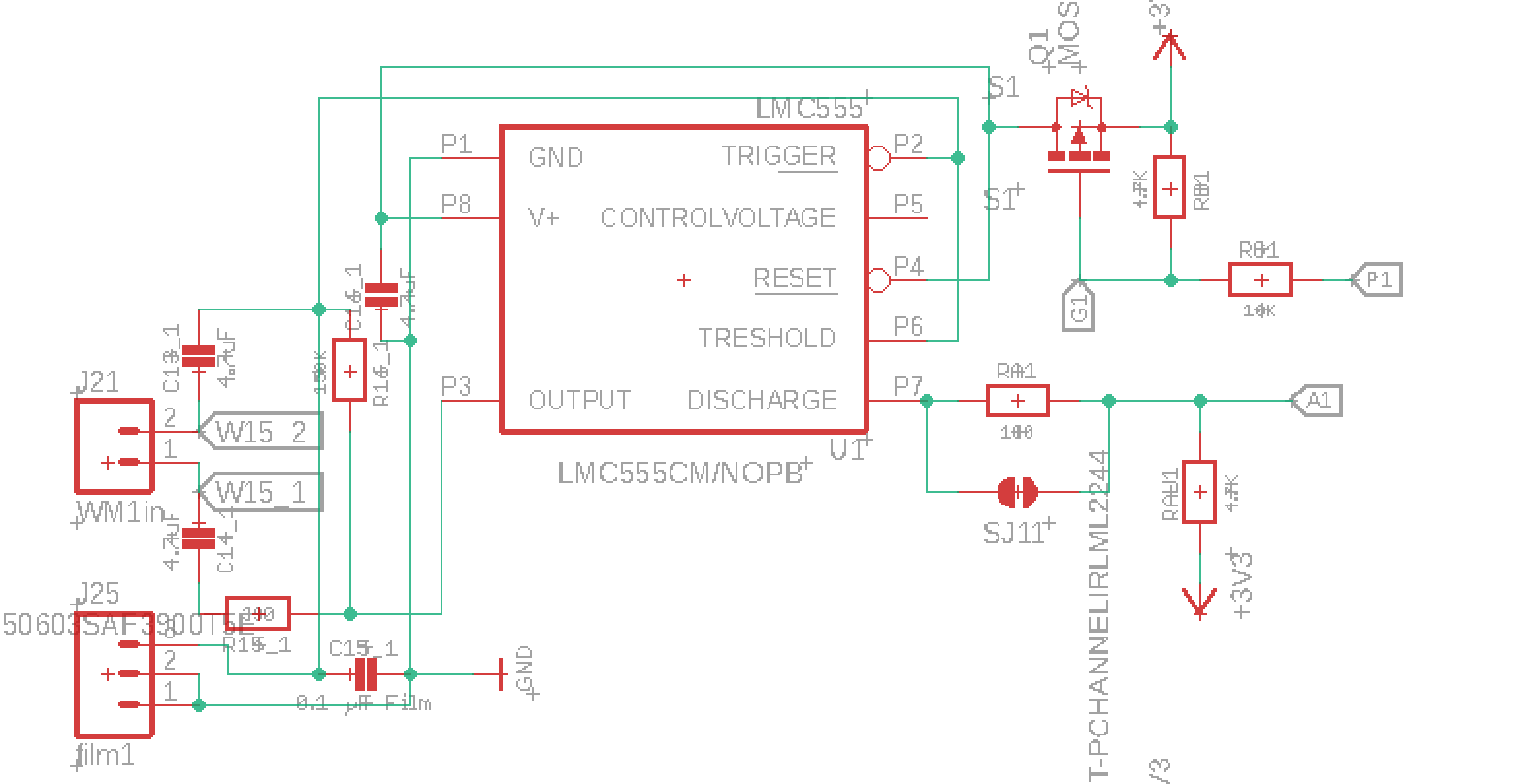

                                  Dear All
                                  I am very sorry for the late reply but I did not give up that project. (I do not get a e-mail when you posted a message. (I will check my preferences).
                                  First I would like to tanks you for all of you suggestion and specially to @AffordableTech for his great proposal.
                                  I have some BME280 and I can use one to measure the room humidity as suggested Paul.
                                  I also red a suggestion to put another sensor on the wall (not into) the wall. I am a bit suspicious about that, because as long as it on the surface of the wall, the humidiity of the room will interfer with the measure of the wall.

                                  here is how I plan to do. I already have a PCB ready for that working with a LMC555.
                                  LMC555
                                  The nails will be connected to the J21. I think, the pair of nails, will be at 2-3cm each other. When P1 is Low, the LMC55 is powered with 3.2V for 2-3 sec. This circuit is designed to have a frequency in response on A1. More the frequency is high, more the zone is wet. More the frequency is low, more the zone is dry. For now, if I can analyse the zone with frequencies, is fine. I will have to adapt my Arduino code of course, but I think interesting to try. On my PCB , I have a LoRaWAN module to send the value to a gateway. Where is the house there is no GSM coverage, Then the gateway will be connected to a neighbour WiFi network. The two house are close, then no issue about distance and transmission. I will get the measure on my server (graph) in real time. That circuit is for Soil moisture, but as the Watermark sensor works with two electrod in a granular sand, I believe the 2 nails could be the two electrond but in a wall. Isn't? I will try it and see if I am a dreamer or nor (laugth). Can it be a good idea?
                                    LMC555

                                    I think your idea of 9 pairs spread across the wall is excellent as the key data you seek is the moisture source and how it progress across the wall.
                                    You can just connect the 9 sensors to one of those analog switch modules and the Feather and start logging data. You biggest problem will probably working out the distance between the 2 nails. Once it setup (in summer), you can make sure they all read the same value by a software 'calibration value' for each pair.
                                    I'd also suggest putting a newer BMP680 device in the room, perhaps 3" to 6 " away from the wall, just to have a temp, humidity and barometric pressure. I don't know exactly what it my tell you, but one thing I have learned is 'data is like money', there is no such thing as too much! (especially when you only get one shot at it a year).
                                    I think your chances of success look good as long as the distance between the two nails give you a sufficient data range.
