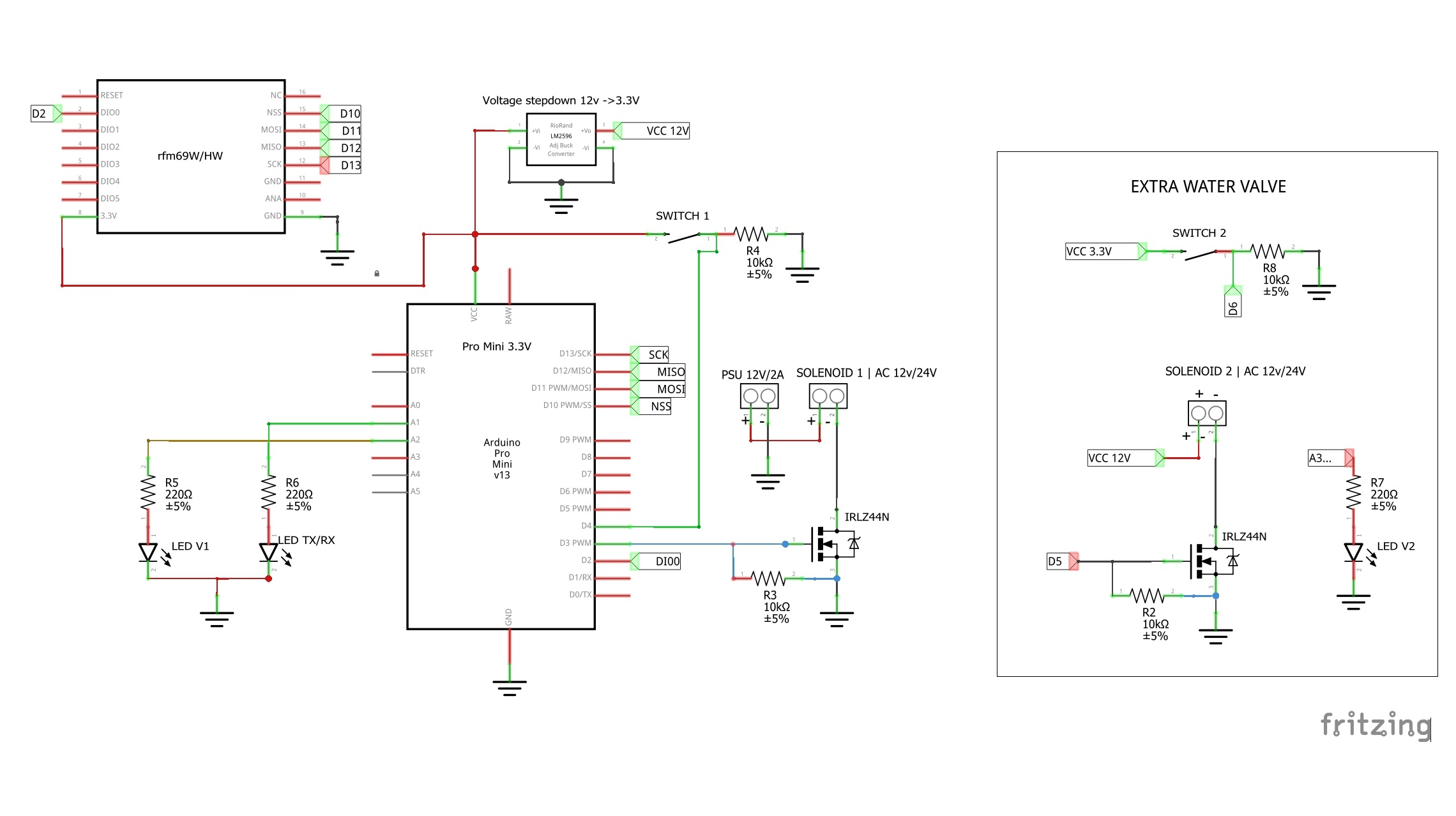

    This project born from a necessity of water my domestic vegetable garden. Lettuces needs water all day and many times I forgot or don’t have time. There are other projects for irrigation but I have special requirements, it’s just one valve and valves that are sold in my country are AC24V for commercial controllers.
    So I build a controller to add to my existing Mysensors/Domoticz network that can handle an AC24V with 12V to 3V volt DC . +/-3 Volts it’s how power this AC24V volts solenoids because AC24V transformers are difficult to find and expensive for what they are(ferromagnetic). And once solenoids(coils) warms up a lot especially with DC,with 3 volt they run cold and its the minimum that my valve requires to stay open.
    How it works?
    Watering can be set on Arduino, 2 times per day ,morning and at evening. Or even once per day.
    Or can be added timers on gateway (my case Domoticz) and everything stays remotely. Personally I prefer have it hard coded on Arduino in case of transmission fail.
    I add a switch (one per valve) to turn it on every time I want and it automatically shuts down on timer that it’s set on code ,in “VALVE_TIME”. 1 hour by default.
    So there this timeout work in any of the timers(switch,gateway or internal timer).
    On code ,I set to “225”(100% or DC12v) on mosfet (IRLZ44N) during 400ms to kick the solenoid to open and then is set to “90” the rest of time to have around 3V on valve terminals. The entire project it’s powered with a standard electronic DC12V/2A transformer that powers the Arduino and the water valve.
    There are 2 leds. One "Valve Power On" and other is TX/RX,note that blink time was slowed down for better understand when is communicating or its just retrying in loop and can't reach the gateway (for example). I have really good result with RFM69H(868mhz) communications. My garden its 40m/50m of my house or GW an never realize that were lost communications.
    What I used:
    Arduino (any 328P), I used pro mini 3.3v because the RFM69
    RFM69H
    LM2596 Voltage step down 12v→3.3V (or equivalent)
    IRLZ44N or any logic level mosfet that work on 3.3V(one per valve that you use)
    x2 leds
    x2 screw terminal (2 wires)
    Push Switch (Normally open)
    Resistors x2 - 10K and x2 – 220ohm
    Protoboard (that green ones from ebay are awesome)
    wire…
    Some thoughts : On my prototypes, I rarely make a dedicated pcb, I use thin ,wire to bridge components on protoboards. They are easy to build and easy to repair or remake in case of some issue. Never had an unexpected shot-circuit. And when my board are outdoor ,I use nail polish or transparent spray paint to cover the entire board. that makes an water prof board. And believe me even ip67 outdoor cases sometimes let water get in.
    This is an example of wiring , of course in this our project we have many less wires :example
    Schematic
    Note: each extra valve(Zone) needs an extra led, switch and mosfet.
    Don’t let your garden dry! :)

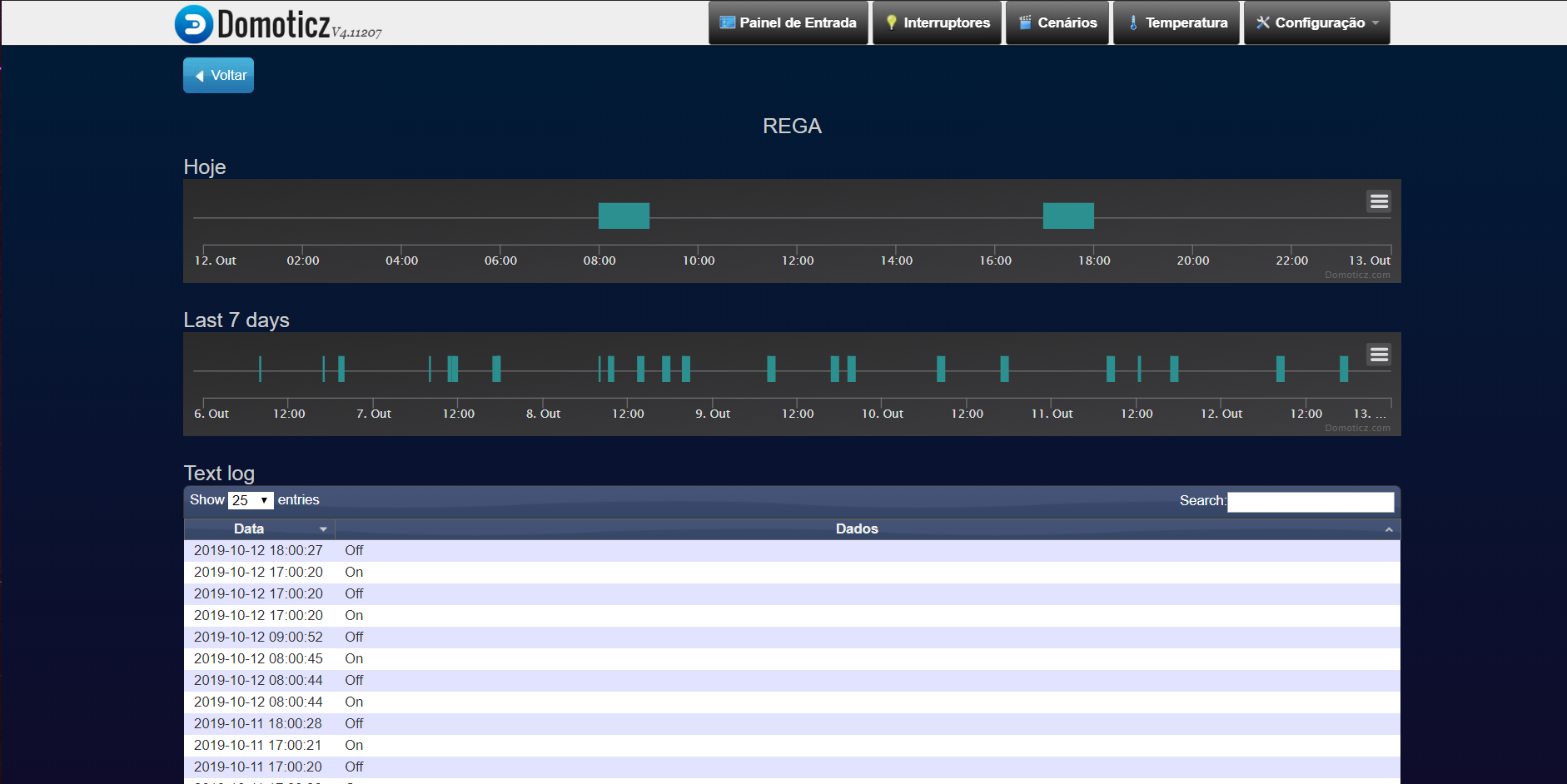

    Todays Domoticz log from this sensors:

      hey @Tmaster
      are you still using this solution?
      have you made any improvements or come across any issues with using it over time?
      TmasterT 1 Reply Last reply
      • markjgabbM markjgabb
        hey @Tmaster
        TmasterT
        TmasterT
        Tmaster
        @markjgabb said in Simple irrigation controller:
        hey @Tmaster
        Hello.still working good exept on winter that was disabled.
        Last summer worked until october without any fail.
        i'm a arduino fan .Even sometimes don't undestanding how to use it :P
