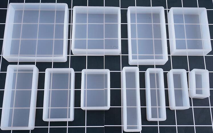

                    • N Offline
                      N Offline
                      Justs a thought, but now that mysensors has FOTA, then for projects which would have, say, 10+ years of battery life anyway, then for very little money one could simply acquire an assortment of silicone molds in various sizes and simply cast your project in polyurethane or polyester or some such epoxy rather than 3D print a box. I know that there's at least one guy, who builds sensors for deployment in wet caves, who has already been doing it for quite a while now. For outdoor sensors, they'd be completely weatherproof, and for indoor sensors, they would simply look cool. You could even get a nice smooth look in the cast object, just as you could with a box printed on an SLA printer.

                          @franz-unix You're right. A few showcased successes is all that ever really punches through the noise. Without that, even companies like Thread, which have enormous resources, simply get fragmented into the noise and never come out of it.
                          Anyhow, what I meant to say, but forgot to provide the links for, is that you can find inexpensive silicon molds already made for just about any shape you'd ever want to print. Ironically, I forgot to provide some linked examples of what I meant by that and how inexpensive they are:
                          https://www.etsy.com/listing/571790663/1pc-cube-silicone-mold-diy-silicone-mold?ref=related-2&frs=1
                          and
                          https://www.etsy.com/listing/631116828/1-piece-squarerectangle-silicone-mold?ref=related-2&frs=1
                          Once you have the molds, all you need to do is pick one that fits, mix-and-pour, and voila. It's the poor man's SLA printer. ;-)
                          None of that would have been practical prior to having FOTA, which fortunately mysensors now has.
                          • N NeverDie
                            berkseoB Offline
                            berkseoB Offline
                            berkseo
                            @neverdie said in Printing enclosures with SLA printers.:
                            What is this technology? Is it possible at home (in the garage:)) to make silicone molds? Have a description of the production process, an article or a video?
                            N 1 Reply Last reply

                              • berkseoB berkseo
                                N Offline
                                N Offline
                                @berkseo
                                I'm pretty sure this link will answer all your questions: http://fabacademy.org/2019/labs/oulu/students/perttu-piirainen/assignments/week10/
