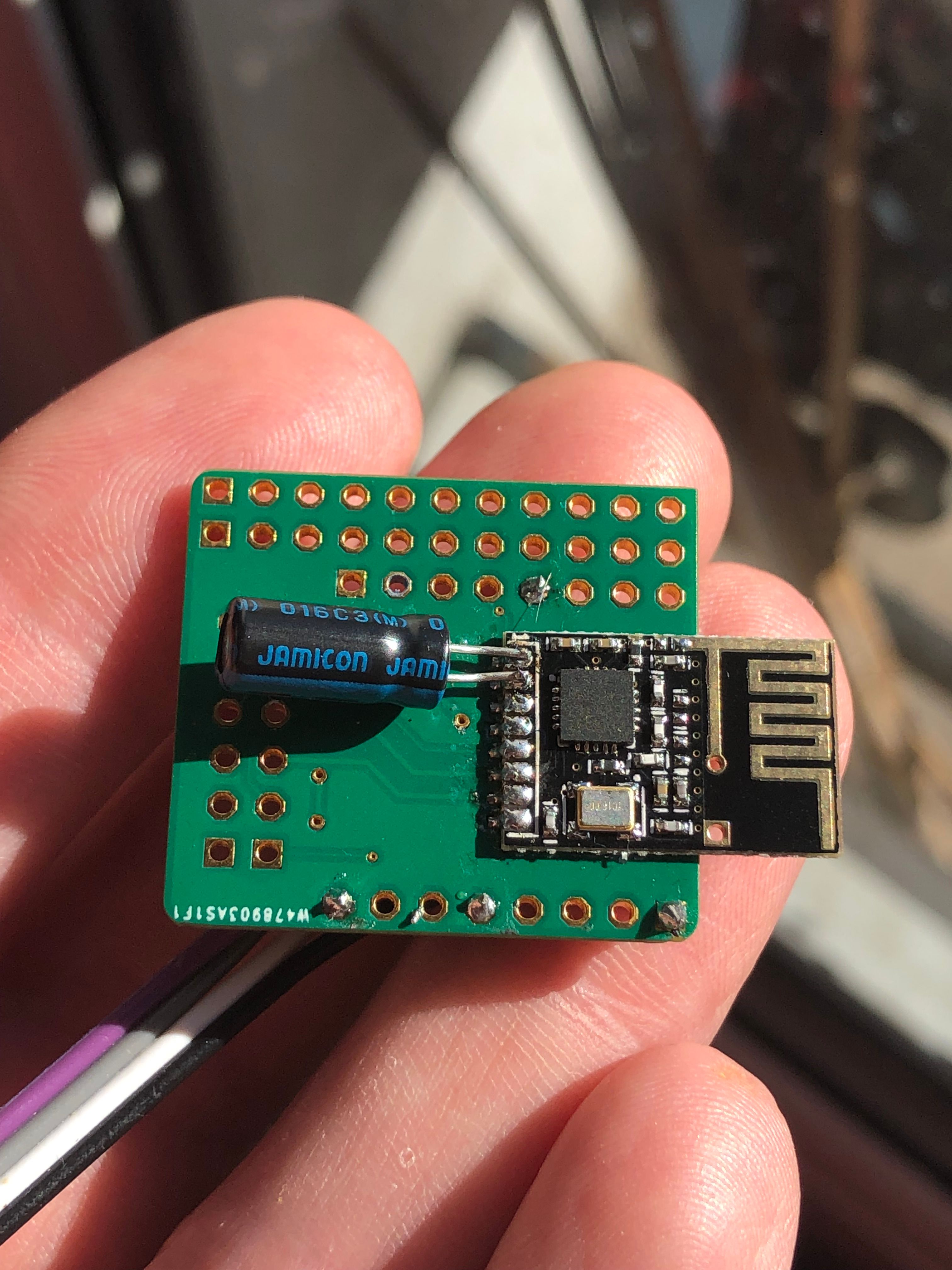

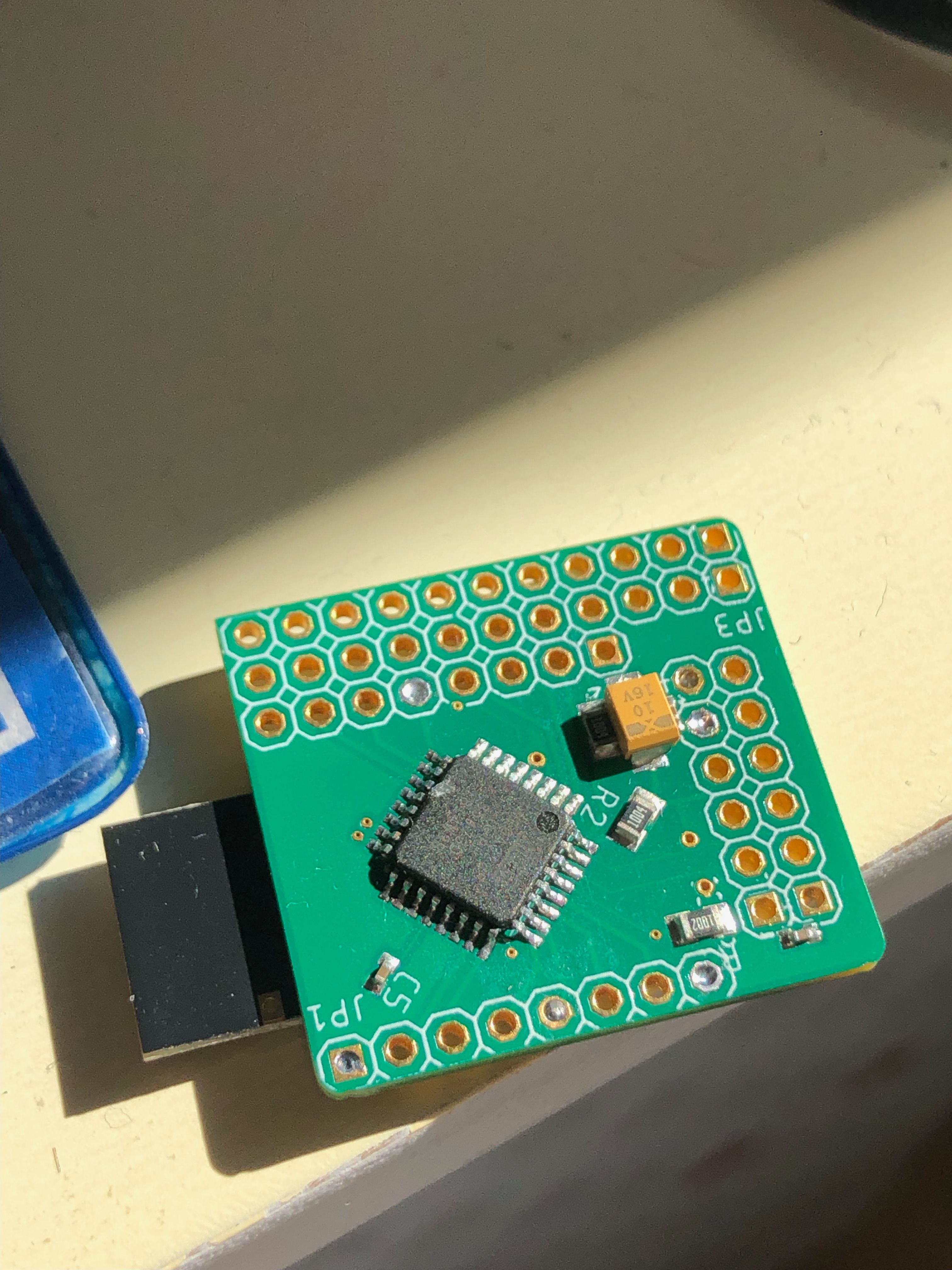

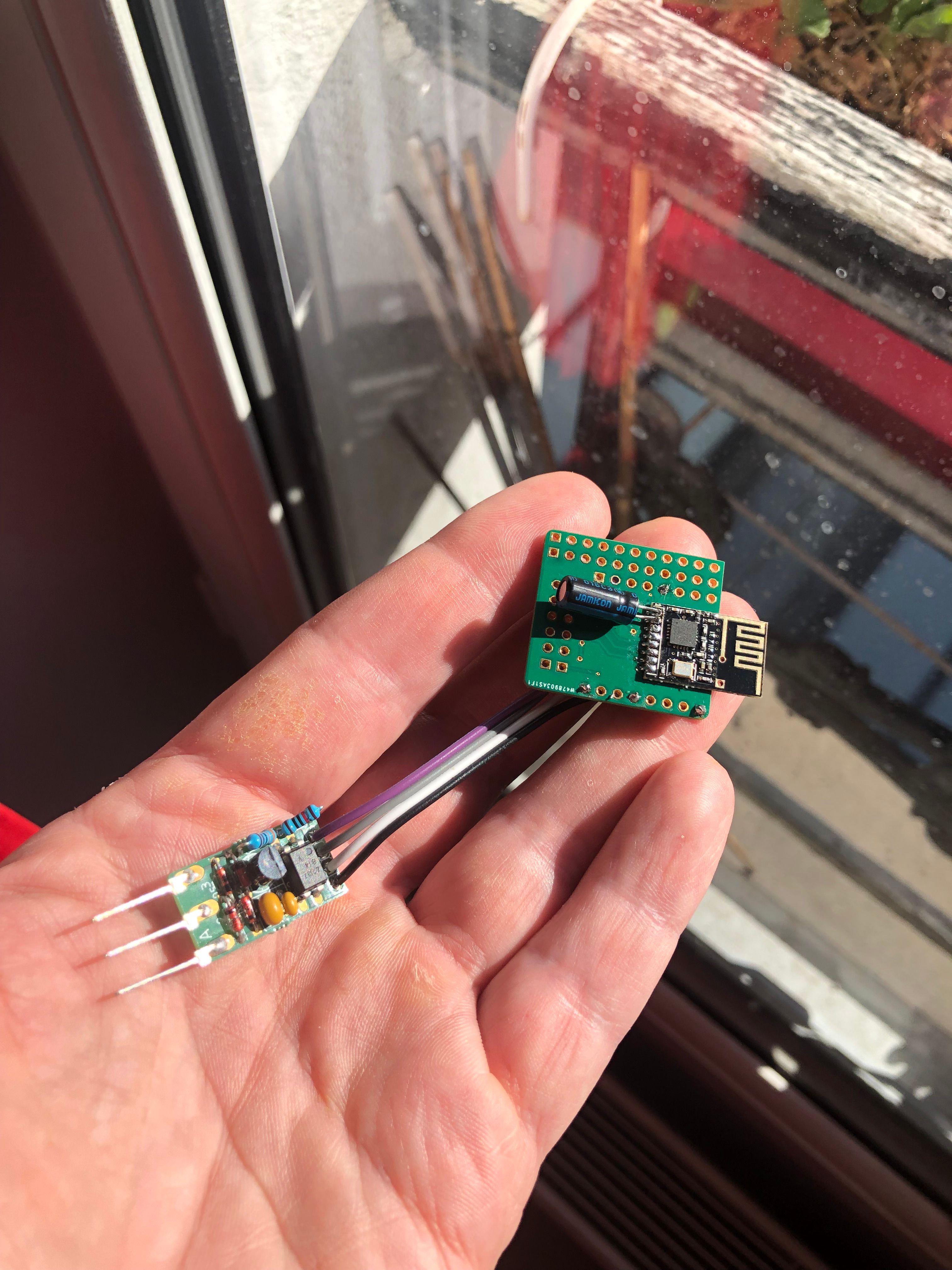

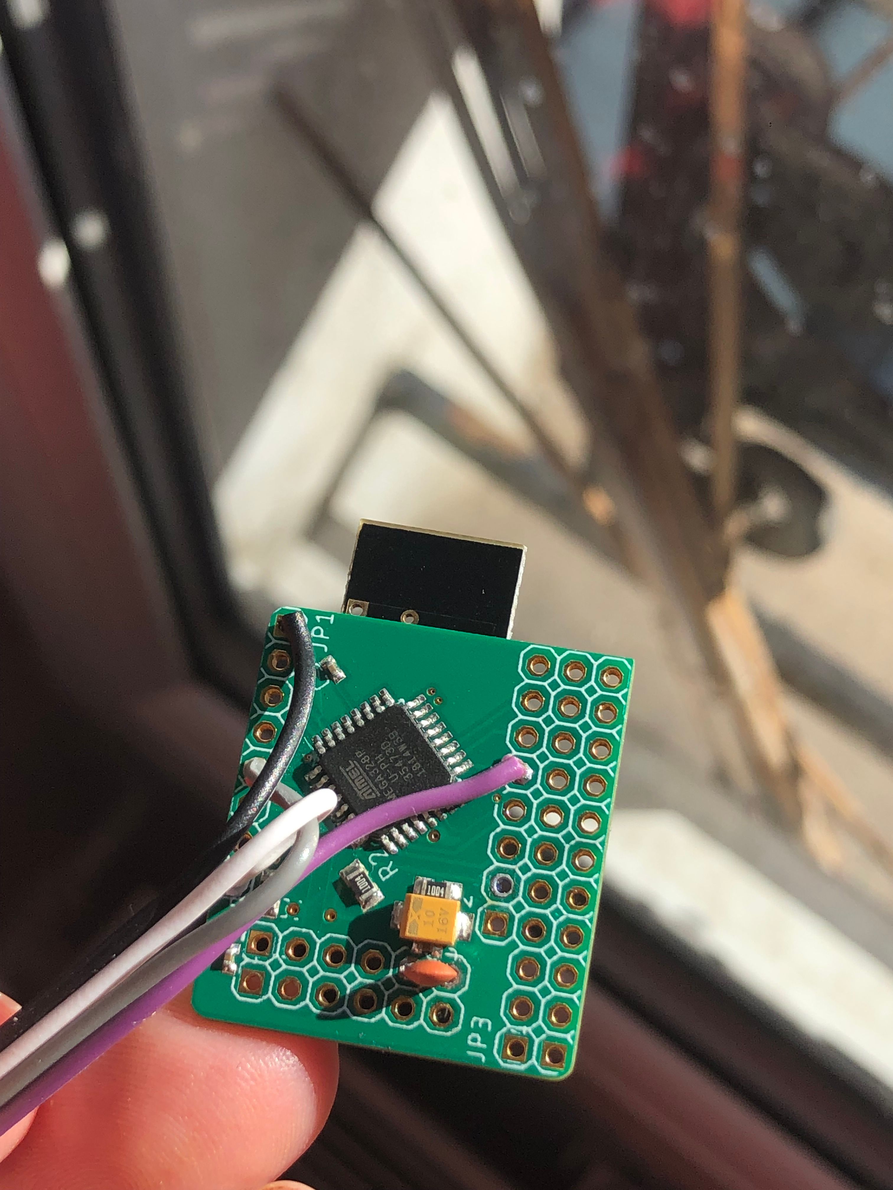

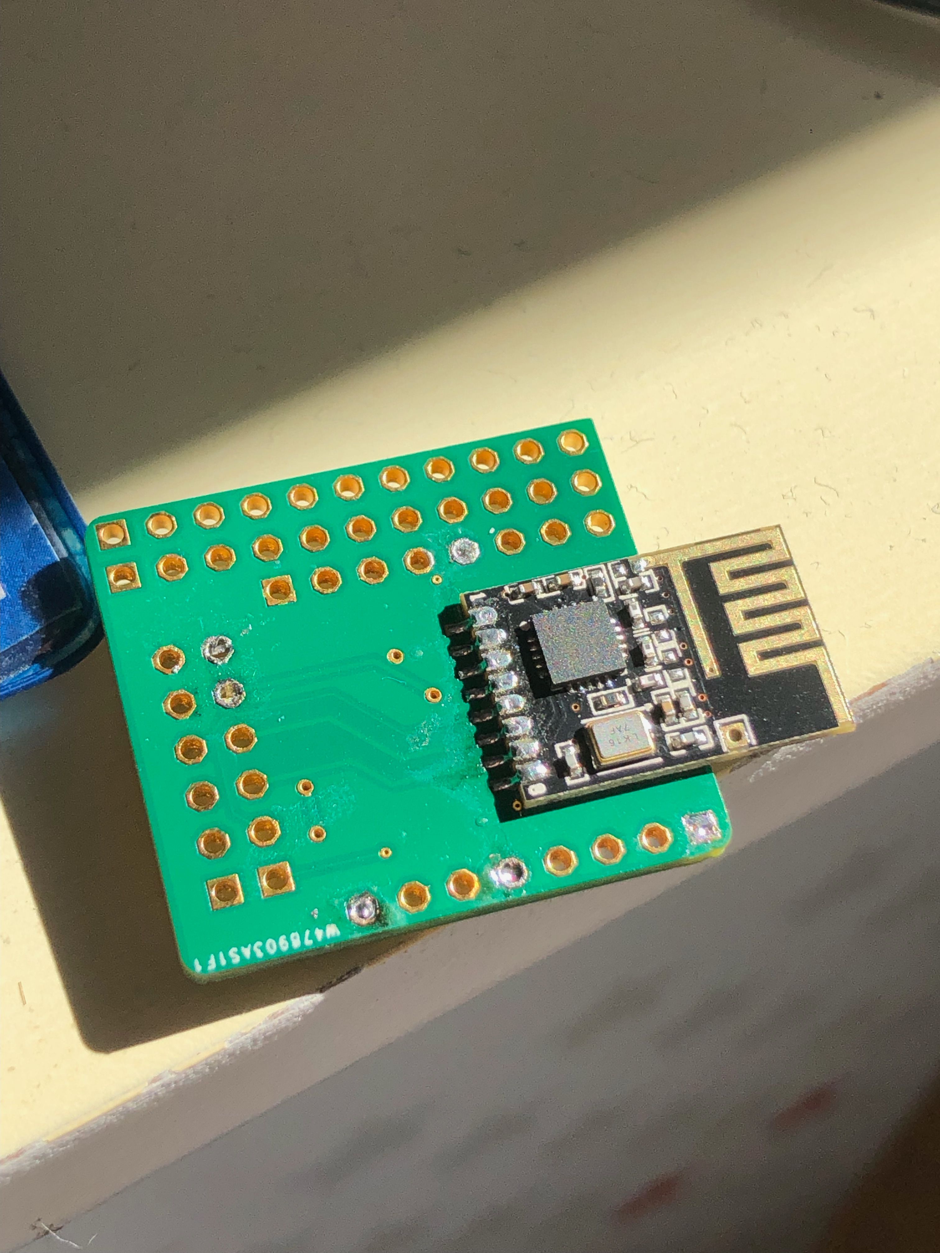

              @qqlapraline here are the pictures of my PCB. Front and Back.
              QQ.

                @qqlapraline I’m far from an expert, but it looks good to me. Clean and simple, not much that should be able to go wrong :-)
                Maybe the distance between the capacitor and the radio is a bit long (depending on how wide the traces are I guess).
                Maybe try to temporarily add another capacitor close to vcc and gnd on the radio, and see if it helps?
                qqlapralineQ 1 Reply Last reply

                  @mfalkvidd guess what…the capacity strikes again. I’ve soldered a 47uF right on the nrf24l01+ pins and…it works.
                  Would someone explain me the logic there ? The traces between the pins and the capacity were like 10mm long max.
                  Oh well.
                  Qq.

                        You are right, @NeverDie. Actually, my power supply is coming from a french power meter, that means a lot of noise - as I'm DC from a 50Khz AC :). So, I did two things. Adding a 330 pF capacitor at the entry point of my board and a 47µF right next to the NRF24.
                        Finally, I've upgrade my design to add a tantalium capacitor right next to the smd pads.
                        Global view:
                        Zooming the back with the polarized capacity (old fashion):
                        Front view:
                        New design:
