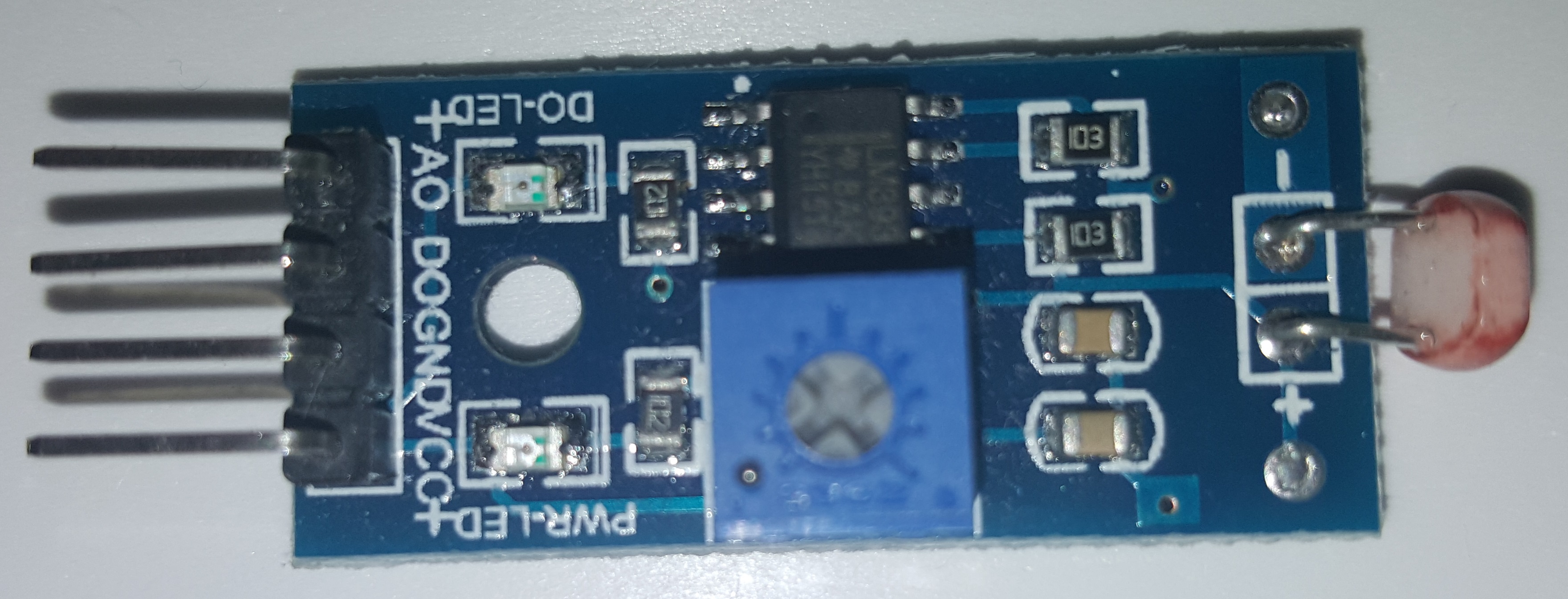

        @dbemowsk Hi and thanks for the sketch! I don't know if you still using this setup - I tried it and it works flawlessly. But (there is always a "but"), I am having problems lighting up the relay when light levels drop. My LDR sensor reports light the opposite it needs to be reported; meaning I get 100 when no light at all and 0 light level when I shine a light into the sensor (full light situation).
        Surely I resolved the relay firing up thing by changing
        if (lightLevel < 10 && motion && relay == RELAY_OFF)
        into
        if (lightLevel > 90 && motion && relay == RELAY_OFF)
        and the relay works, but I really love to use the right LDR Level on my Domoticz setup so a little help will be really appreciated.
        Is this something that my LDR sensor is faulty or is this something it could be resolved by modifying the sketch?
        Thanks in advance!

          @BeniK Your LDR sensor is most likely not faulty. To invert the values read by the sensor, all you need to do is reverse how it is wired to your reference power. There are two ways to wire these:
          0_1497440065614_upload-7672eea9-9cac-4ea6-8162-2ac8d9dc0876 0_1497440096381_upload-30441621-11c7-4020-9b9e-6c0d869e738c
          I am pretty sure that you have yours wired like the first one. To invert the values, switch your + and - on the LDR voltage divider. Basically, which ever way you have it wired, wire it the other way and my code should work.
          Here is a great page that explains using LDRs with an arduino. https://learn.adafruit.com/photocells/using-a-photocell

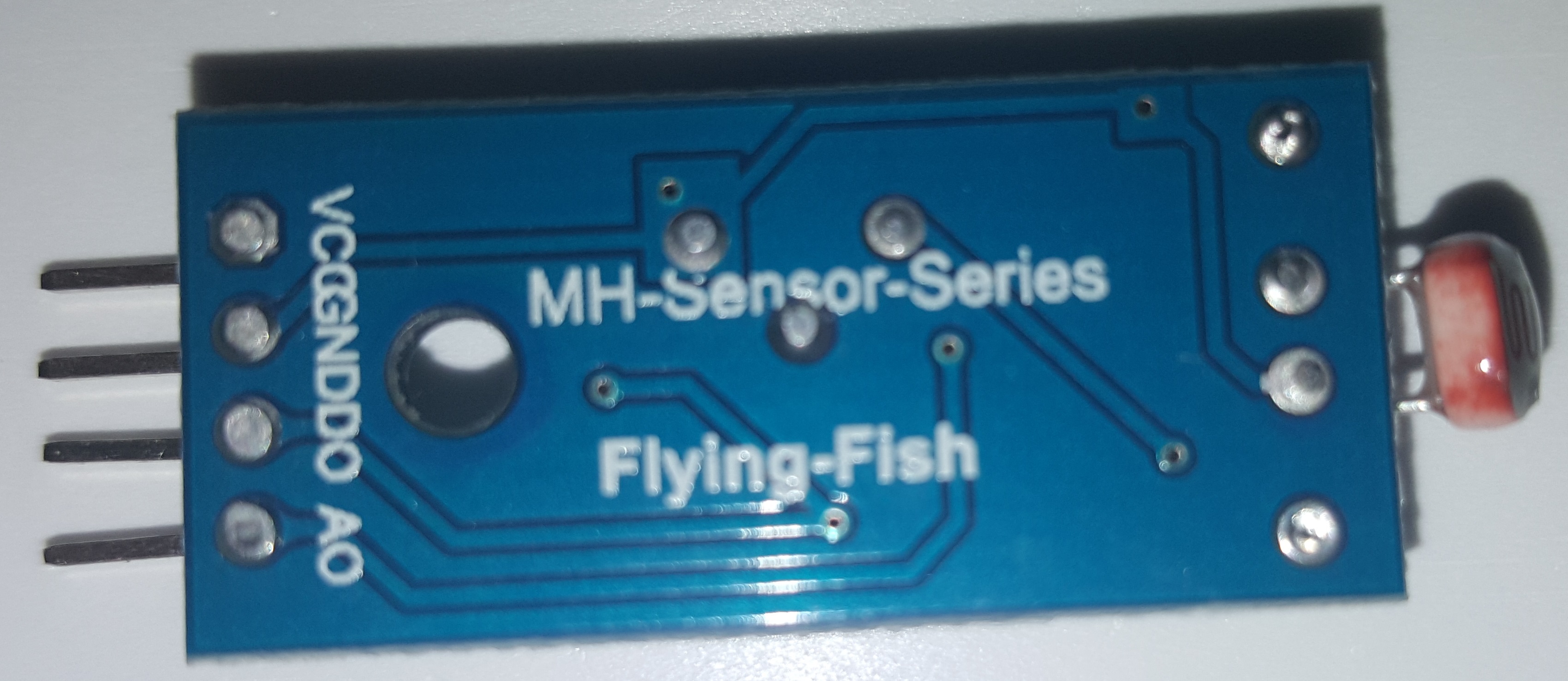

            Yhe sensor breakout board I am using is this one on the pictures. Is there any way to modify it or do I have to build my own LDR Sensor board? I so, what R1 value do you think is best?
            Thanks again!!

              @BeniK Try this simple code change:
              change this line:
              int16_t lightLevel = analogRead(LIGHT_LEVEL_PIN)/10.23;
              to this:
              int16_t lightLevel = 100-(analogRead(LIGHT_LEVEL_PIN)/10.23);
              I will explain this change so you can understand it. The analogRead analogRead(LIGHT_LEVEL_PIN) will return a value in the range of 0 to 1023. by dividing that by 10.23, that will give you a value from 0 to 100, the percentage of light. Because you are getting inverted values, subtracting the value read by 100 will invert it. So you could change the following line from 90 back to 10:
              if (lightLevel < 90 && motion && relay == RELAY_OFF) {
              if (lightLevel < 10 && motion && relay == RELAY_OFF) {
              because now that you are subtracting the value from 100, 100 - 90 = 10, and all should be good.
              Hope that makes sense.

                @dbemowsk Yes, it makes sense and it works flawlessly !
                Thank You very much!
