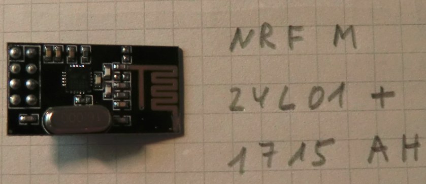

    I have two sets of nearly the same modules. The only visible difference is this number above. The modules with chip NRF M, 24L01, 1452AB work without problem. The modules with chip NRF M, 24L01, 1715AH did not. I tested 5 new modules from each series with the same node hardware and software.
    Here the protocol of the not working 1715AH:

    Hope someone can help. I saw a lot of topics concerning those modules on this forum but as a non-expert it is difficult to find the right answer.
    My non working module
      Usually it is most likely a bad Chinese clone. You can't do much about it, just get the genuine ones.

                  I'm sorry to reply to an old thread, I just wanted to let people know I have been able to get these 1715AH chips working using one of the cheap regulator boards designed for using with the NRF24L01+ and the RF24 Library from TMRH20.
                  I ran into this thread and almost returned the modules disappointed, but I decided to give it a try anyway and they worked for me. It's one of the only hits on google when searching for the model number so hopefully this post helps others.
