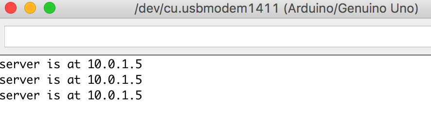

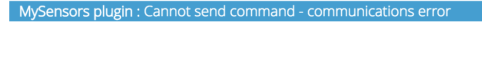

    but I am getting this nasty error after the Luup loads:
    the Serial debug from the gateway displays only this:
    anyone seen anything like this?

      I've tried removing and reloading the plugin, but no worky...
      Anyone have suggestions? I'm using the Arduino W5100 Arduino Shield...

        So, keeping with the communication with myself...
        I was able to properly connect the gateway switching some pins around, I guess that happened sometime in the last couple of major upgrades. The ethernet gateway (I was using for mire than two years( I'd assumed was wired properly.
        Gateway is now on v1.5, my Vera UI7 can see it with no communication issues.
