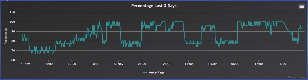

    I wanted to share my finding following my RFM69 signal scanner I previously built. I used 2 types of antennas:
    • Coil Spring from alixpress
    • Hand made like the one mentioned by @sundberg84 in [his project](https://www.openhardware.io/view/389/EasyNewbie-PCB-RFM69-HWW-edition-for-MySensors
    I let them run several hours reporting TX power since the new rfm69 driver adjusts power output to the default target RSSI of -80db
    0_1508679176407_upload-2f1bd39a-66be-4992-b5f2-12d14acbc24e
    The test was done on the same spot (my desk) and the gw about 5 meters away (1 floor difference, and a couple of walls in between; gw running the coil spring antenna).
    I am currently testing the SMA antennas and results are better than the hand made antenna with a TX power of 35/40% instead of 55/60%. My guess is the hand made antenna had to be squeezed inside the box getting a wrong orientation, while the SMA one is outside and it can stay perfectly vertical.

      @gohan interesting data. What is the percentage of? Lost packets? Success packets?
      Did you see what TX power they settled on?
        That is percentage of power of the RFM69 chip that I get using RFM69_getTxPowerPercent()

          How do you interpret the results ? Which one is better ?
            I'd say the wire antenna since it needs less power to achieve the same result
            S 1 Reply Last reply
              @gohan could it be because it's longer and easier catch the wave length compared to the coiled?
                Could be, I have to try the straight wire antenna for a better comparison. Either way they seem not that far away and depending on the node size I think the coil spring is still a good option.

                      @gohan A straight wire will always have greater actual gain than a coil even though a quarter wave electrically with minimal ground plane.
                      On your findings on commercial v DIY coils, they are unlikely to be designed for the same centre frequency, but also typical shrouded helicals tend to be manufactured with very thin wire. The larger wire diameter coil will (even at identical design centre frequency) exhibit a slower rate of mismatch (SWR) as you move away from the centre frequency.
                      Where the objective is to use minimal power consumption on a battery powered node, efficient antennae can have significant effect when transmit power can be reduced for the same effective radiated power with a dipole etc...

                        @zboblamont so basically if I make a 66cm long straight wire is the best antenna I can make?

                          @gohan In comparison with a coil, the straight version will always behave more efficiently, but is also easiest to make correctly...
                          The issue I suspect your experiment uncovered is matching the exact wire diameter, turns and spacing to radiate precisely at the target frequency. You may find both are labelled as 433MHz for instance, but one is tuned to 470, the other at 435.... The 435 will be less a mismatch to the transmitter, thereby more efficient...
                          It is all a trade-off between location and how much intrusion into the space the antenna will be. You could have a node 100m away using minimal power into a full wavelength loop antenna (1/4 wave each side) using a metal shed wall as a reflector, there it does not intrude, in your kitchen it would....
                            Actually the coil spring antenna work sufficiently well for my needs anyway, since it is compact while the half coiled half straight antenna it is harder to fit in a small box.
