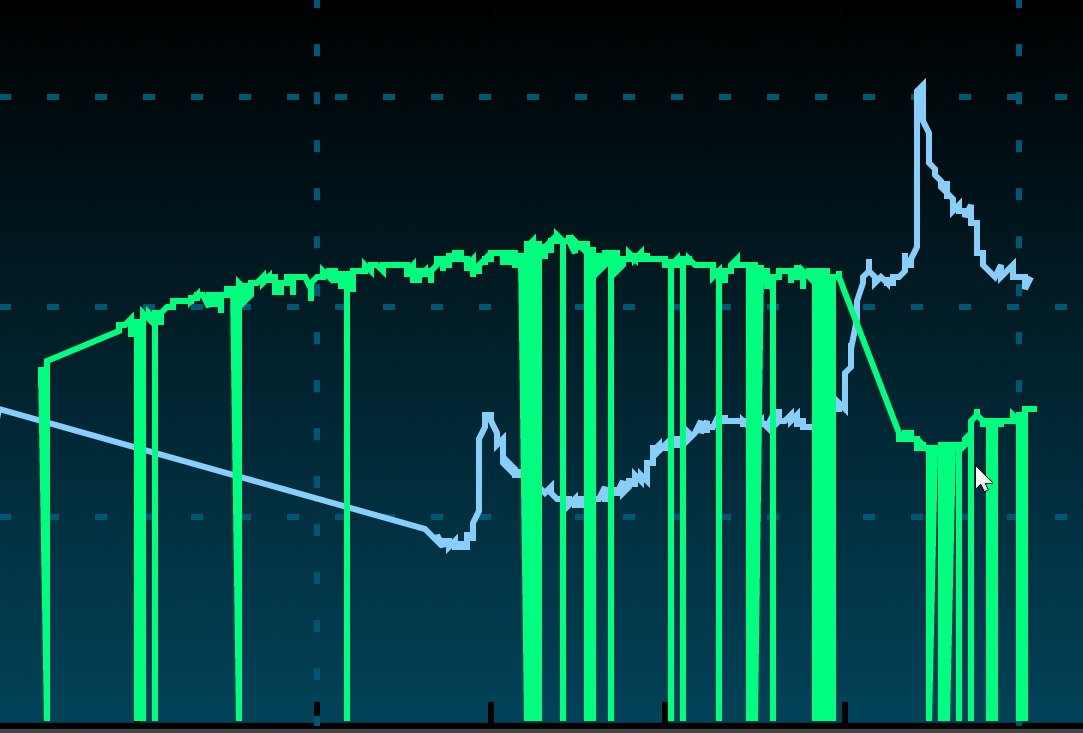

                          Ok, it seems that I found the cause of the problem: after changing the radio everything works as expected:
                          Here the green line with sporadic wrong values:
                          And here the result with a new radio:
                          --> SOLVED

                            Studying the log files of the night I found one damaged value
                            2017-11-04_23:02:43 MYSENSOR_BME680_R 33597 Ohm
                            2017-11-04_23:02:53 MYSENSOR_BME680_R 33760 Ohm
                            2017-11-04_23:03:04 MYSENSOR_BME680_R 33814 Ohm
                            2017-11-04_23:03:25 MYSENSOR_BME680_R 33705 Ohm
                            2017-11-04_23:03:25 MYSENSOR_BME680_R 2164818857 Ohm
                            2017-11-04_23:03:36 MYSENSOR_BME680_R 33814 Ohm
                            2017-11-04_23:03:46 MYSENSOR_BME680_R 33869 Ohm
                            2017-11-04_23:04:07 MYSENSOR_BME680_R 33624 Ohm
                            2017-11-04_23:04:49 MYSENSOR_BME680_R 33924 Ohm
                            Well, exchanging the radio improved the situation significantly, but unfortunately the problem might be still there....
