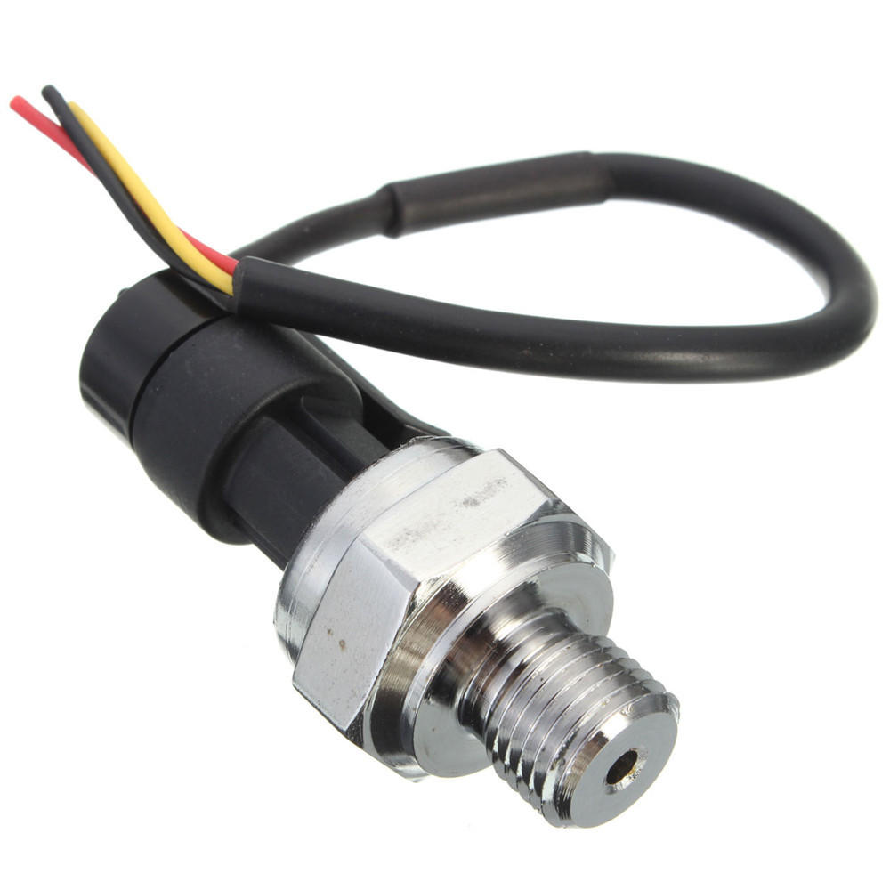

  • 1.2 MPa pressure transducer
    9 Posts
    S
    @zboblamont said in 1.2 MPa pressure transducer: In industry we used to use them atop valves to not only permit servicing but an air pocket acted as a buffer. Thanks, i'll try the pipe / buffer method and see if that helps. Will use a PVC pipe to rule out any EMC reaching the sensor.
