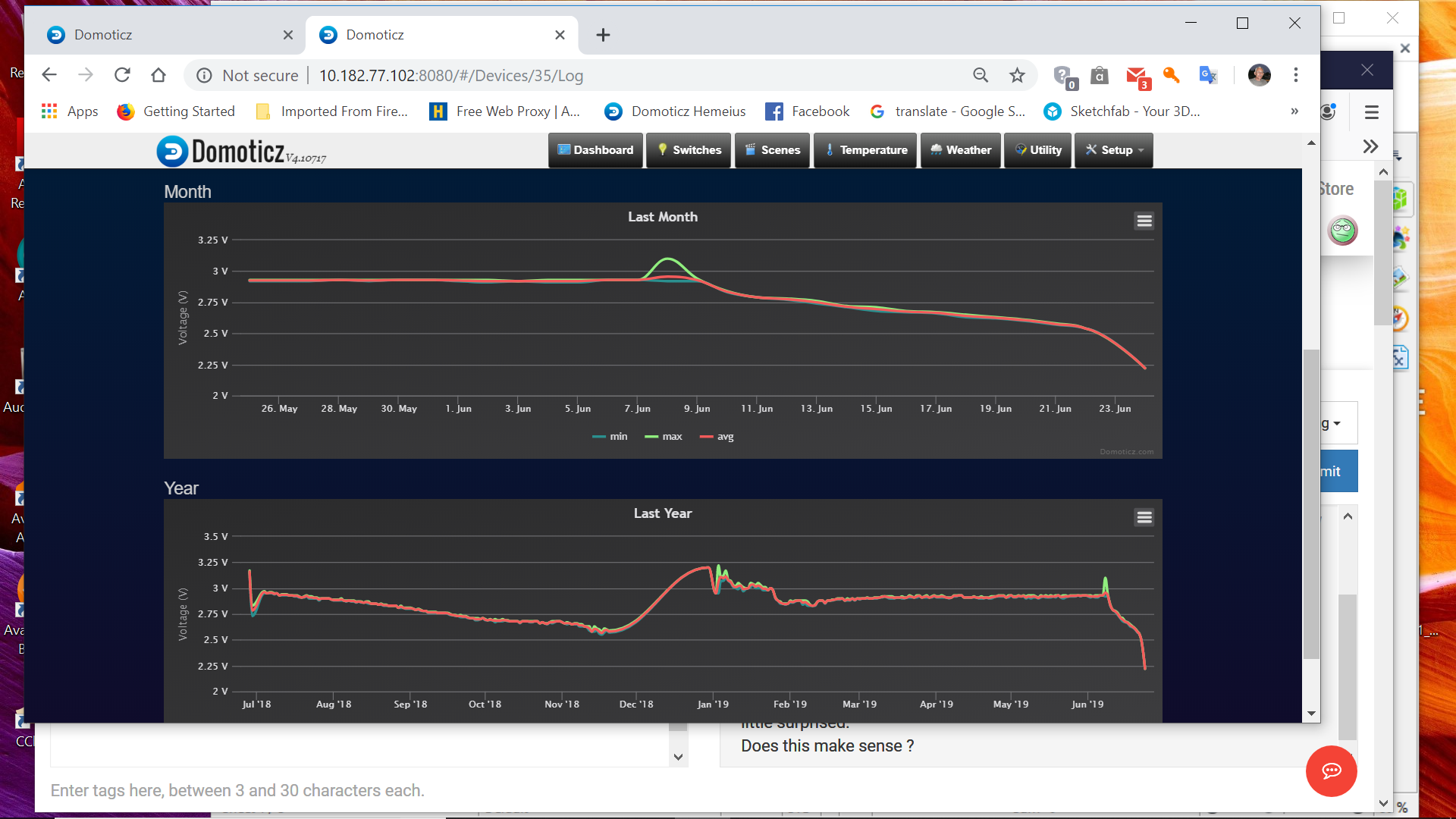

  • Power leakage puzzle - Solved embarassingly
    zboblamontZ
    Long story short, problem found to be the US running for 19 days continuously but couldn't tell as had detached the board's LED in an earlier itteration where power indication was from the booster. Fault was a detached Dupont connection for the latching relay reset, only discovered when probing found the relay was not off, and went to reset it by removing the Arduino pin connection to power it direct, ending up with the entire wire in my hand. Reconnected relay board and it felt tight, reset the relay then reconnected to the Arduino pin before the next due 12 hourly battery check, 1.76v recovered to 1.87 in 30 minutes and rising. Can only presume I disturbed the connection somehow, but kicking myself about removing the LED, and not thinking to listen for clicks from the relay as a check on Set/Reset.:flushed: Ho-hum, next a fresh pair of AA to start over again, well over a year is back in the frame again.
