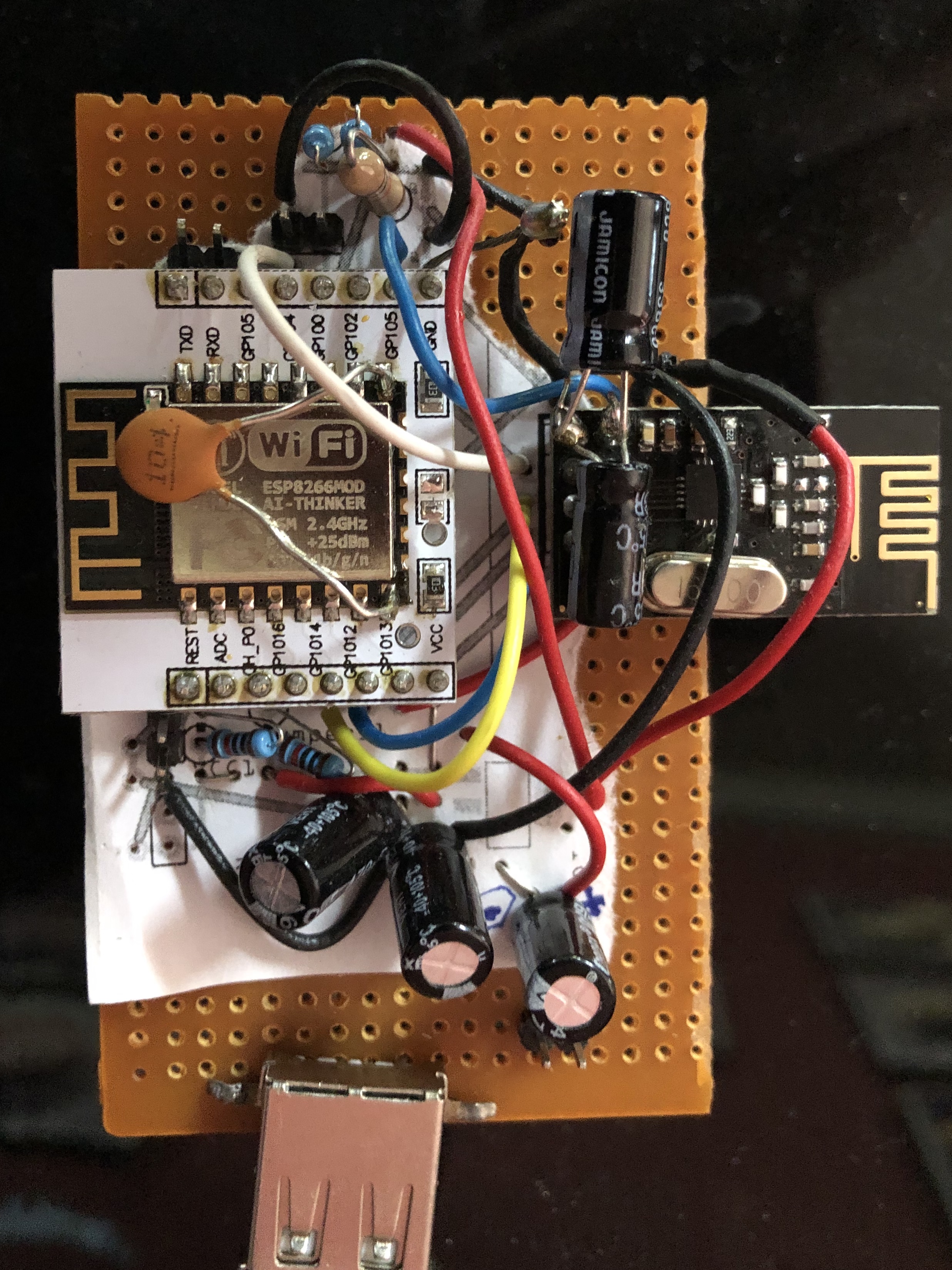

    Hi everybody,
    Having a weird issue with my WiFi gateway. My nodes get FPAR:NO REPLY consistently when they start up. If i use another gateway, they work immediately.
    If I switch gateways to the WiFi after the nodes have a parent and are asleep, it works fine. I had it run like that the whole weekend with no issues so I doubt it's a radio problem.
    Unfortunately when I built the gateway, I didn't have an 8pin DIL socket so I had to solder the radio in place, making testing out with another very difficult.
    I've tried with vesion 2.3.1 as well as the dev branch from github.
    Background
    This Gateway has been working for over a year with a temperature sensor node on a ATMEGA168 Seeduino arduino board. Both were running MySensors 2.1.1.
    I decided to replace the arduino with a dedicated board I made with a ATMEGA328 running at 8Mhz using the MYSBootloader.
    After soldering up the board, I loaded the sketch with MySensors 2.3.1 and tested with an Ethernet Gateway on my Arduino Duemilanove.
    When it worked fine for a couple of days, I upgraded the Wifi gateway to 2.3.1 as well.
    Original node connected to the Wifi gateway and ran fo another few days while I made a case for the new node.
    When I switched the nodes, the new one would not connect. Power cycled both but no dice. Both are located in awkward positions so I removed them, flased each with the Clear EEPROM sketch and reloaded firmware but still no connection.
    Also tried with a 16Mhz board with MYSBootloader because I didn't solder headers to the 8Mhz board for serial and it became a pain to pull the chip out to flash.
    My setup:
    Wifi Gateway:
    ESP8266 12-E with a NRF24L2401+
    5v power supply with a HT7833 on the ESP8266 with a 100 nF Bypass across VCC and Gnd.
    AMS1117 on the NRF24L01+ with a 4.7uF Electrolytical Bypass Cap (Added a 100uF as well in testing while trying to debug)
    DS18B20 Temperature Node
    ATMEGA328 with MYSBootlader @ 8Mhz internal powered with a 5v Regulated Wall Wart power supply.
    AMS1117 regulator for the NRF24L01+ with 47uF Bypass Capacitor.
    Second test node
    ATMEGA328 with MYSBootlader @ 16Mhz crystal oscillator powered with a 5v Regulated power bank.
    WIFI Gateway Sketch

    Wifi Gateway
    MCO:BGN:INIT GW,CP=RNNGE---,REL=255,VER=2.3.1
    109 TSF:LRT:OK
    125 TSM:INIT
    138 TSF:WUR:MS=0
    162 TSM:INIT:TSP OK
    183 TSM:INIT:GW MODE
    205 TSM:READY:ID=0,PAR=0,DIS=0
    237 MCO:REG:NOT NEEDED
    scandone
    350 TSM:READY:NWD REQ
    2626 TSF:MSG:SEND,0-0-255-255,s=255,c=3,t=20,pt=0,l=0,sg=0,ft=0,st=OK:
    2700 GWT:TPC:CONNECTING...
    3228 GWT:TPC:CONNECTING...
    3756 GWT:TPC:CONNECTING...
    4284 GWT:TPC:CONNECTING...
    4812 GWT:TPC:CONNECTING...
    5340 GWT:TPC:CONNECTING...
    scandone
    state: 0 -> 2 (b0)
    state: 2 -> 3 (0)
    state: 3 -> 5 (10)
    add 0
    aid 2
    cnt
    connected with wifi_ssid, channel 13
    dhcp client start...
    6965 GWT:TPC:CONNECTING...
    7493 GWT:TPC:CONNECTING...
    8021 GWT:TPC:CONNECTING...
    ip:192.168.1.15,mask:255.255.255.0,gw:192.168.1.1
    8549 GWT:TPC:CONNECTING...
    8577 GWT:TPC:IP=192.168.1.15
    8608 MCO:BGN:STP
    Ready
    IP address: 192.168.1.15
    8628 MCO:BGN:INIT OK,TSP=1
    8688 GWT:TPC:IP=192.168.1.15
    8719 GWT:RMQ:MQTT RECONNECT
    8761 GWT:RMQ:MQTT CONNECTED
    8791 GWT:TPS:TOPIC=sensors-out/0/255/0/0/18,MSG SENT
    8847 GWT:TPS:TOPIC=sensors-out/0/255/3/0/11,MSG SENT
    8903 GWT:TPS:TOPIC=sensors-out/0/255/3/0/12,MSG SENT
    pm open,type:2 0
    18609 TSF:MSG:READ,200-200-255,s=255,c=3,t=7,pt=0,l=0,sg=0:
    18671 TSF:MSG:BC
    18689 TSF:MSG:FPAR REQ,ID=200
    18721 TSF:PNG:SEND,TO=0
    18746 TSF:CKU:OK
    18764 TSF:MSG:GWL OK
    21385 !TSF:MSG:SEND,0-0-200-200,s=255,c=3,t=8,pt=1,l=1,sg=0,ft=0,st=NACK:0
    22703 TSF:MSG:READ,200-200-255,s=255,c=3,t=7,pt=0,l=0,sg=0:
    22766 TSF:MSG:BC
    22783 TSF:MSG:FPAR REQ,ID=200
    22815 TSF:CKU:OK,FCTRL
    22839 TSF:MSG:GWL OK
    25439 !TSF:MSG:SEND,0-0-200-200,s=255,c=3,t=8,pt=1,l=1,sg=0,ft=0,st=NACK:0
    52218 TSF:MSG:READ,200-200-255,s=255,c=3,t=7,pt=1,l=1,sg=0:119
    52284 TSF:MSG:BC
    52302 TSF:MSG:FPAR REQ,ID=200
    52333 TSF:PNG:SEND,TO=0
    52359 TSF:CKU:OK
    52376 TSF:MSG:GWL OK
    95174 !TSF:MSG:SEND,0-0-200-200,s=255,c=3,t=8,pt=1,l=1,sg=0,ft=0,st=NACK:0
    95947 TSF:MSG:READ,200-200-255,s=255,c=3,t=7,pt=0,l=0,sg=0:
    96010 TSF:MSG:BC
    96028 TSF:MSG:FPAR REQ,ID=200
    96059 TSF:CKU:OK,FCTRL
    96083 TSF:MSG:GWL OK
    313918 !TSF:MSG:SEND,0-0-200-200,s=255,c=3,t=8,pt=1,l=1,sg=0,ft=0,st=NACK:0
    313997 TSF:MSG:READ,10-10-255,s=255,c=3,t=7,pt=0,l=0,sg=0:
    314059 TSF:MSG:BC
    314078 TSF:MSG:FPAR REQ,ID=10
    314109 TSF:CKU:OK,FCTRL
    314134 TSF:MSG:GWL OK
    317217 !TSF:MSG:SEND,0-0-10-10,s=255,c=3,t=8,pt=1,l=1,sg=0,ft=0,st=NACK:0
    324923 TSF:MSG:READ,200-200-255,s=255,c=3,t=7,pt=0,l=0,sg=0:
    324987 TSF:MSG:BC
    325006 TSF:MSG:FPAR REQ,ID=200
    325039 TSF:PNG:SEND,TO=0
    325065 TSF:CKU:OK
    325084 TSF:MSG:GWL OK
    368945 !TSF:MSG:SEND,0-0-200-200,s=255,c=3,t=8,pt=1,l=1,sg=0,ft=0,st=NACK:0
    369025 TSF:MSG:READ,200-200-255,s=255,c=3,t=7,pt=1,l=1,sg=0:0
    369090 TSF:MSG:BC
    369109 TSF:MSG:FPAR REQ,ID=200
    369141 TSF:CKU:OK,FCTRL
    369166 TSF:MSG:GWL OK
    371985 !TSF:MSG:SEND,0-0-200-200,s=255,c=3,t=8,pt=1,l=1,sg=0,ft=0,st=NACK:0
    372065 TSF:MSG:READ,10-10-255,s=255,c=3,t=7,pt=0,l=0,sg=0:
    372127 TSF:MSG:BC
    372145 TSF:MSG:FPAR REQ,ID=10
    372177 TSF:CKU:OK,FCTRL
    372202 TSF:MSG:GWL OK

    • M mcchots
      Hi everybody,
      Background
      My setup:
      Wifi Gateway:
      Second test node

        This is a picture of my gateway. Since replacing the radio is so difficult, I'll probably have to build a new one. Too bad i damaged my backup ESP while trying to debug this on a breadboard.
        Any recommendations on placement of the two modules?
          @mcchots the placement looks good, the nrf antenna is sticking out so interference by the perfboard should be small.

            @mfalkvidd Turns out I didn't completely destroy my second ESP8266.
            Breadboarded a new gateway and it works fine. So I guess the radio is shot.
            Busy working up a much neater PCB with replaceable components to etch.
            Thanks for your help.
