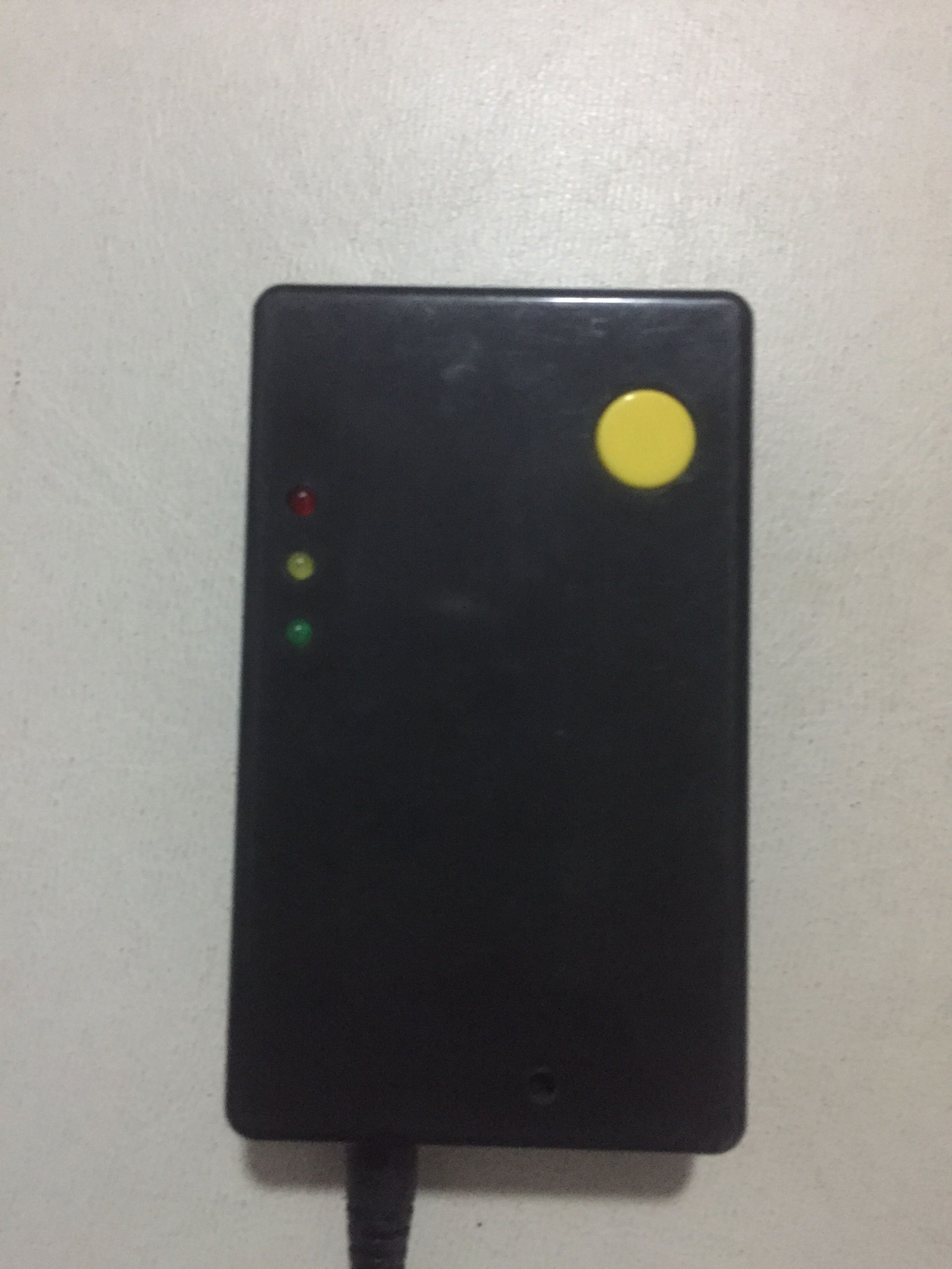

                                    @pw44 and so, my first assbled gateway looks like:
                                    Now i will try a more robust version, with external antenna.
