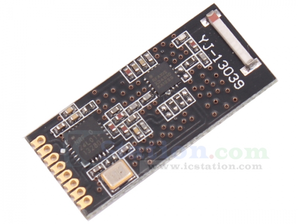

      Interesting. Did you look at getting the board for the PA+LNA SMD version? I am talking about this one:
      http://www.icstation.com/images/big/productimages/3723/3723.JPG

          @emc2
          I have this larger radio in house. It needs around 160-220mA in peak power during transmission, so we can not use the 3V3 pin on the gpio header (they can source only 40mA max).
          I have not gotten around to do a board for this larger radio, but if you have then I'm interested in the .brd file or the boardname if available on OSHPark.

            @GertSanders @emc2 That's right. I have my PA+LNA version running from 5V via AMS1117. I have not looked up the power consumption for the SMD version though, but think this is going to be considerable and cannot use 3.3V pin.

              @GertSanders I saw 45mA peak current on the aliexpress description, I knew it would be off, but I was not expecting to be 10x off. So sad when we can't even trust the descriptions on the "datasheets" ;)
              I use Kicad so no .bdr file sorry. I sent you the OSHPark link via a private chat.
